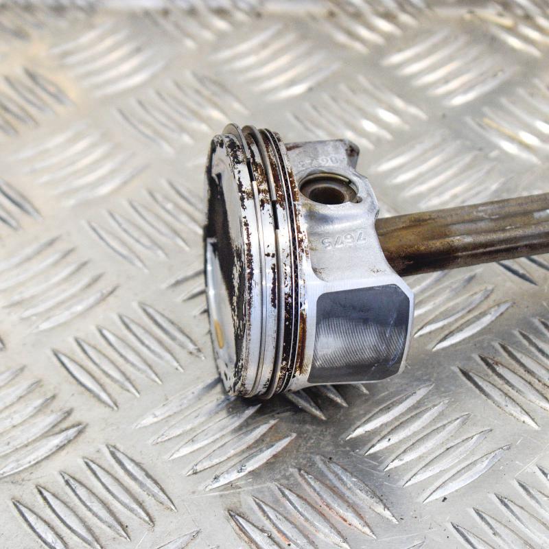

I have found an image of a very worn 1.4 16v BXW Toca type piston on the web. Note how the black teflon skirt patch is worn right through. I bet this one
will slap a treat !
will slap a treat !

I notice my Ibiza 1.0 3 cylinder 95hp ecotsi engine has very similar pistons! now I've got something else to worry about? I was also reflecting on how modern pistons look. Very short skirt lengths and heavily cut away around the small ends, compared to, say, a piston from an "old" BMC "A" series. Look more like I would expect a piston from an engine built for racing would look? OK, I know, reduced weight, reduced friction, etc, but also maybe, reduced life?
I completely agree with you. I just looked online at some images of old Toyota Carina pistons because those cars could do mileages likes NCC 1701 the starship Enterprise. The Toyota pistons were deep skirted and completely full round skirted with no low friction patches.
I also used to do work on 1990's Hinckley Triumph Triples and those pistons had a ring of oil distribution holes below the oil control ring to distribute oil from within the piston cavity onto the nitrided bores. These bike in the hands of couriers were known to do upwards of a quarter of a million miles.
