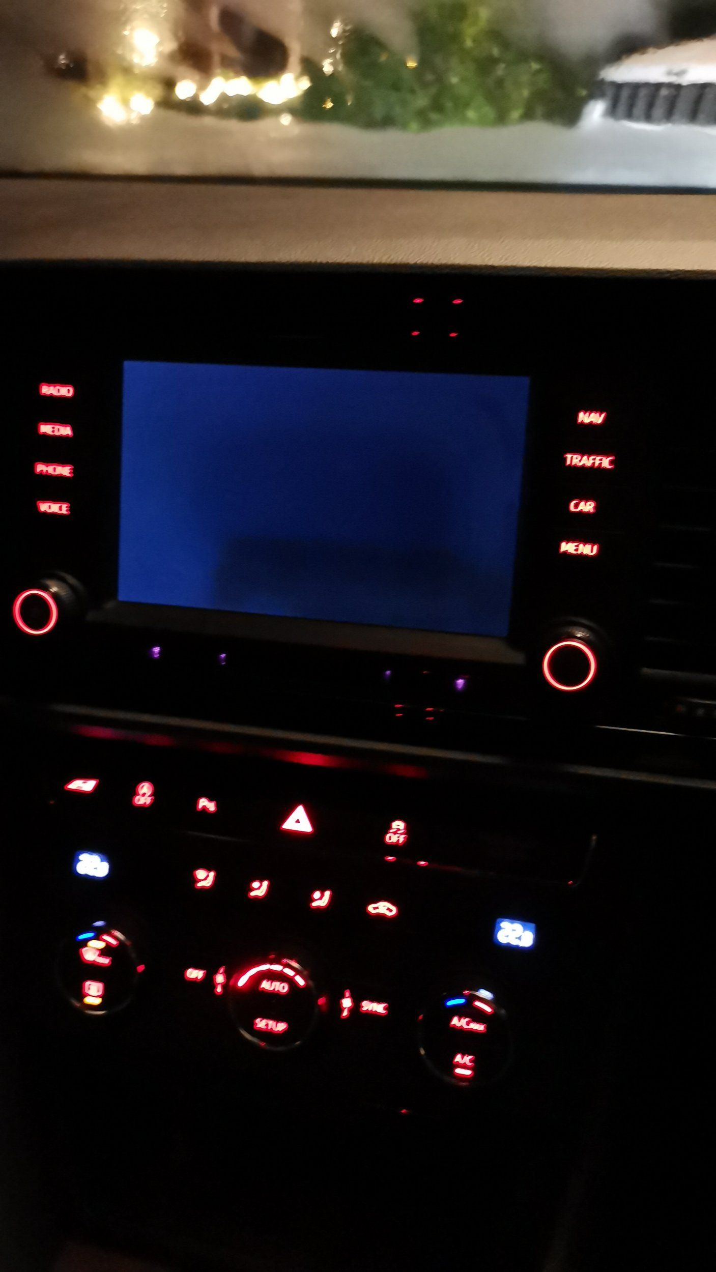

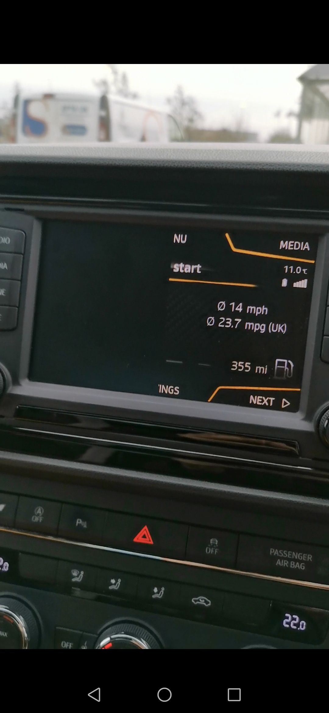

Hello, anyone had an issue with their touch screen going blank? My 66 plate Leon cupra 290 screen started flickering a couple days ago, half the screen then went blank and the following day the whole screen has gone. I've checked fuses and everything still functions on it, I can still play radio the radio the music through my phone. Anyone had this before and found a fix or will I just need to replace it?

The screens can sometimes be temperamental in the cold.
Have you tried a soft reboot?
Press and hold the power button for 30 seconds - release when the boot up screen appears.

Contact Kieran Walkington at eastyorkshireretrofits.co.uk I'm sure he does replacement LCD's rather than change the whole screen unit.
