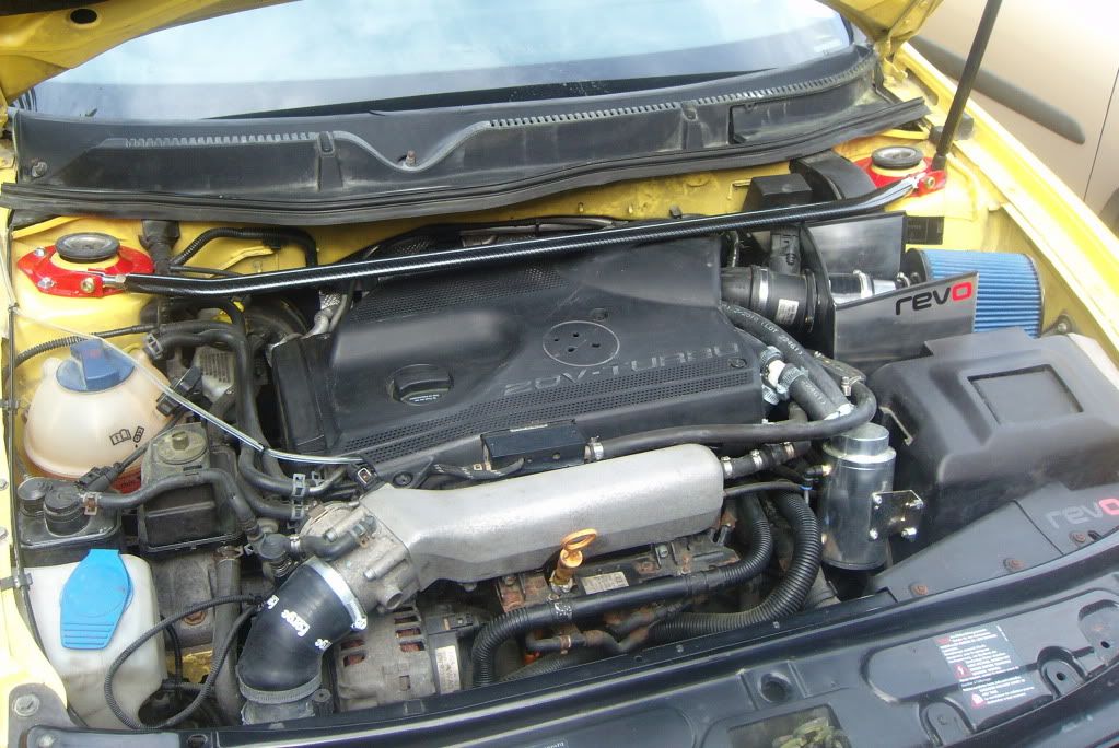

hi guys i'm thinking strongly about fitting a bigger single pass fmic intercooler on my , i currently have a radtec fmic with ports on the same side but i dont see how can run single pass intercooler with all the pipework in my bay and the the strut brace in place
pic of the bay
is it possible to run the pipework under the car ?

i wouldnt run it under the car youll smash the fuk out of it lol

get a LCR/S3 manifold...
and run the pipes from the pancake pipe to the FMIC on the driver side, then on the passenger side from the FMIC up in front of the battery and to the LCR manifold.

will have get the holes in the manifold re-drilled for gas nozzles if i get s3 intake manifold , think i'm gonna have to make this intercooler set up work ,
Pyro
Or relocate the catchthank and just have a normal one ;) lol you'll get it under the strut brace I've done it myself on johns car with the Toyo kit ;)

what about the ibiza 1,8T pipework, the route is from the turbo over the engine and down at the battery, could this be made to fit the leon maybe?
