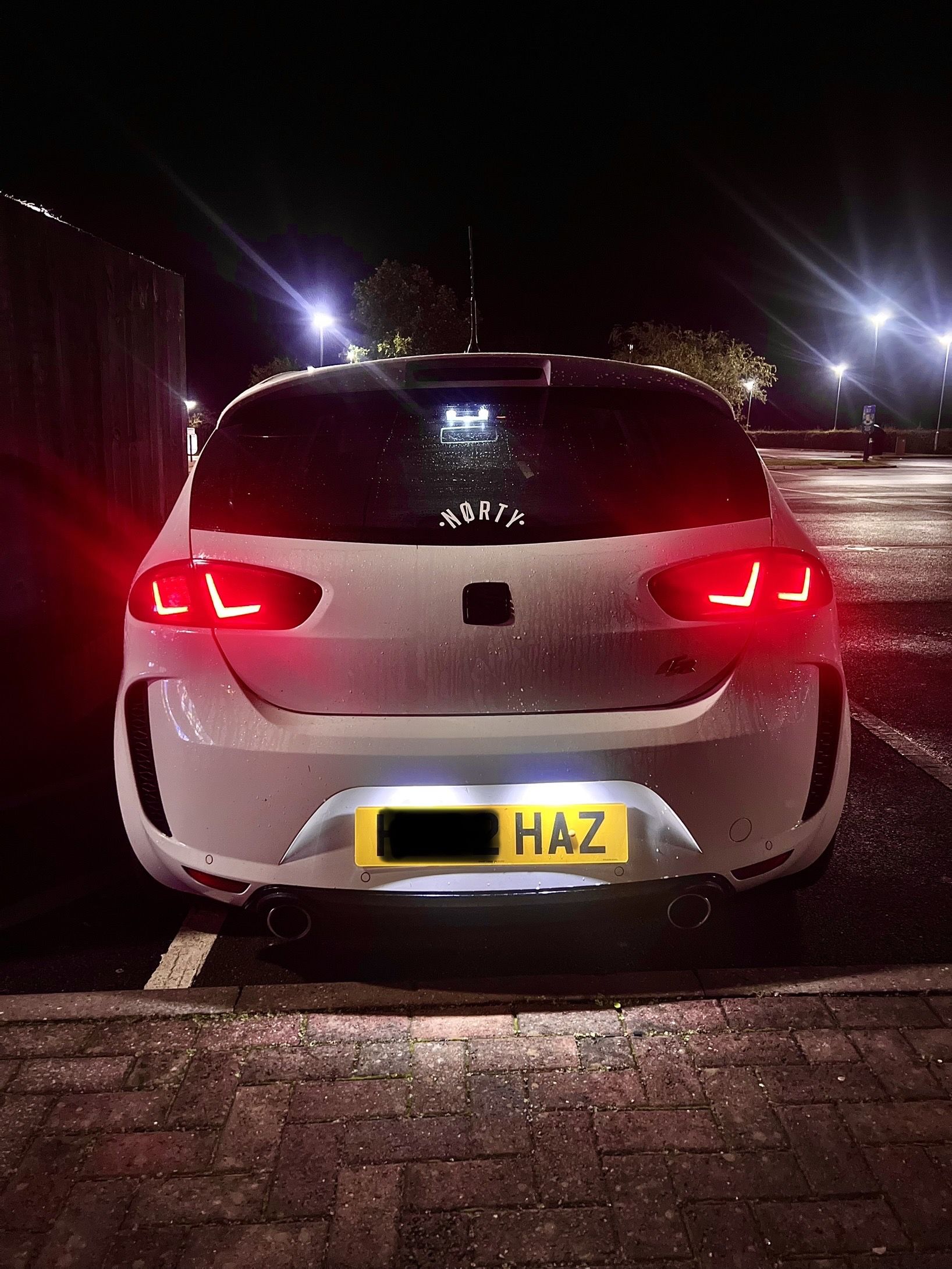

pic of my car below :)

If anyone has and idea where glow plug relay is located on this that would be helpful to,
Seat Leon supercopa mk2 is 2.0 TDI
