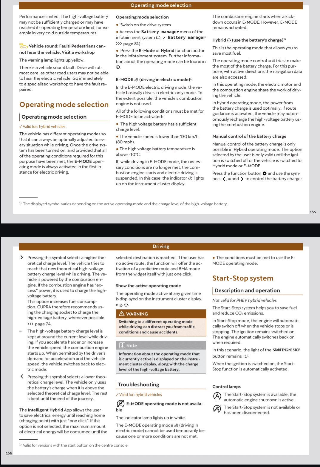

- I know I would need to charge it at home to run in EV mode but what happens when the battery goes flat? Does it behave like a 'normal' hybrid with it being recharged by coasting and braking?
