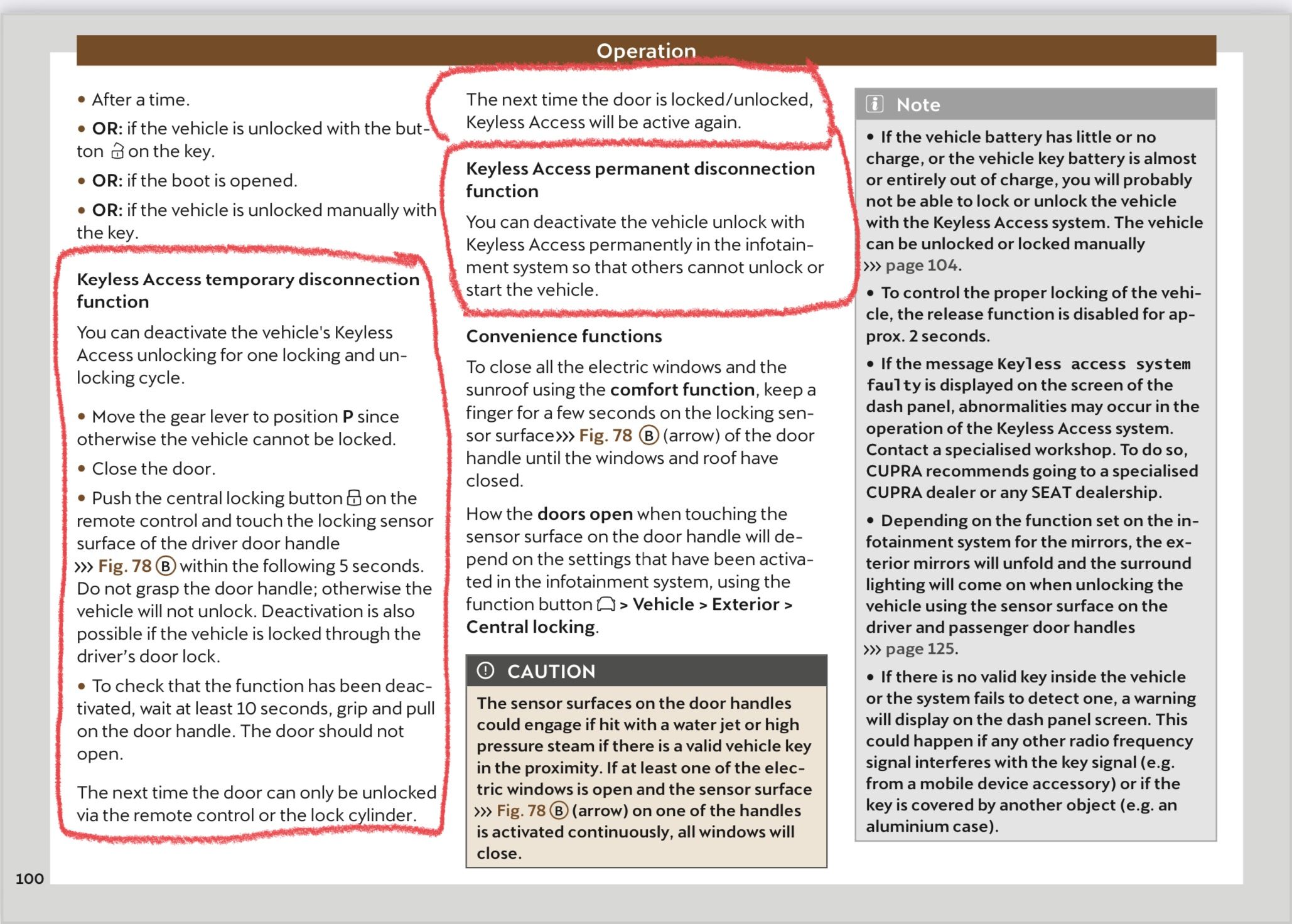

According to the Cupra Born owner’s manual, it’s possible to permanently disable keyless entry in the vehicle settings - accessed via the infotainment screen - and that might be how your car’s been initially set up.
Screenshot below from the Aug 2021 Owner’s Manual;

Sometimes the technical writer of Seat manuals writes function that aren't there. 🙄
It may very well be burried down a menu option that you haven't found yet. Formentors had an early issue where both sides went into sleep mode after a time.
Your dealer should have shown you around so it was working when you left.

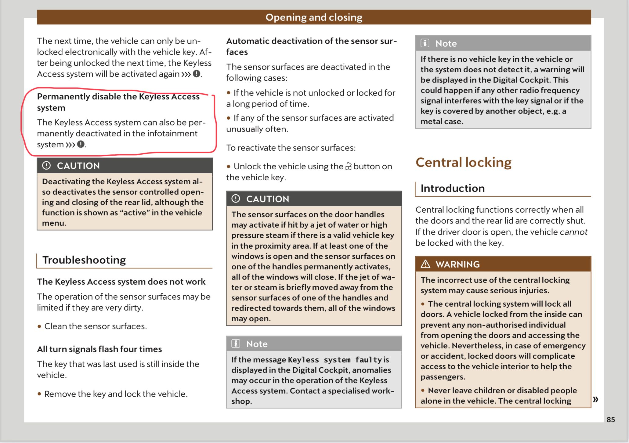

Agree on Kessy (keyless entry / start) being a rather pointless feature (IMHO of course; there’ll be some owners who like it). My VW has keyless entry / start; it was part of the standard spec - if it hadn’t been, I would never have paid extra to have this feature.
It should be possible to either temporarily or permanently disable keyless entry function on your Formentor - screenshot below is from the June 2021 edition of the Formentor owner’s manual. I can’t permanently disable keyless entry on my VW but I can temporarily disable it each time I lock the car, which I always do.

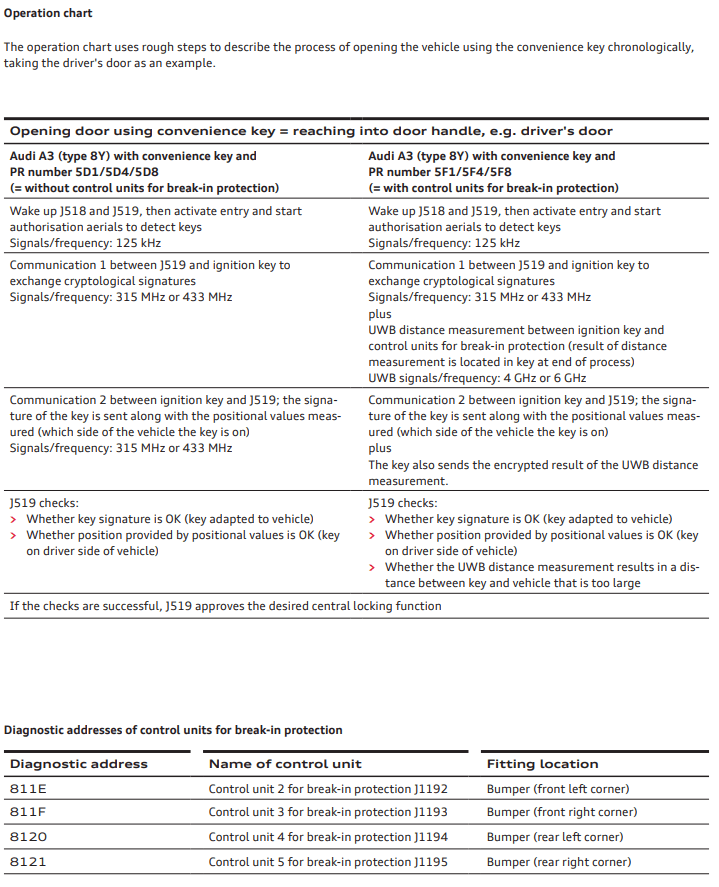

The new cars have technology to prevent relay theft.. you're wasting your time with a Faraday pouch. (The technology works).
The cars have 4 additional receivers as subsystems on the body control module which monitor the true distance between the vehicle key and the vehicle (atleast in the UK, not all markets have this)
Ah thanks, do you know from which model year that was introduced please? Mine is a 72 plate, so either a 2022 or poss a 2023 MY.
Since launch on all MQBevo vehicles with KESSY (for the UK, unsure on other markets.)
This is taken from the Self Study programme for the A3 8Y but it's applicable to the other brands.
The system measures the distance between the ignition key and the vehicle. This is done by measuring the time a signal takes to travel in the gigahertz frequency.
. The function “Open with convenience key” is only possible and permitted within a defined distance. There is no communication between the key and the vehicle outside the defined area. The technology is called RSAD UWB. This stands for Relay Station Attack Detection via Ultra Wide Band.
At Audi, RSAD modules are referred to as “control units for break-in protection”. These are control units 2 - 5 for break-in protection (J1192 - J1195). They send UWB signals. The distance between the sender and the receiver is determined using the signal travel time and stored in the ignition key.
Put simply, the system measures the time between sending the signal and receiving the response. The time measured is referred to as the time of flight (ToF). If the time measured (a few nanoseconds) is multiplied by the propagation velocity of the radio waves (almost the speed of light), the result is the distance between the vehicle and the key, correct to within a few centimetre

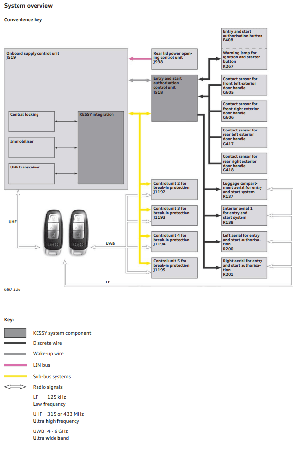

The onboard supply control unit J519 is the central locking system master on the Audi A3 (type 8Y) The entire control system for the central locking functions (including the RSAD control system) is located in the onboard supply control unit.
The entry and start authorisation control unit J518 communicates both with the onboard supply control unit J519 and the four control units for break-in protection J1192 - J1195 via a sub CAN.
J518 also performs the usual tasks:
> Reading in the signals from the capacitive sensors in the door handles
> Activating the entry and start authorisation aerials
> Wake function for the onboard supply control unit J519 via a discrete wire
> Activating the warning lamp for ignition and starter button K267
> Reading in the button signals from entry and start authorisation button E408
The electronics for the UWB technology are only present in the ignition key of vehicles with PR numbers 5F1, 5F4 or 5F8.
However, the UWB distance measurement is not automatically used on these vehicles in all cases. If a vehicle is simply locked with the remote control, no UWB query is made.
On vehicles with UWB distance measurement, the central locking system sends signals in the following frequency ranges:
> If the vehicle is locked or unlocked via the remote control, the key sends its signal in the UHF frequency at either 315 MHz or 433 MHz, depending on the vehicle and country.
> If the central locking system is operated using the convenience key functions, the four aerials (R137, R138, R200, R201) communicate at a frequency of 125 kHz.
> The communication between the four control units for break-in protection and the ignition key takes place in the UWB frequency at either 4 GHz or 6 GHz (frequencies depend on the country).
