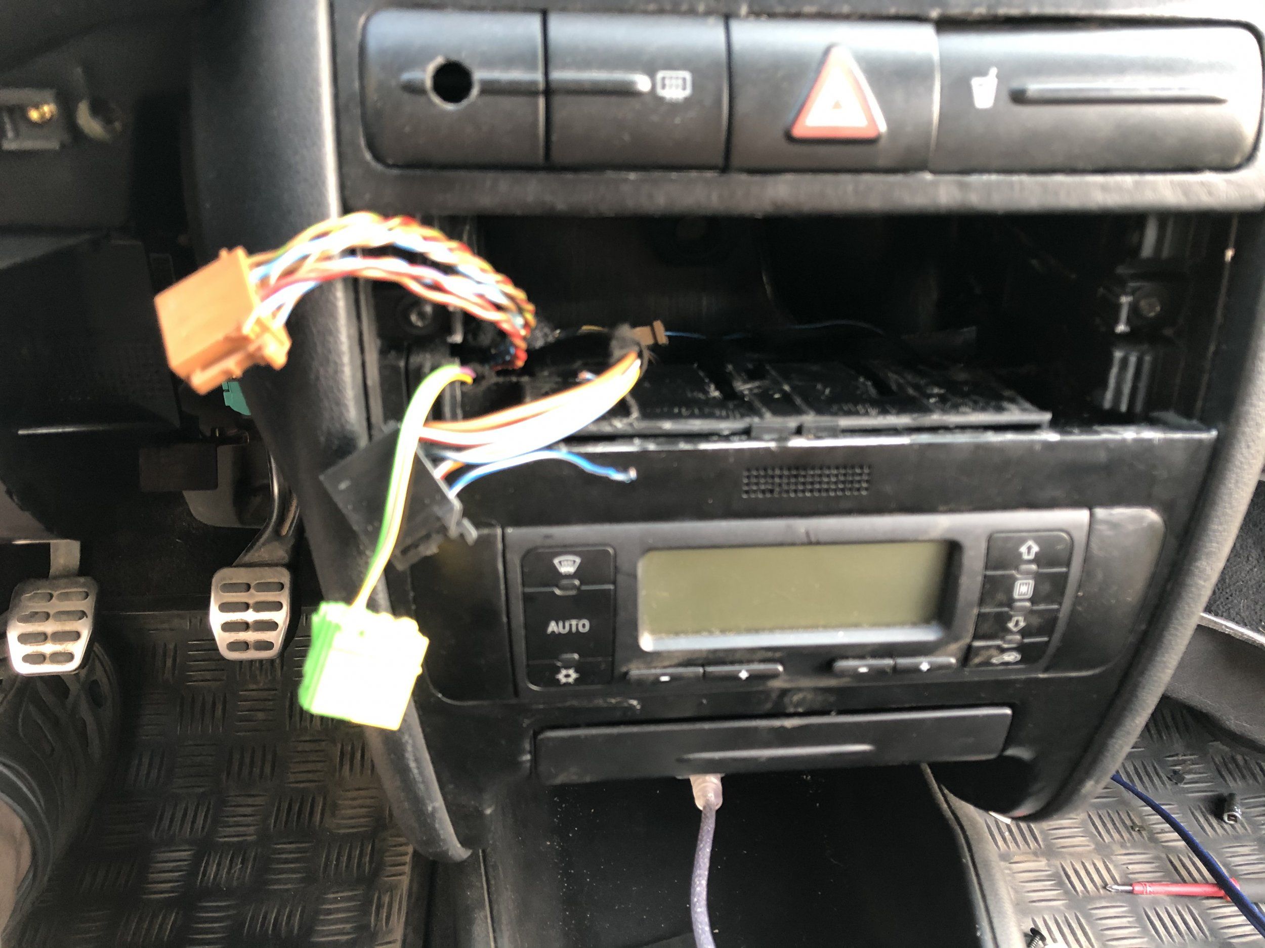

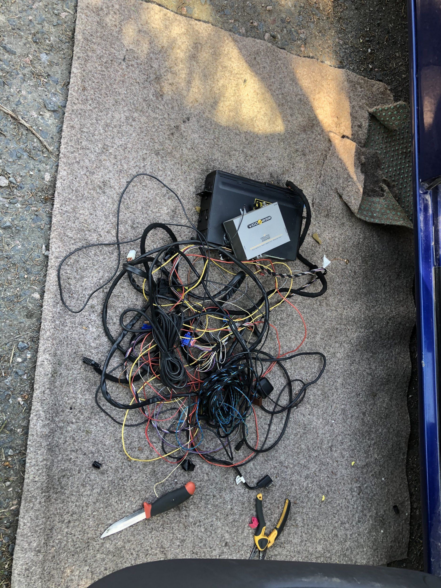

Tryed to get connected to Ecu with MPPS, message Ecu not found comes repeteadly, I rewired K-Line straight from OBD to Ecu, no help, but after that, car runs only one second if ISO connector is connected to radio?? I think all extra cables from Dashboard are now disabled and only OEM cables are left
There was some extra, OEM cd changer, navigation box, GPS antenna, etc..

Ok, I think there's something wrong with car electronics, I programmed my previous toledo with AUQ engine at same cable and there were no difficulties...
Offcourse it's possible my programming cable is broke, maybe I'll get another cable from my friend and try again...
