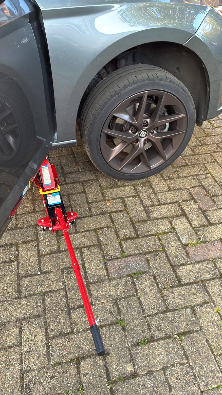

  • Tyres - This is what I'm suspecting most at this point. My tyres are absolutely fine tread-wise (4mm left) but I did notice some wear on the edges, both sides, moreso than the middle. Tyre pressures are correct and alignment was done last year. (Attached is a picture where someone pointed out they look a bit worn on the edges)

When you also experience it with slowness, then I would also disregard the shock theory. KYB should be decent stuff.
