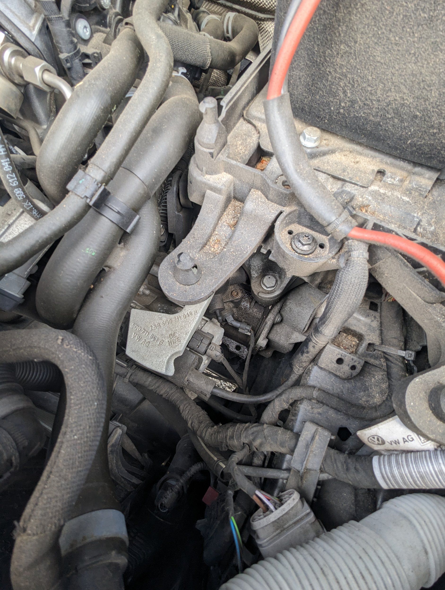

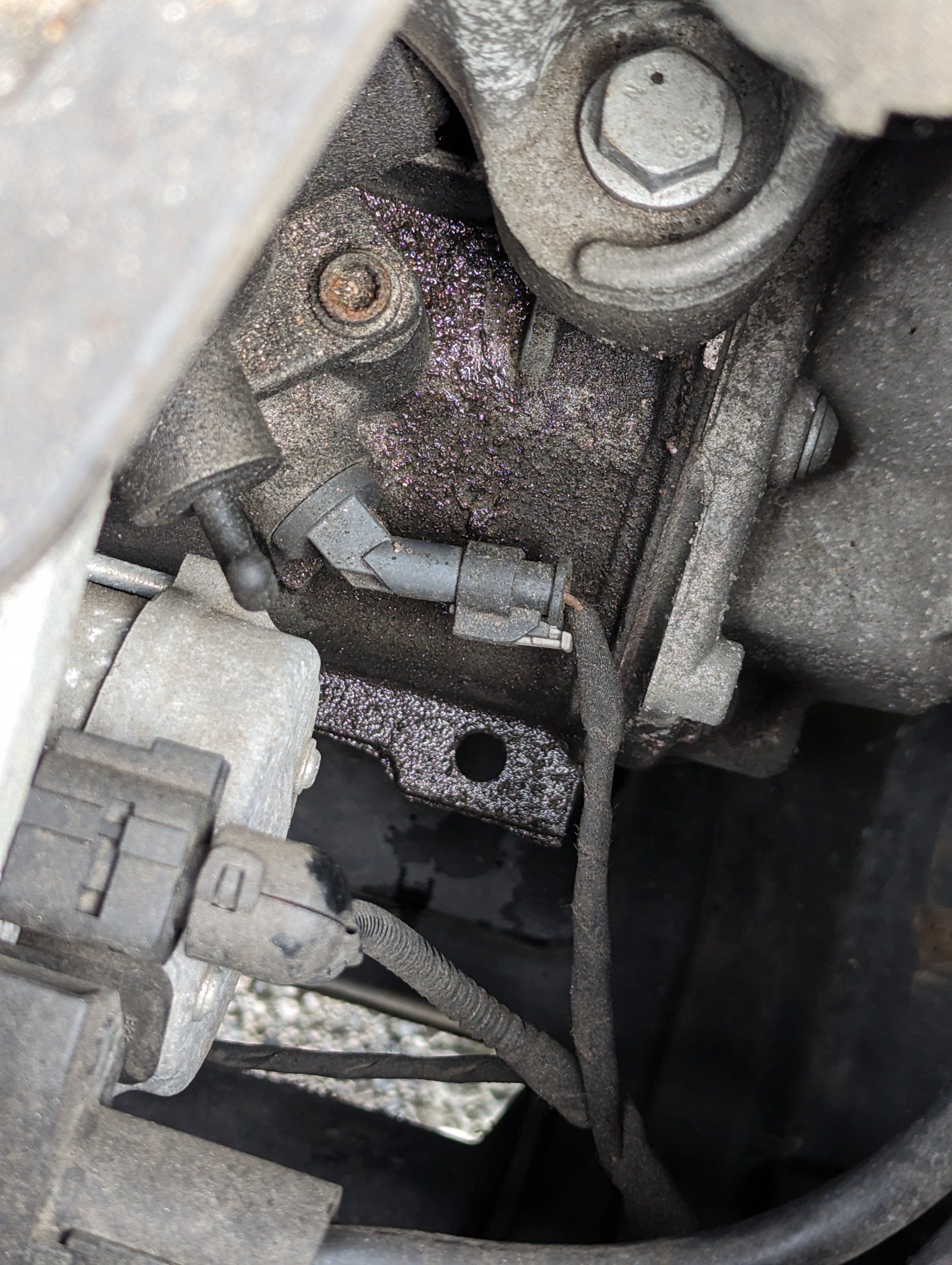

On further inspection this morning it looks like there appears to be fresh liquid on top of the gearbox. I've attached photos, is anyone able to pinpoint where this could be coming from?

Hi!
That's from the thermostat housing that I posted in the previous video. You can see the coolant sitting on the gearbox at the beginning of this video.
Here's another video:
usually that means that the thermostat housing itself has overheated and warped and is allowing coolant to drip on to the gearbox.
the only way to fix it would be changing the system (housing, pump, and belt).
you can continue to refill, but if the housing is warped or the seal is bad, it will simply continue to leak until complete failure.

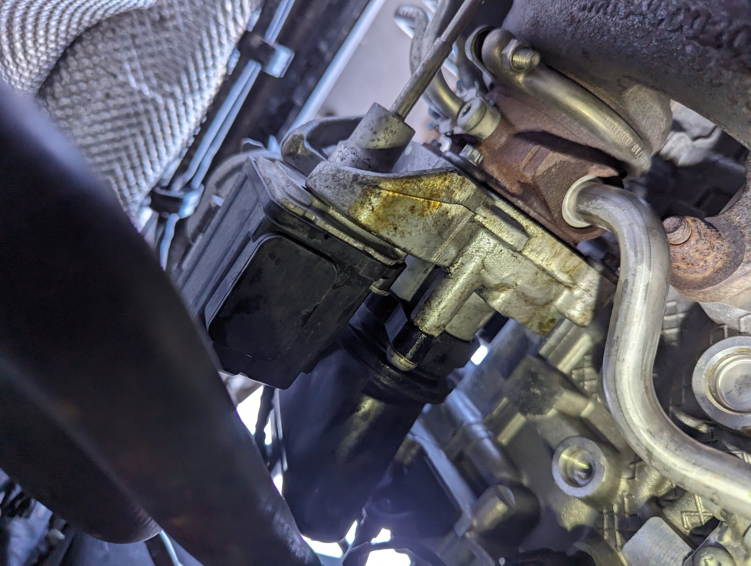

I've managed to get it jacked up today and it looks to be the turbo, oil and coolant leak.
Is this a common issues, does anyone have a rough idea of cost on this job - I imagine a good proportion will be labour?
