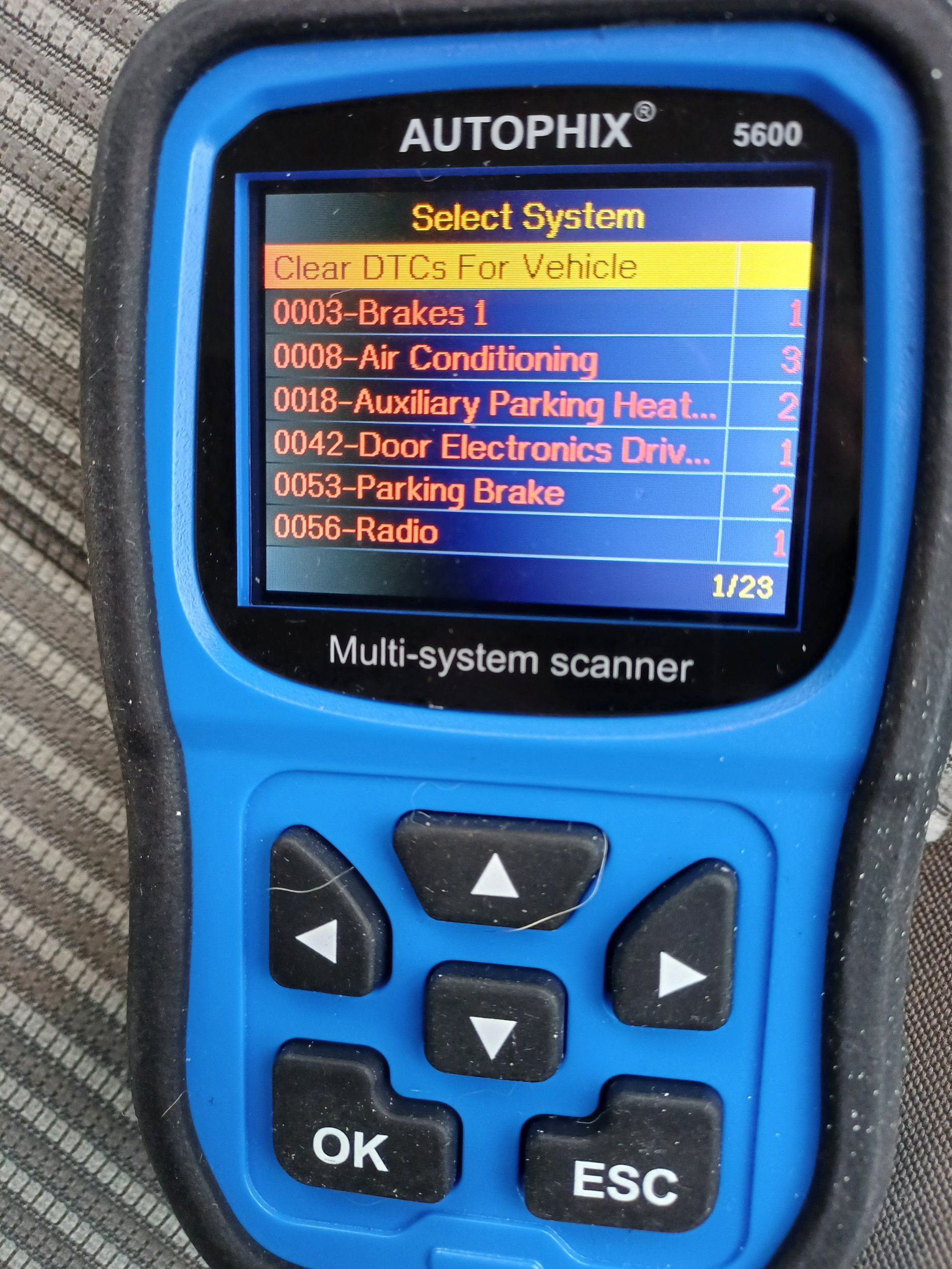

Now I have another brake problem the automatic electro mechanical parking brake has stopped working, The manual handbrake switch still works. If it is the control module can I replace it with a refurbished unit, or does it need a dealer to reprogram it?
