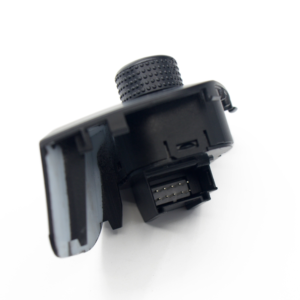

Is it possible to replace only the plastic? I mean the switch is good, but the plastic around is broken.
How to I separate the round thing from the rest to replace only the plastic around?
14 on this image:
The whole switch is like this, it looks like it can be separated but I don't know how:

That looks black too me but could be wrong
I guess there is black and carbon black, don't know wich is the diference :(
Is the carbon black for the cupra or something like that?
anyone who changed can tell wich part number used?
dm222, I have not tried this - yet, but if you look at the picture you posted, you can see that the switch is retained in the trim adaptor using "lugs" - well one "lug" is visible on that picture, if you gently ease that lug "out" slightly - and any other "lugs" you can see, I'd expect that you could push the switch back through the trim adaptor.

I removed mine today, tried to open to see if it's possible to replace only the plastic but it's not, once I opened everything inside desmantled, very small pieces, so I will replace the whole thing. The part number is 6J1 959 565
