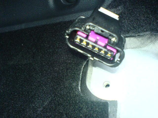

if they are the mk5 oem ones then yes they will fit, there is a vw vortex page on the how too's showing how to do it, but basically the brake & clutch are rubber gromets that push in the centre then fold the sides over to fit in. the acc pedal is just a plug in job but takes a bit to remove it,and be carefull with it.

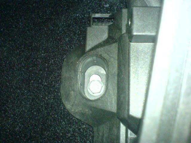

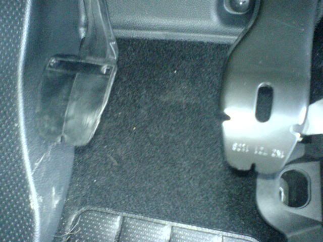

i got them from vwspeed dave. up to now ive got the brake and clutch one on, im gonna have a go at the accelerator this afternoon.
