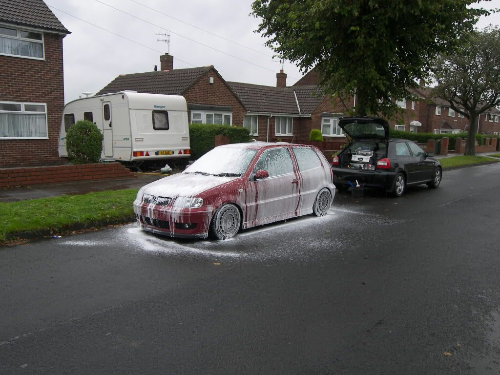

I started by giving the car blast off with the pressure washer as it only really had light covering of dirt on it, the car was then given its first coat of snowfoam using a mix of megs hyper wash and snowfoam .Whilst this did its stuff I cleaned the wheels using a weak mix of bilberry wheel cleaner and various wheel brushes.

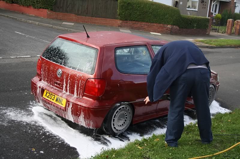

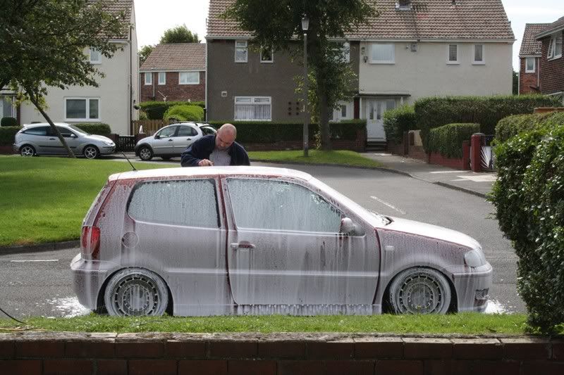

This was then blasted off with the pressure washer, and then the car was given another coat of the same mix snowfoam and washed using Meg’s hyper wash and the 2 bucket method and a wash mitt before being power rinsed off and dried. The lower parts of the car and inner arch lips where sprayed with Tardis which was left to do its stuff before being wiped down with a microfibre cloth
