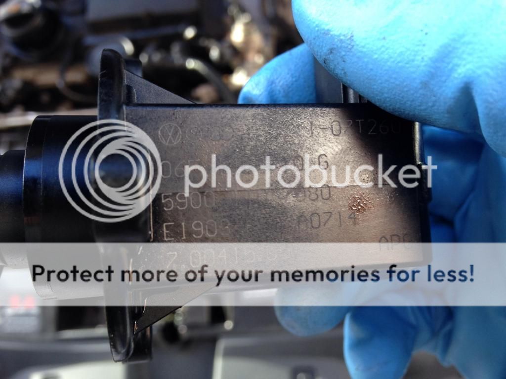

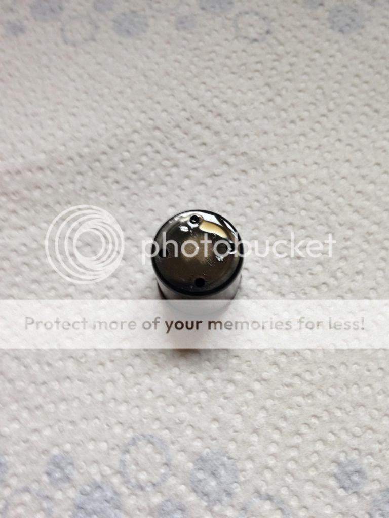

Removed and inspected my diverter valve currently the car is running a rev G, looks ok but for the small cost i will order and replace with a rev D.Reason being I'm aware that these can and will fail over time and as the car has done 41k it's time for a new one. Plus I'm curious to see if there is any difference between the two.
Get yourself a Rev G. There is plenty of info and many many pics demonstrating the difference, plus the G is cheaper
