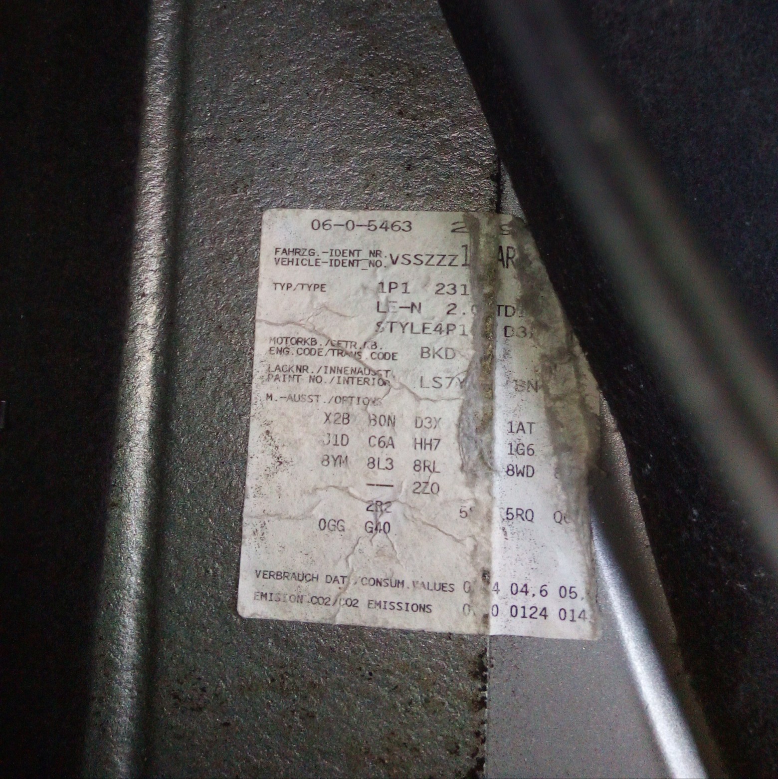

Can you post a picture of your build sticker? That would shed some light on what's going on.
It's on the boot floor under the boot lining and there should be a copy in the service book too.
As above lift boot liner take a picky of the label on the left side and post it here.
Bit worn but here you go

Okay - silly question - are you sure it's a facelift car and not a late registered pre-facelift car?
The portion of the VIN that would identify the age of the car is damaged on the label.
No DPF is correct for the BKD engine in the Mk2 Leon so I'm a bit surprised your tuner is saying he's never seen that before.

Point I was getting at though is - is it really a 2010 model? I've got a PDF of the 2010 model-year brochure and the PD140 BKD engine is definitely not an option, yet that's what your car has.
I wouldn't rule out the possibility that it's a pre-facelift car that's been converted at some point - possibly even by the original selling dealership prior to being offered for sale.
If you want to post your full VIN I can try to look into it in more detail, or perhaps contact SEAT UK tomorrow and ask them to confirm the production date and original sale circumstances for your car.
