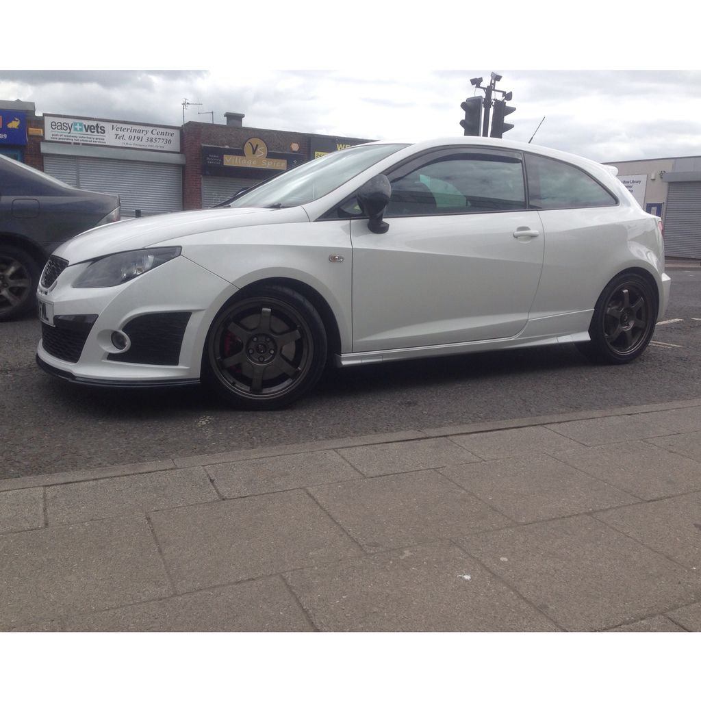

I've also upgraded the fog lights bulbs. I noticed when using the conering function the standard yellow bulbs looked rubbish compared to the headlights. I was going to go for some LED's but I liked the style of headlight bulbs and the way the foglight halogen bulbs fade on and off with the cornering function, I didn't think the on/off style of LED's would have worked as well.
Before:
IMG_0474 by Rich Perkins, on Flickr
After:
IMG_0472 by Rich Perkins, on Flickr
Comparison:
IMG_0469 by Rich Perkins, on Flickr
The original Foglights are H8, for some reason they are rare and expensive. After a bit of research I realised H11's use the same plug and fixings but one of the metal tabs is bigger. H8's are an inherently weaker bulb too. Taking the Philips Diamond Vision Bulbs:
H8 - 35w, 500 Lumens and £60 a pair.
H11 - 55w, 700 Lumens and £30 a pair.
It was a no brainer really.
IMG_0463 by Rich Perkins, on Flickr
Tab Before:
IMG_0479 by Rich Perkins, on Flickr
Tab Dremmeled off:
IMG_0481 by Rich Perkins, on Flickr
