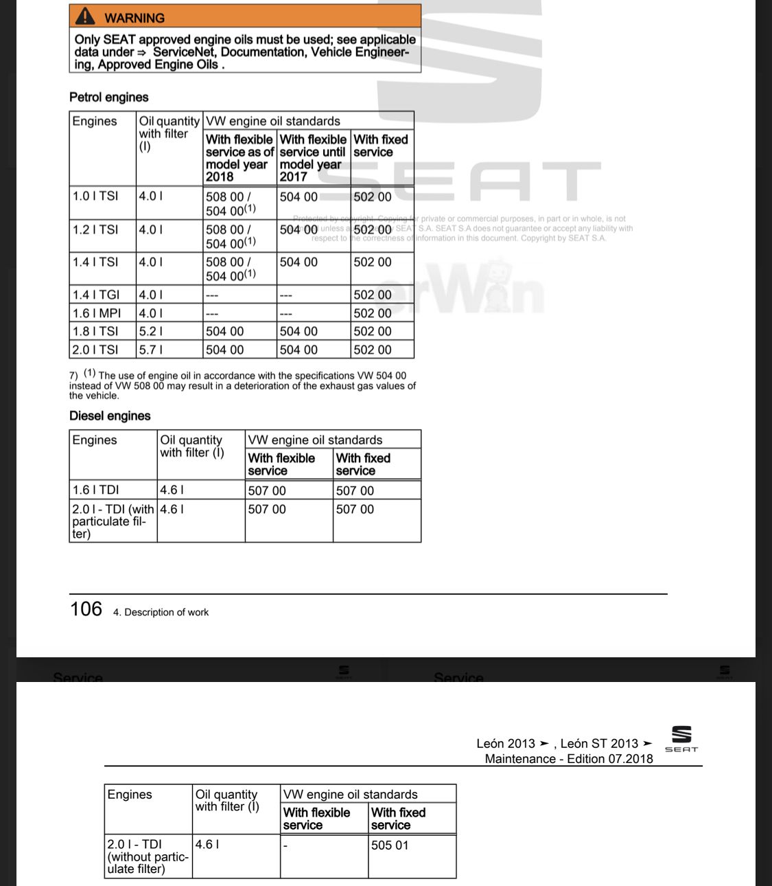

Legit sources. All specify around 5.7L. Also the HumbleMechanic (certified VW master technician) on YouTube has a video on that for his MK7 R and he also specifies the amount as 6 quarts (5.7L)
This is from the Maintenance Manual:
Is 4.7l what you get in initially or including, after running the engine and topping up again?
There will always be some oil ‘hang-up’ in the engine, oil cooler etc.
It even says 5.7 in the manual. I get in 4.7 after draining, installing a new filter then filling. I have never needed to top up after the engine had run after the oil change.
