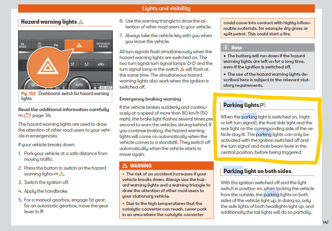

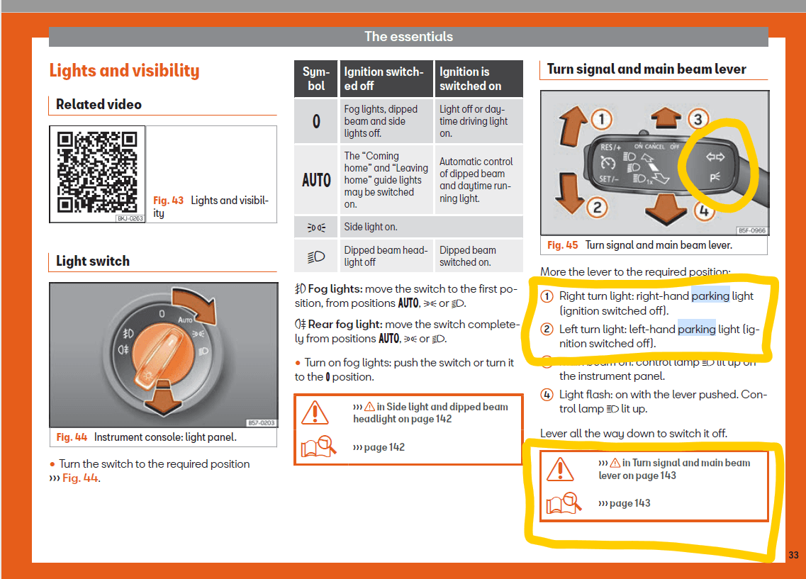

Yeah its a feature and it should do that. :) If memory serves it should only do it if you put the indicator on after turning the ignition off, in fact you may even need to remove the key. I have a PDF manual somewhere....
Damo H
Oct 3, 2012
4,707
2,816
Car Length In Front
Taken from the July 2018 Edition Manual :)
