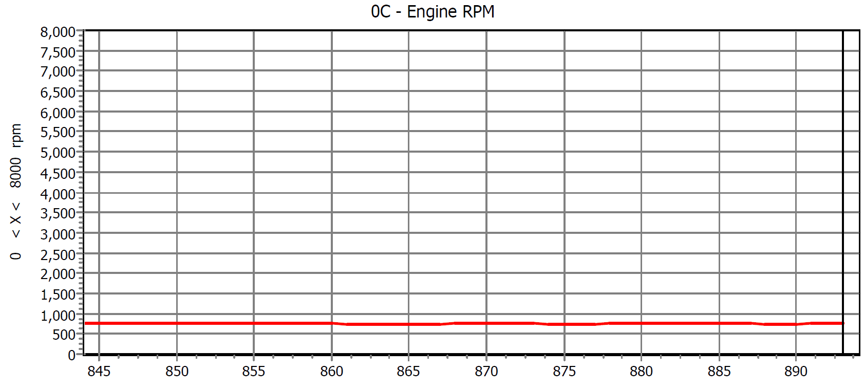

I now can’t tell if i have a rough idle or not or if it’s how it should be and i’m over thinking. It’s not fully smooth but it also does not jump erratically at any point (i’ll try and get a graph reading if i can)

Here’s a video of the engine currently
YouTube Link
I actually don’t think it’s what i think, the RPM just over a minute is around 760, there’s the odd tiny blips that you can’t make out on the graph, goes to around 780/90 for second and i can feel it slightly jump sat inside. It’s probably normal haha.
