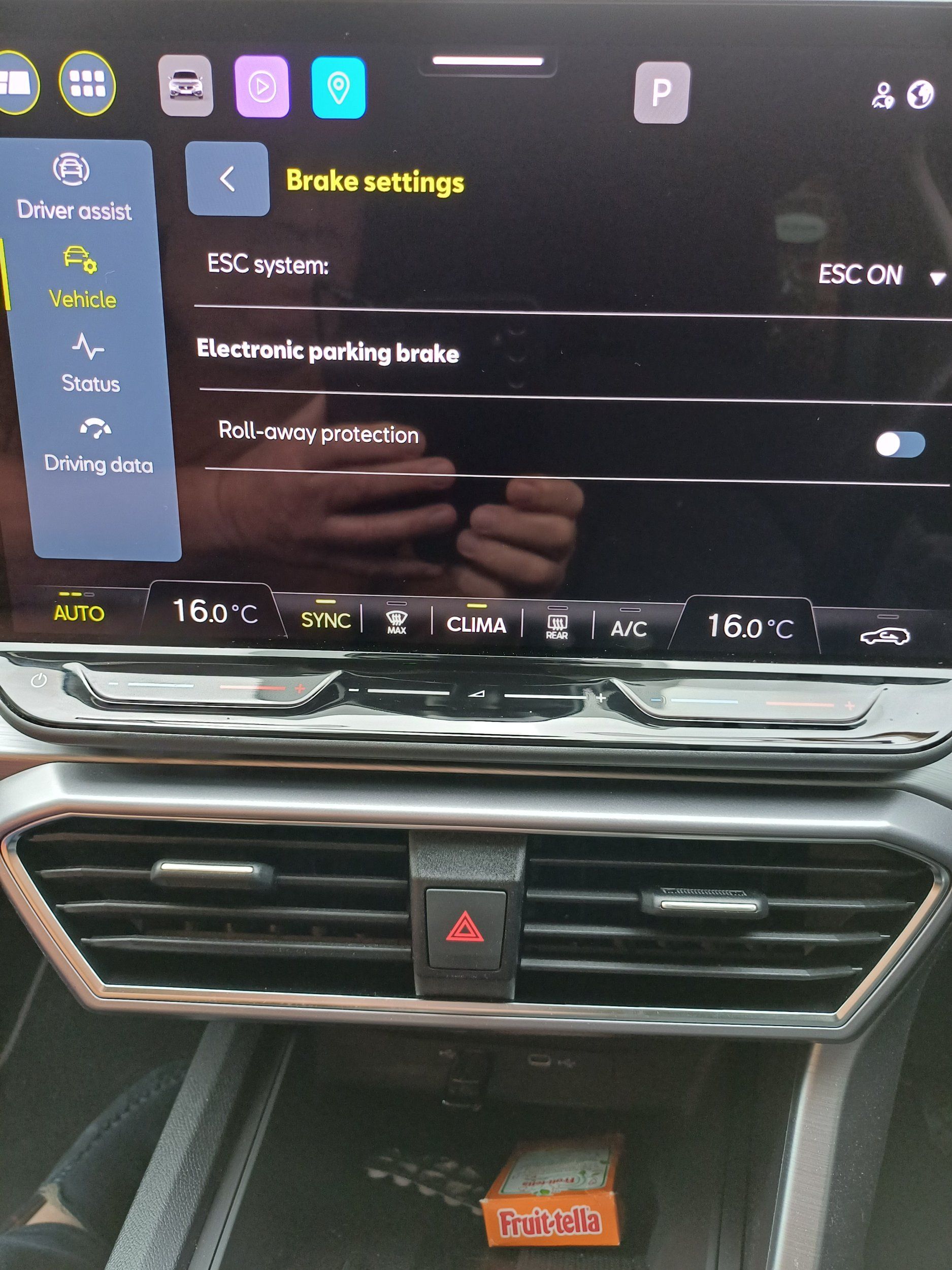

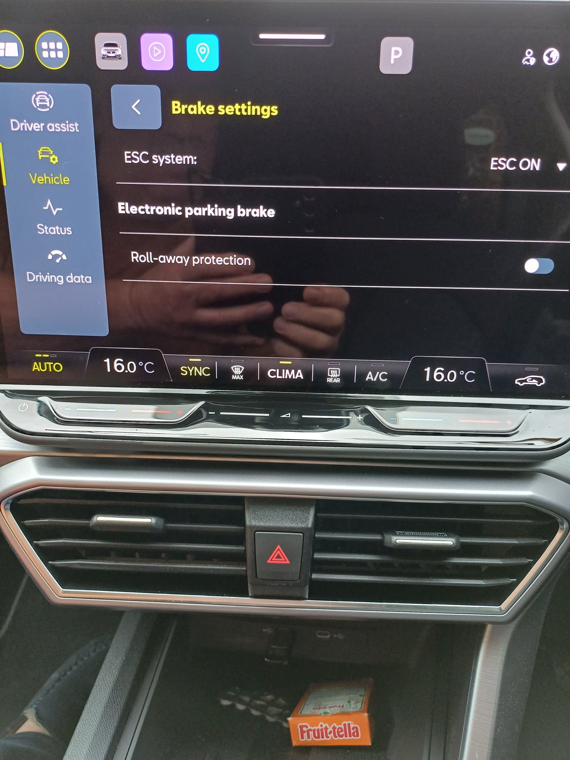

I'm sure the roll away protection feature can be switched off in the infotainment system? I think I turned mine off due to manoeuvring issues and the parking brake engaging. I'll check tomorrow.

I don't know? It's really weird.
I've asked her to really make an effort to note every single action rather than go on autopilot - check every button pushed, every pedal moved - to try it using my profile rather than hers.
I thought the auto-roll protection was something to stop the car rolling away that you needed to disable to get towed, but I may be wrong.

@Yern - check if it's a profile setting or a global car setting.
It also might be one of those ones that switches itself back on, like lane departure warning.
