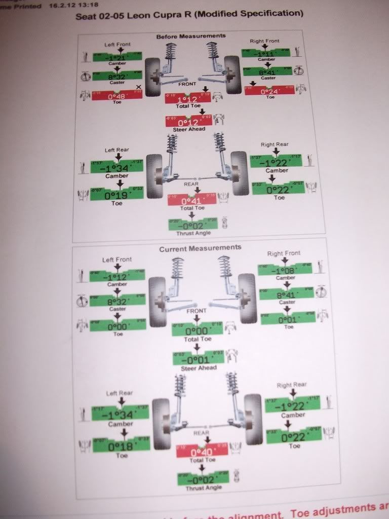

Hunter alignment showed up nothing strange. Going to find printout and scan it in so you can have a look.

Ok I hope this picture works. Only thing I just noticed is that its for a CUpra R setting not 2003 Cupra but not sure if that makes a huge difference. Caster is off but ever since the Eibach dropped suspension its always been a bit out.
Hmmm, nothing looks too out really does it, too much cross caster can cause pulling.. But it's really not out by that much.
I know its very strange. The only thing I could think is if the machine itself is not calibrated properly. Did look at the rear discs last night, the pads don't seem to be touching across the entire surface of them so its a possible issue. I think I need to get a brake test done on it MOT is due in a month or two anyway.

Mine does a little bit, but then so has every mk4 golf I've driven too. Nothing major though. I don't quite understand how the wheel alignment works but could the subframe be slightly out of line or would that show on the printout as thrust angle,hopefully someone who knows can confirm?
Has no one poitned out your castor is way out? Have you got adjustable top mounts? Has the subframe been off?

the caster has been miles out since the eibach lower suspension but thats around 7 years ago the pulling system is new. I have been getting the alignment done every 2 years approx since then.

Correct me if I'm wrong but usually the castor isn't that badly effected when dropping the car? I think something else is also a miss because of your castor angle, incorrect castor can lead to twitchy and unpredictable handling, binding brakes is easily dissed out with the above method, iv just had a problem with binding brakes but mine turned out to be a combination of servo rod mal adjustment and two new rear calipers.
unequal caster would cause problems ... But .12 of a degree ? It could be worth getting the subframe shifted to see what you can do with your caster angle. I would also get it tracked up again, there's no real reason for you to be toeing in 0.02 on one side and dead straight on the other , just lazy technician !!
Unequal yes but he's also running 2deg too much castor too, agree with the lazy technician mark though, really no excuse when your already under there and esp as all he's adjusting is toe and nothing has adjustable cam bolts like some cars do.
Here's someone else's graph to show the figures of a car in spec, shamelessly stolen from Dolby on another thread :)
Yeah, I've got no argument that it's off, but as long as it's equal it shouldn't really pull. Has your gearbox ever been changed ? To your knowledge? It's possible the frame was just shunted all the way back.
Iirc too much castor will make the car uneasy so might be magnifying the effect of something else that's causing the pull, either way he's probably best getting both items corrected for it too drive properly, mine pulls but ever so slightly sometimes, it's hardly even noticable and sometimes it's doesn't, running all the same tyres and having your geo in spec really does help :)
I also concur that it really does look like your subframe has been moved.

yes I would like to see that caster sorted and it may help everything. I think its time for another garage to have a look at it as McConachys where they did the last alignment just said all Seat's pull so not exactly the solution I was expecting.
