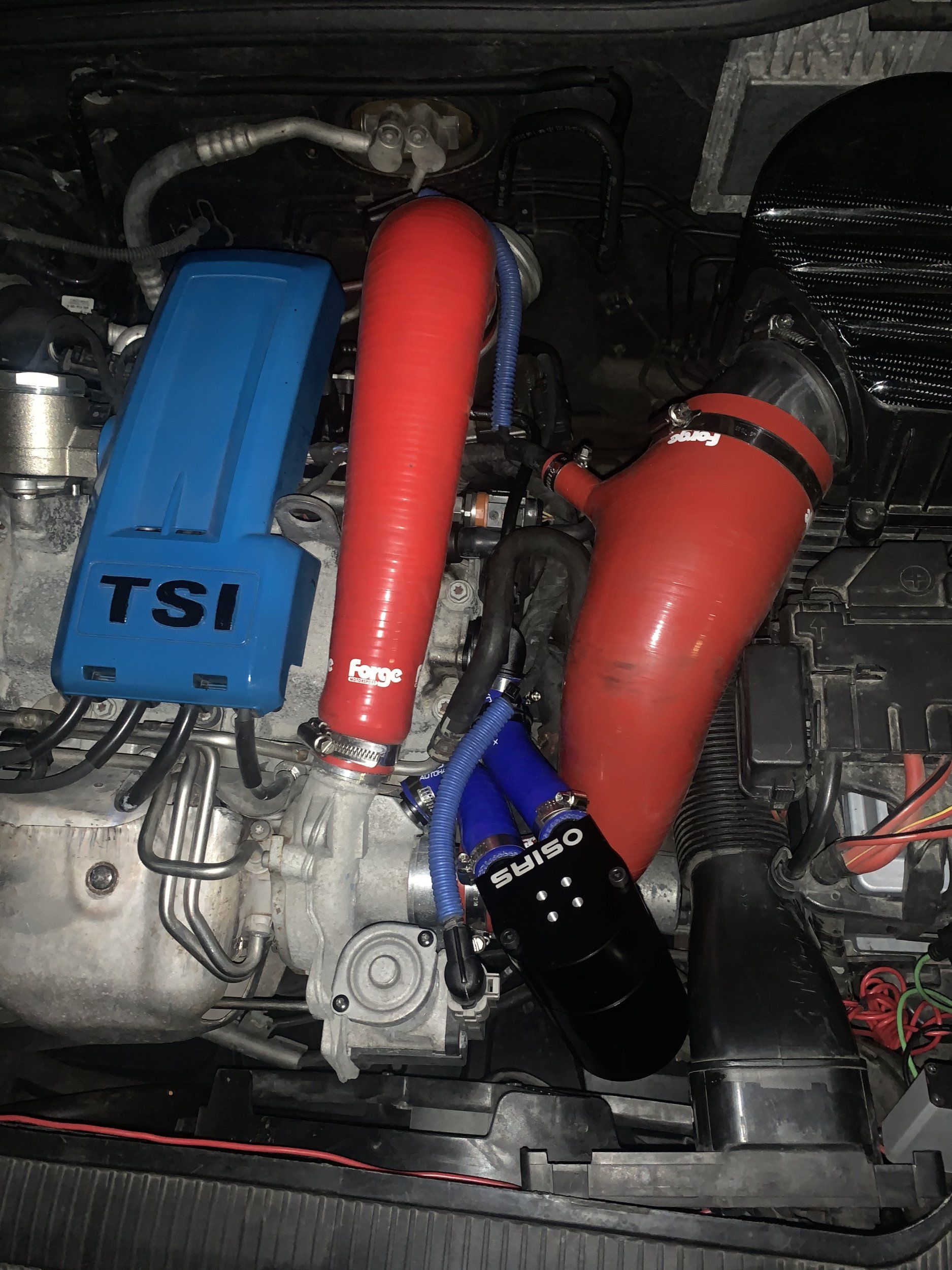

I’ve also just added an oil catch can on crank case vent (out) I removed small foam insulated pipe going to turbo and added two 90degree pipes to install it it’s caught water from condensation and a little oil since I installed it yesterday.
I also replaced both the vent valves ,
the little pcv that vents air in at the back of valve cover and larger one at side of valve cover that vents gases out to turbo intake )
no splits or cracks either I think my only option would be to take it to VAG professional.
