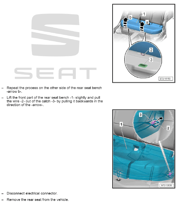

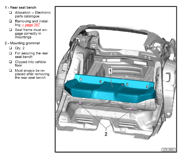

Where can I find a manual or instructional video on how to disassemble the rear seat in a mk4 leon? Pulling up from the front under the seats doesn't work, and I don't want to brake any clips. A few small coins have fallen into the hole around the seat belt buckle and I am trying to get them out.

same like on old Leon just pull the bench out near the clip and pull the seat bench towards you
