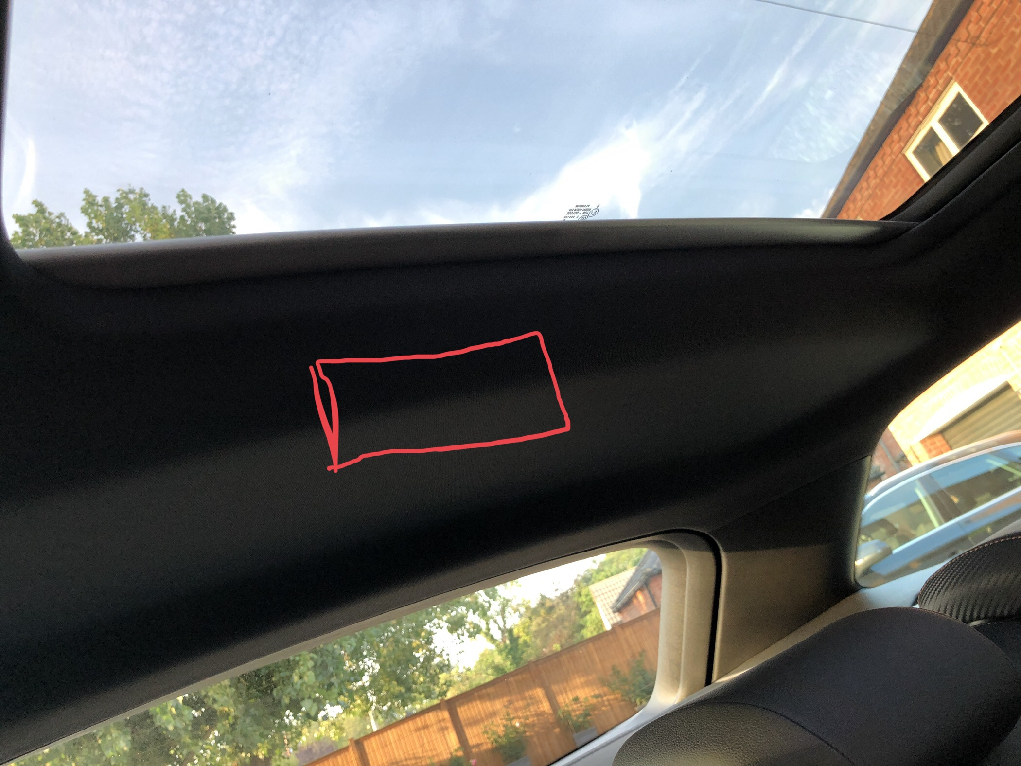

Hello guys/gals,
I’m in the process of trying to track down and eliminate some of the (many) rattles and creaks in my 2 month old 1.5k mile R ST.
I’ve not been back to dealers yet but it is an option I guess.
My main antagonist in the rattling is the small roof/headling area between the pano roof and the rear windscreen.
It’s pretty much constant no matter what the road surface.
It’s not the sun blind as it happens if that’s in or out.
I’ve managed to localise it to the area in Red in attached picture. If I press this area firmly it disappears.
Is there any quick and easy fix for this that you guys can recommend before I start the process of going back to the dealer ?

The main rattle in the headlining was fixed under warranty by Seat.
It turned out to be a loose clip.
The driving experience is so much more solid now without that major rattle.
