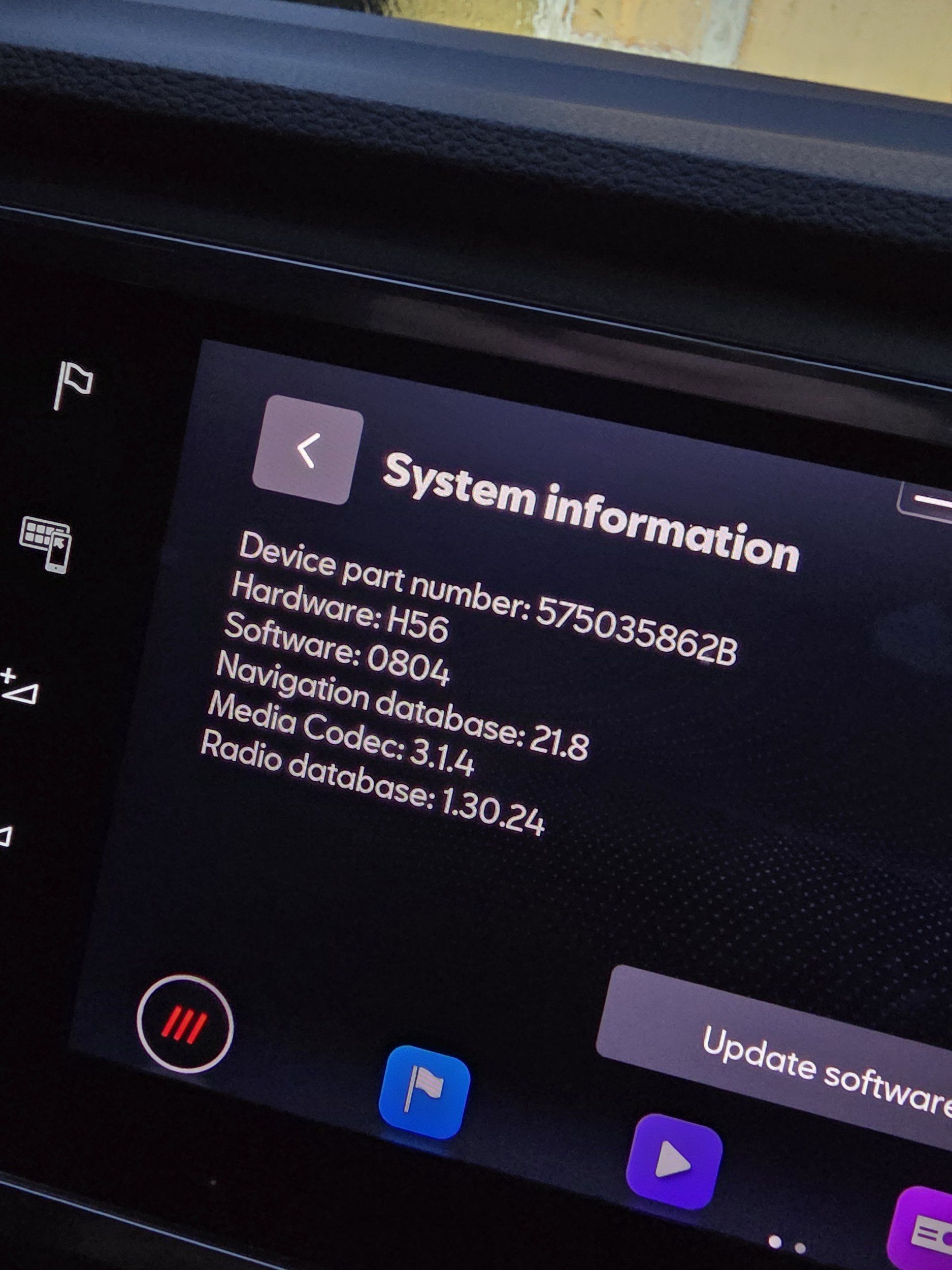

I'm having a bit of a tricky time with this SEAT Connect login though. Whenever I try to make a new user or log in, I keep getting this 'Unable to load user profile' error. SEAT suggested I tweak my privacy settings, but every time I try, I either get stuck on a loading screen or receive another error saying "Privacy settings and services" are currently unavailable.
I gave factory resetting and the long-press reset a go, but it didn't seem to do the trick...

Hi Greenfoot,
I had the same issue. I brought my Arona to official service they didn't have a clue how to fix it. The car was still under factory warranty but according to them software issues are not covered - it is imported car so they were just trying to get rid of me.
So I reached out to Seat support , which turned out to be a huge mistake because all i was getting from them is that I need to change the privacy settings and it took me 6-7 months and who knows how many mails to get to the right person there who understood the issue and informed the garage what needs to be done.
When picking up the car from the garage the front desk guy was like yeah we fixed your issue you are welcome... And it was not fixed.
Yesterday I ordered the fw update pack from the East Yorkshire guys, installed it just now and everything works without any issue. I can access and change privacy settings.
I hope the issue with your infotainment system is already fixed but in case someone else has the same problem the solution is really simple thanks to East Yorkshire Retrofits.
