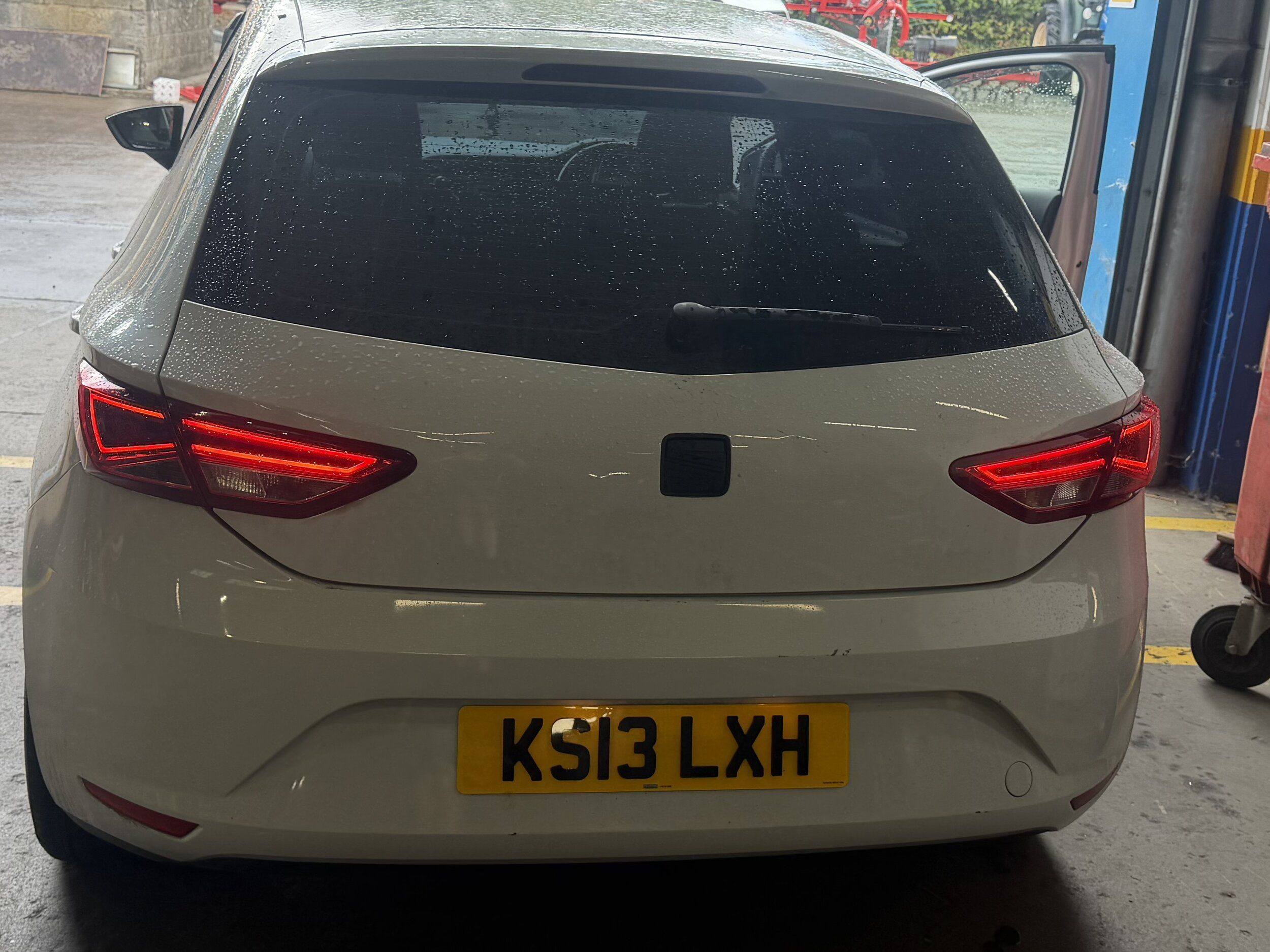

I have done this retrofit on the rear, the boot ones are plug and play then outer ones you need a single wire from each outer twilight and wire it up to the top brake light.
