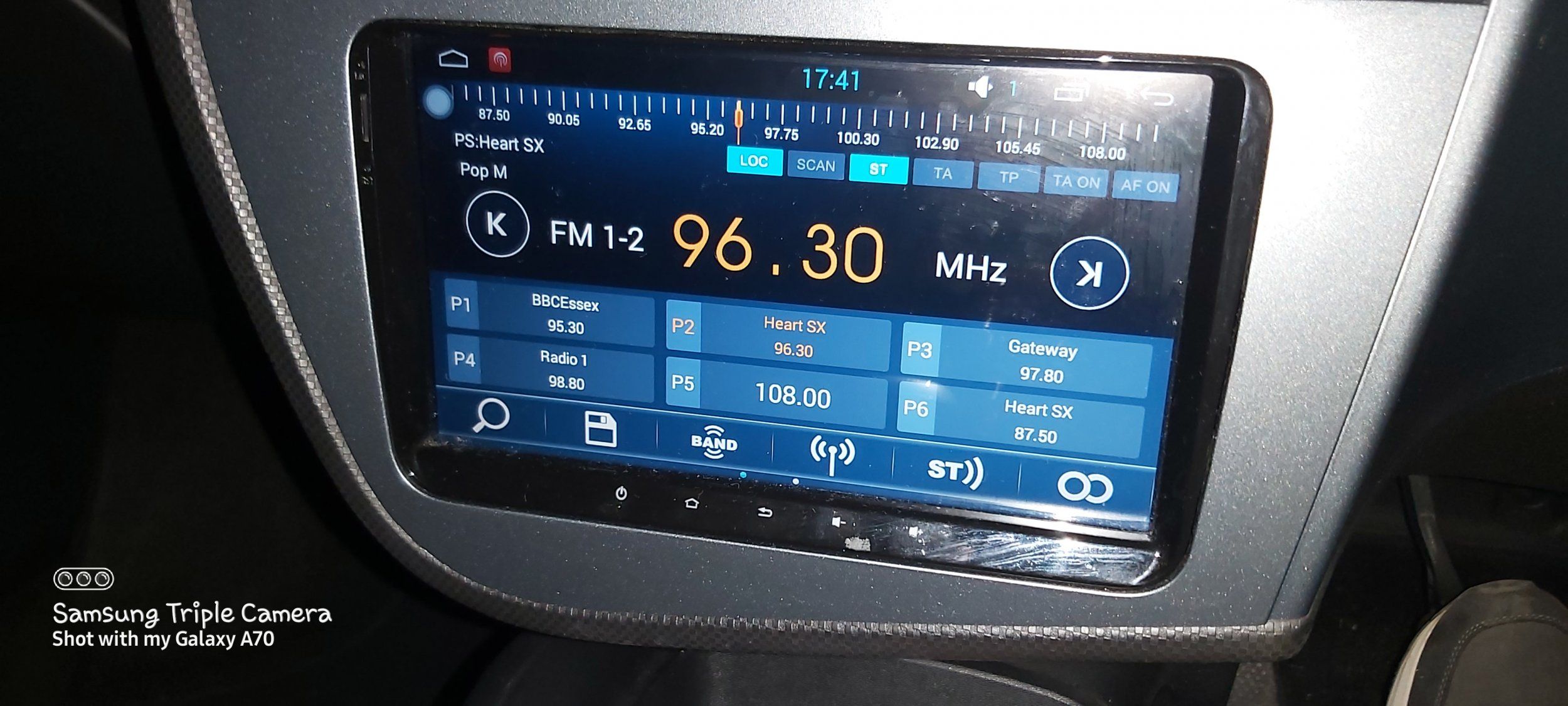

My steering wheel controls isn't working as the car has a Xtrons android unit fitted and needs a module , could be this a problem ?
Can anyone tell me what should I check ?
I will add some pictures with the Xtrons unit

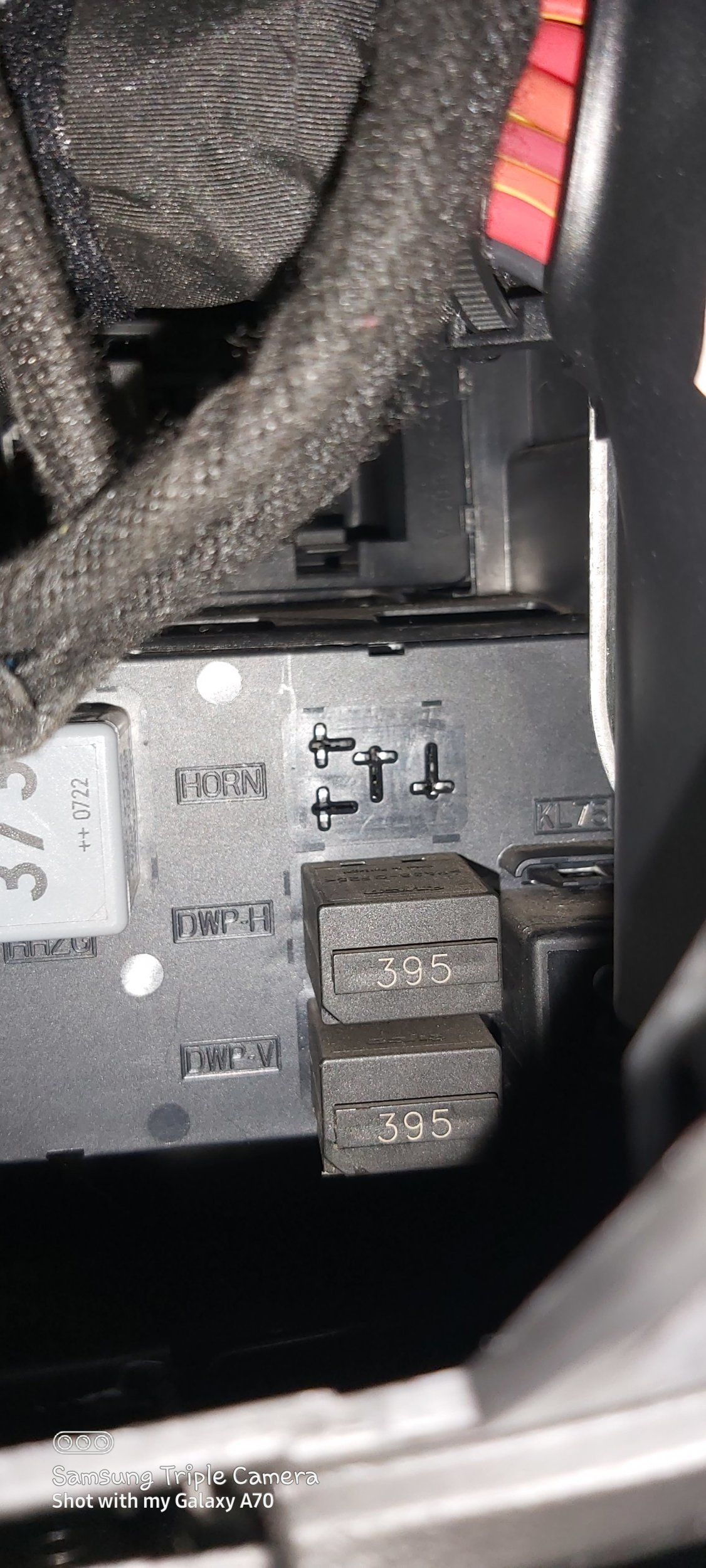

I did check the 449 relay which is located under dashboard , it works tested on the bench .
I did a picture with relay location .
It seems like when I press the steering wheel switch it doesn't work , everything is alright . How can I change the switch ?
