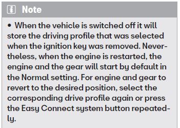

Thank you @R4CK5 & @heliophile - My Bad - You are exactly right, this is covered in the manual (LEON_07_18_EN.pdf, page 292) https://www.seat.co.uk/owners/your-seat/manuals-offline/manuals.html?model=Leon (2018)&id=89&_charset_=UTF-8
That is precisely my experience so it is behaving as designed. Whether or not SEAT should have restored Drive Profile to Normal to match is a moot point. It really does look inconsistent when digital cockpit puts the DSG / engine mode info right in your face! It was never so noticeable before. As @R4CK5 rightly comments, with my 2 previous manual FR's it was always difficult to tell if the engine was actually still in Sport on cold start.
