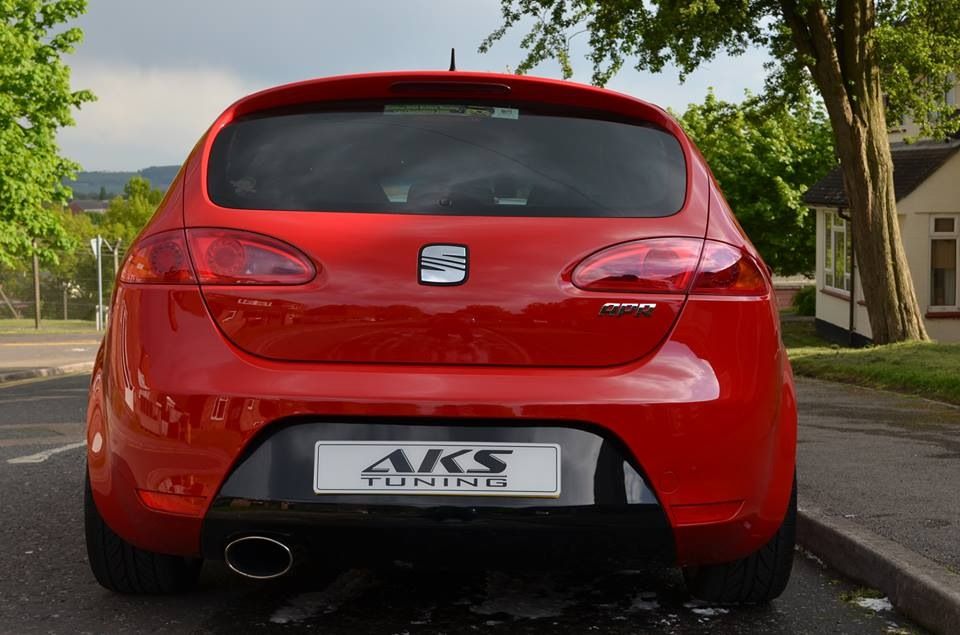

£70 at the body shop. Nice and smooth, nice & glossy. Happy with mine
