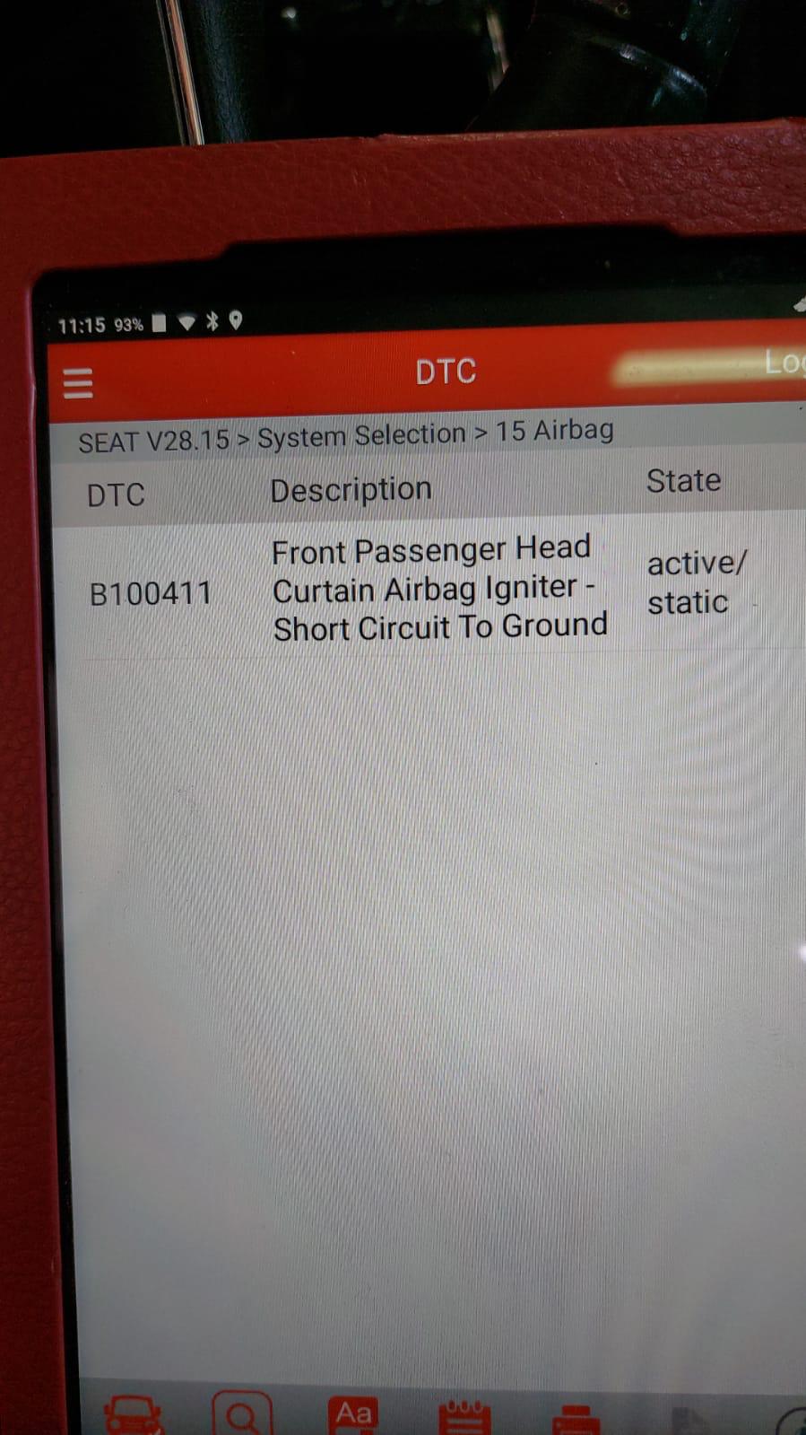

I own a Seat Leon 1.4 FR 2016 MT
About 2 weeks ago an SRS Airbag error light popped, i have scanned it with diagnostics tablet at my local garage and still can't find the problem
I have tried to remove the passenger seat and check the airbag connectors / wires and everything is brand new, also checked behind the pillar where the Seatbelt holds and same thing everything is fine and connected, im adding a picture of the scanned error code (b100411)

Maybe try disconecting each airbag one at a time. Then rescan to see if the short circuit to ground goes away.
If it doesnt the wiring must be damaged and shorting to ground.
