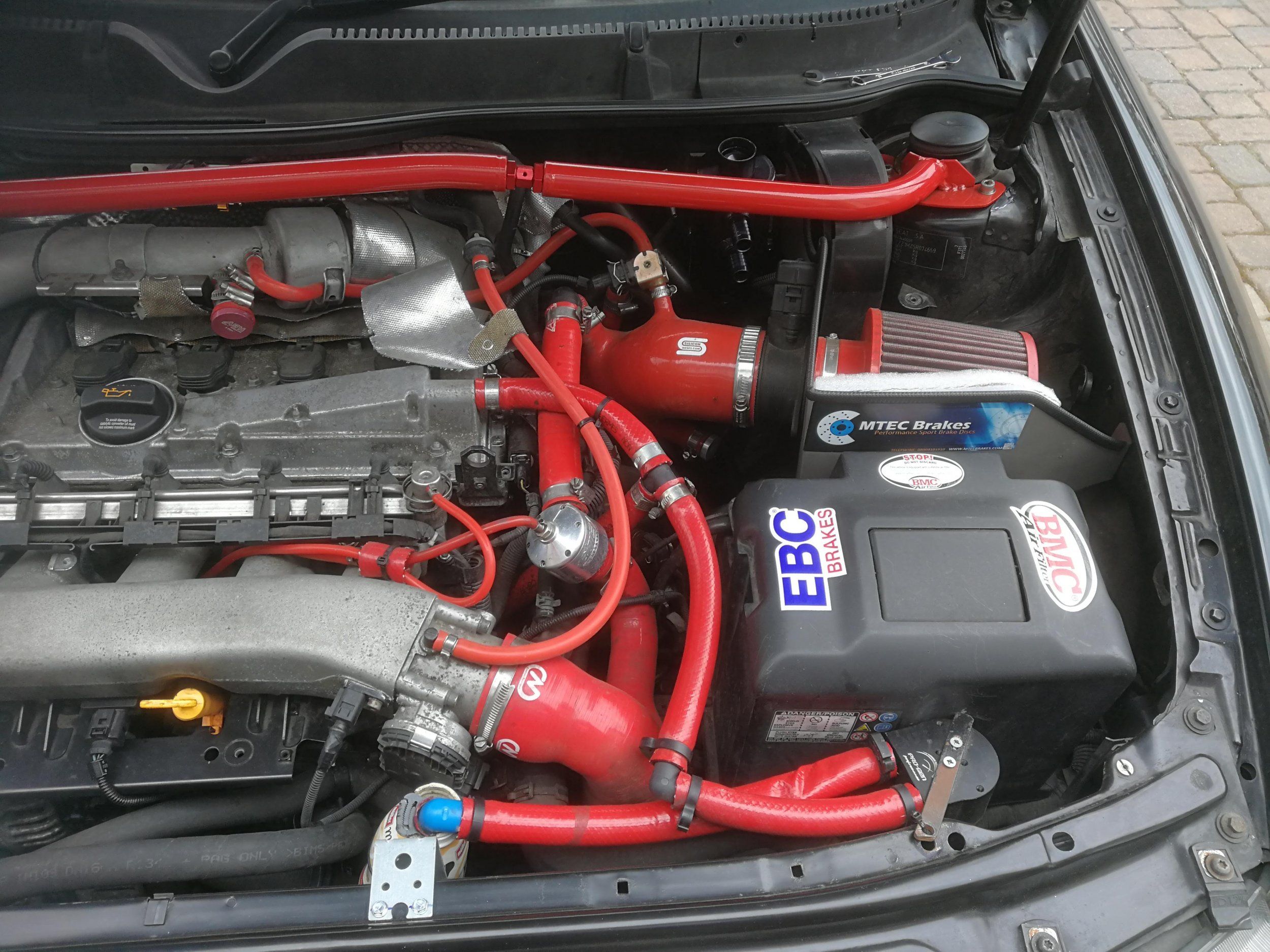

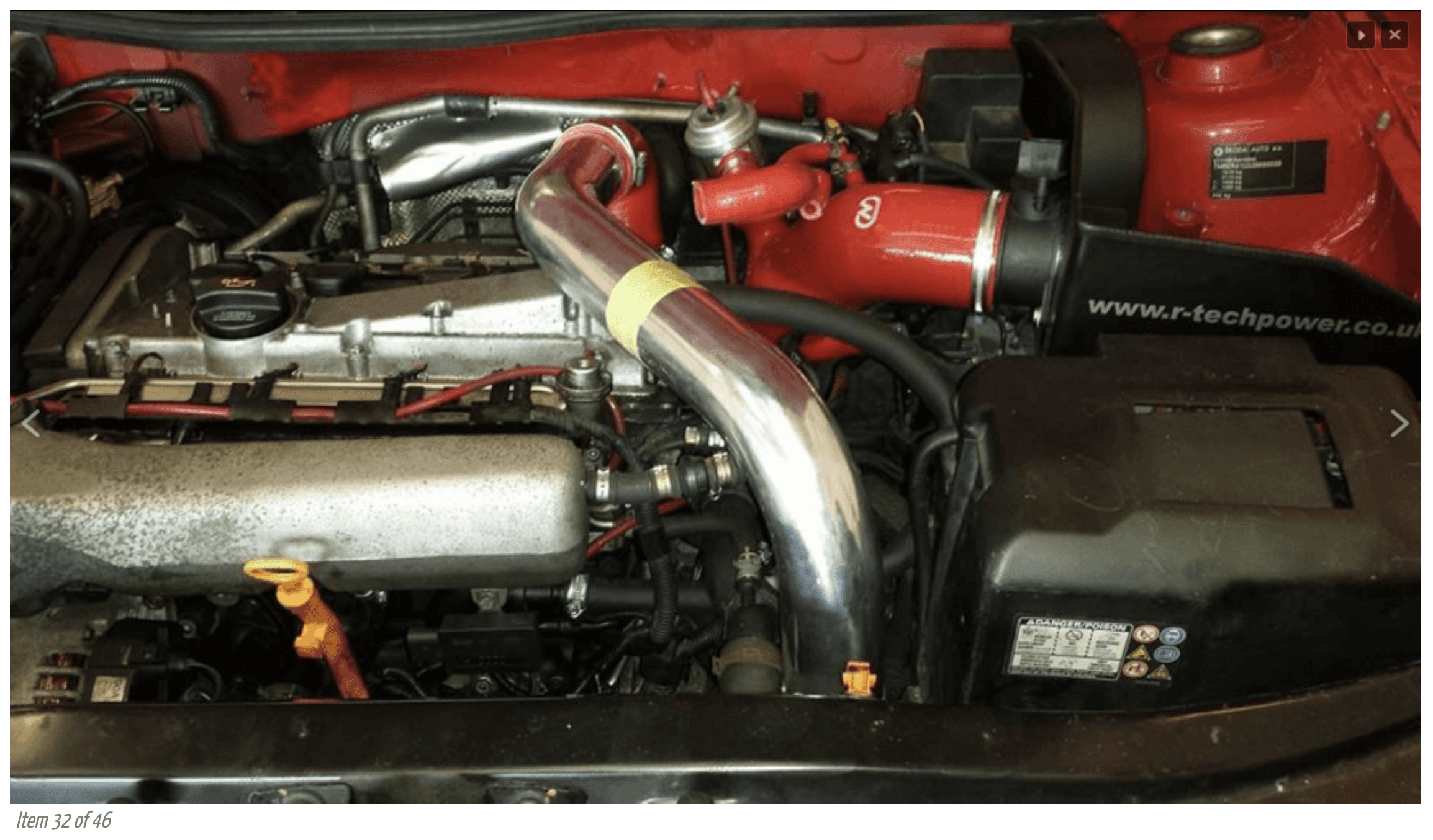

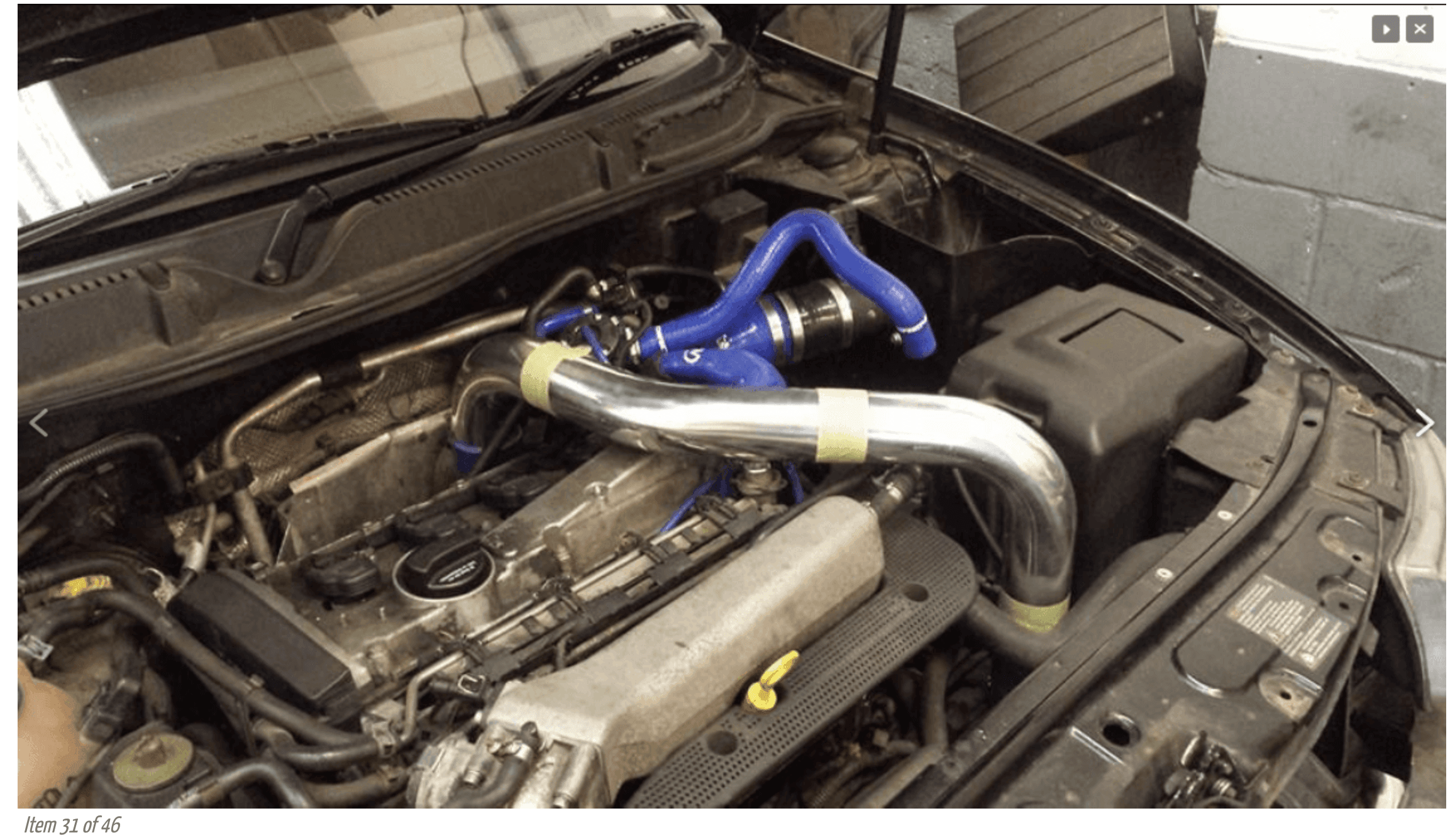

This is something I want to do with the TT brace, just cut the bits off that aren’t needed. Only thing is I have my intercooler hot pipes to contend with the space a brace would go.
Gokiwi64
Geriatric Member
Apr 26, 2014
1,379
722
Hockley, Essex
With that pipe in the way a TT brace wont fit without major modifications , maybe you need a different type ?, the one I have fitted wouldnt clear either by the looks of it.
Connor H
Dec 19, 2019
1,052
518
Essex
Oh ignore the engine bay - doesnt look like that any more !!
looks lovely either way!
And yeah im honestly thinking of redoing the hot side, i knew what i was buying with the "kit" but im not happy about the routing at all. I am totally stubborn with not getting a BAM mani either. Heres some good examples of routing i found
