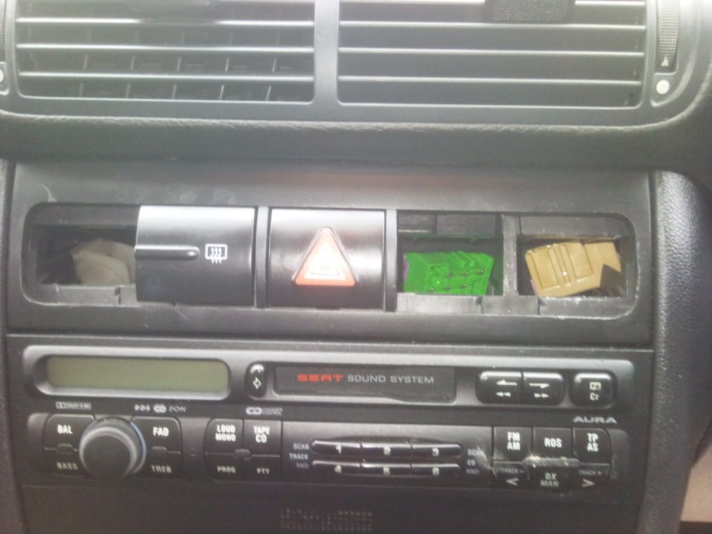

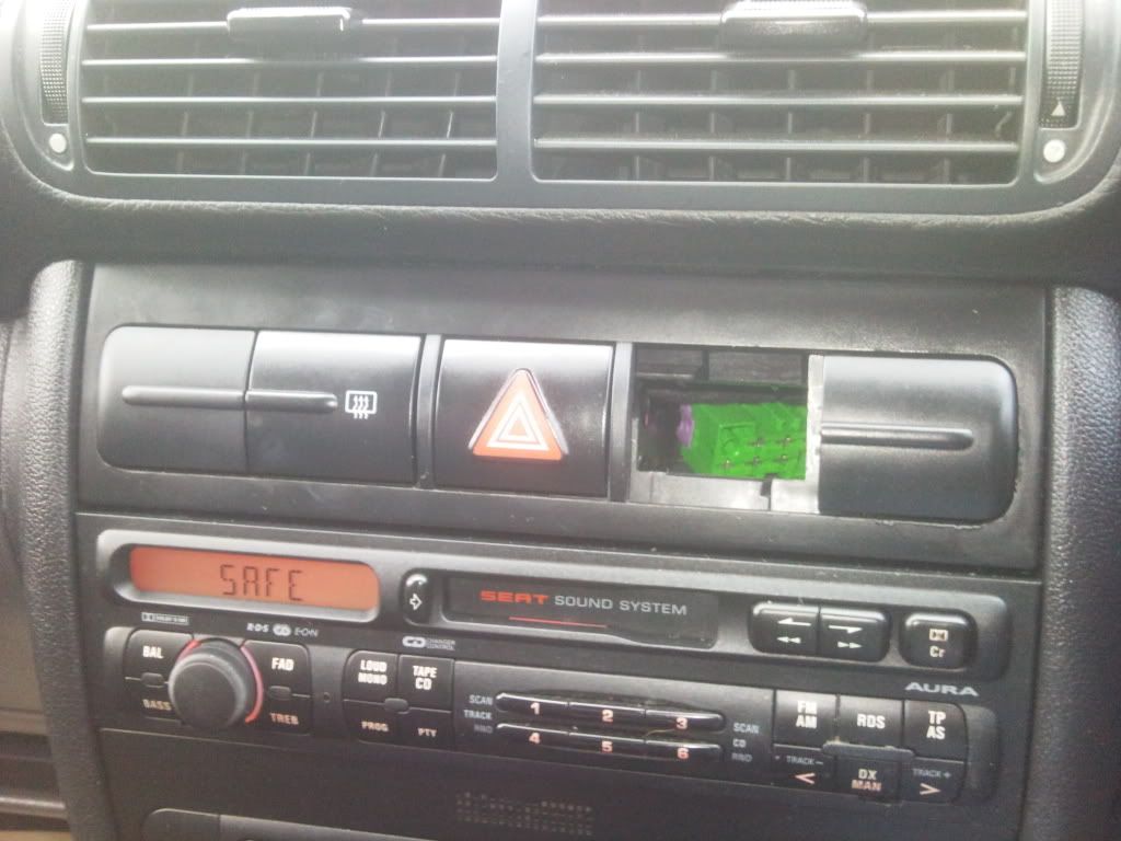

hi just taken delivery of my leon cupra and one of the buttons/blanks is missing on the dash (i did know about it when i bought it) i'm not sure just to get a cheap blank off ebay or due to the air bag light being on which i understand is a common fault should i purchase an airbag on/off button?
there seems to be sockets behind the missing piece im unsure weather they are related to the airbag the buttons are as follows from left to right blank,rear screen heater,hazard,"missing piece",blank

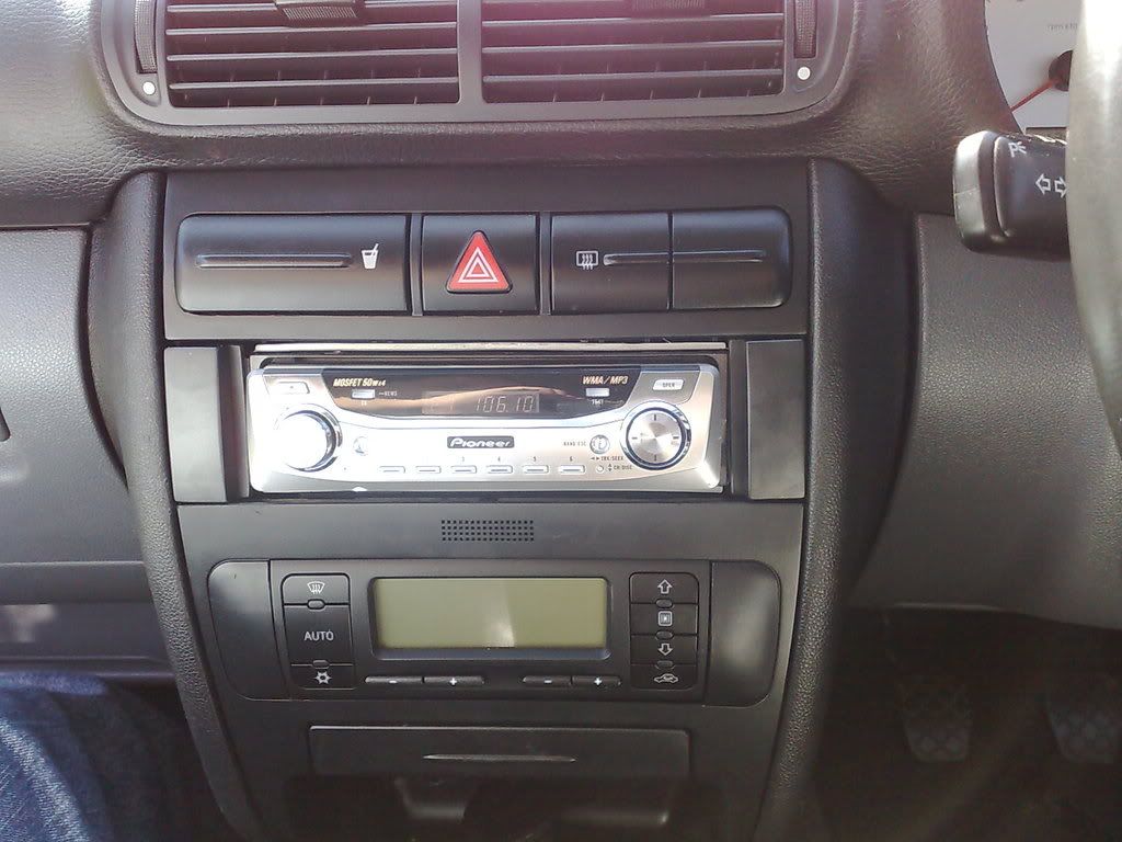

old picture
i cant put a picture up of what i mean yet as i haven't made enough posts, there is a green and a brown socket begind the switches anyone know if one of these should plug into an airbag switch?

It's not an airbag button it's just a light to let you know the passenger airbag is switched to off! The other two maybe for heated seats???
looks like the wiring is there so maybe got the heated seats fitted

I'd guess that it did have heated seats but the previous owner has sold em along with the switches'
And as I said its not a switch it's just an illuminator! The switch is in the glovebox
okay, i get you sorry i miss understood. they have one on ebay and its being sold as a switch...
anyway i think the interior is what came with the car full leather. is there an easy way to find out apart from buying new switches and/or ripping apart my interior
thanks :)
Not a clue mate, vag com maybe able to tell you some other members may know but thats all my knowledge on the matter exhausted!!
extra wires coming from the seat underneath - only a couple for airbags + 4/5 wires more if heated iirc
If you do order an airbag illuminator switch make sure you order the one for the right side on the dash
