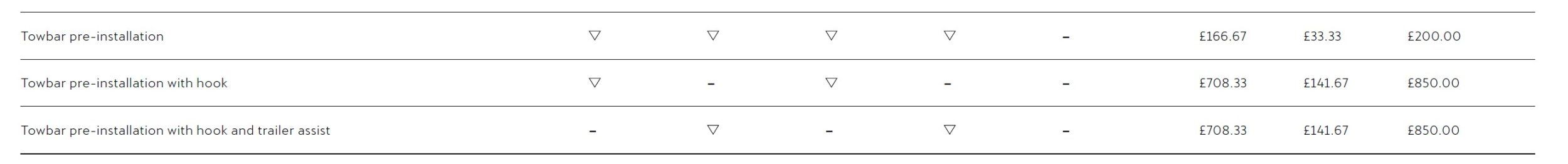

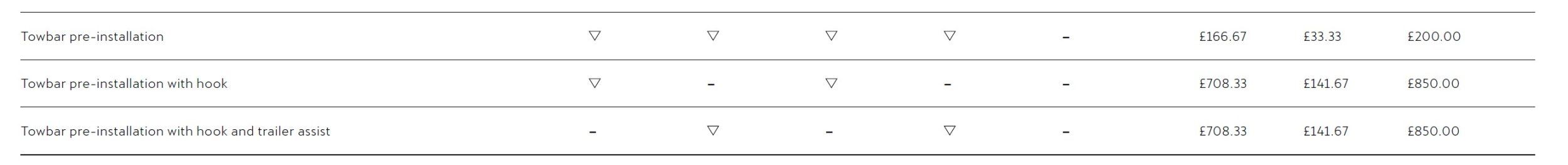

Our challenge these days and especially with a vehicle like the Terramar is that it is stuffed with technology to the point where the integrated safety systems overlap each other so something like tow-bar electrics need to be integrated at the factory design level. Looking at the price list Cupra evidently anticipated this issue too:
It is the right advice, the original poster has ordered a car and assumed that a retrofit tow-bar and electrics was something that could be completed after the vehicle is delivered - because that's what used to be possible. Walking into a bunch of potential problems isn't what they want to hear when the vehicle is nearly delivered....cancel and re-order in the right spec?
