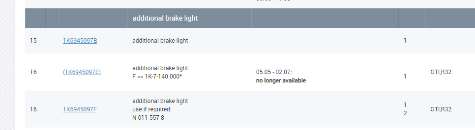

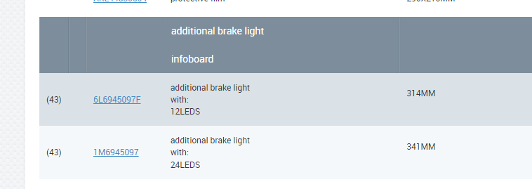

One with 12-LEDs and the other 24-LEDs, with different lengths specified in the parts catalog, as you can see in the screenshot below.
Maybe you can measure yours and look for it using the part number.
The other screenshot shows Golf Mk5 parts.
When you search on Google using part numbers for both cars and look at the images, they don't look so similar.
Golf ones look slanted on the sides, Leon ones are more straight.
