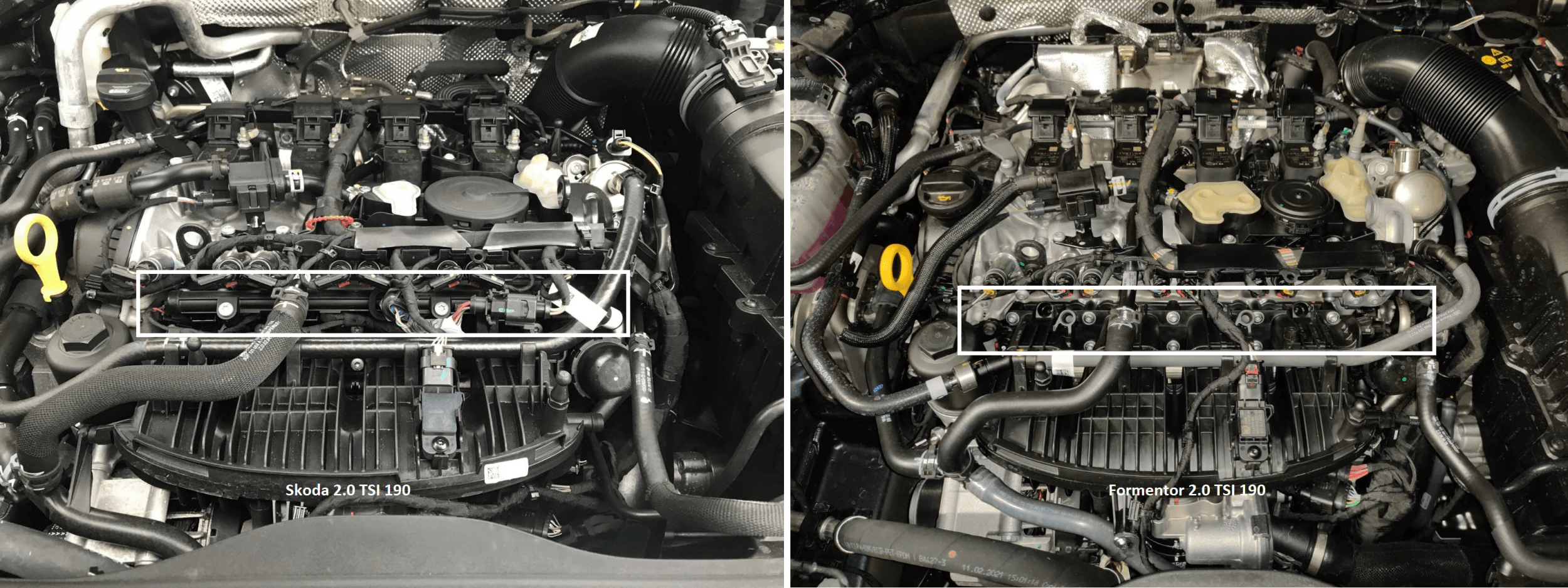

2. I had also studied the engine and I was under the impression that it was a double cycle one, having both the TSI injectors and a secondary, direct injection system. To my surprise when I took off the engine cover, mine didn't have the direct injection. Here's a pic with a Skoda engine next to my Formentor engine.
The dealer couldn't tell me squat about technicalities, like engine type, timing (belt or chain) or DSG variant (dry vs wet clutches). My expectations are timing chain and DQ 381 wet clutch DSG but don't know when or how I can confirm them.

It is common for mileage to be on cars, they drive from factory to transporter, then to port (if required) then to dealer. Up to 30 miles isn't an issue IMO. Regarding the injection system. VAG engines changed from dual injection to single injection a couple of years ago, think it was to do with the new emission regulations. It's a shame they have done that s the dual injection kept the bores cleaner and it was more efficient. There is talk on other forums with owners concerned the engines will coke up easier.

Regarding the engine, yes, that is my main concern too - the lack of cleaning via the direct injectors. I'll keep an eye on that, as well as other stuff like Haldex and DSG servicing which the dealer said are "for life" and I highly doubt it.

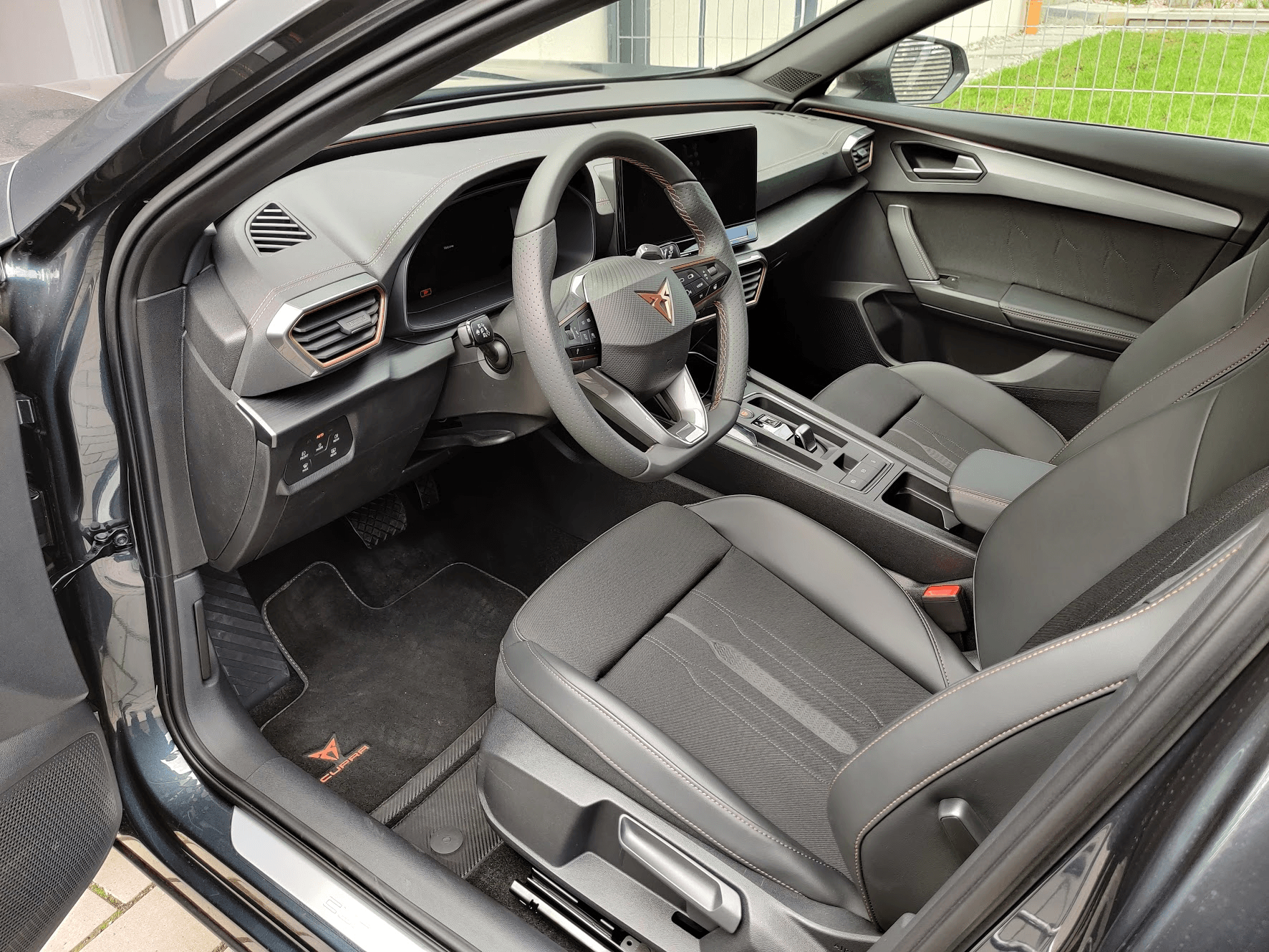

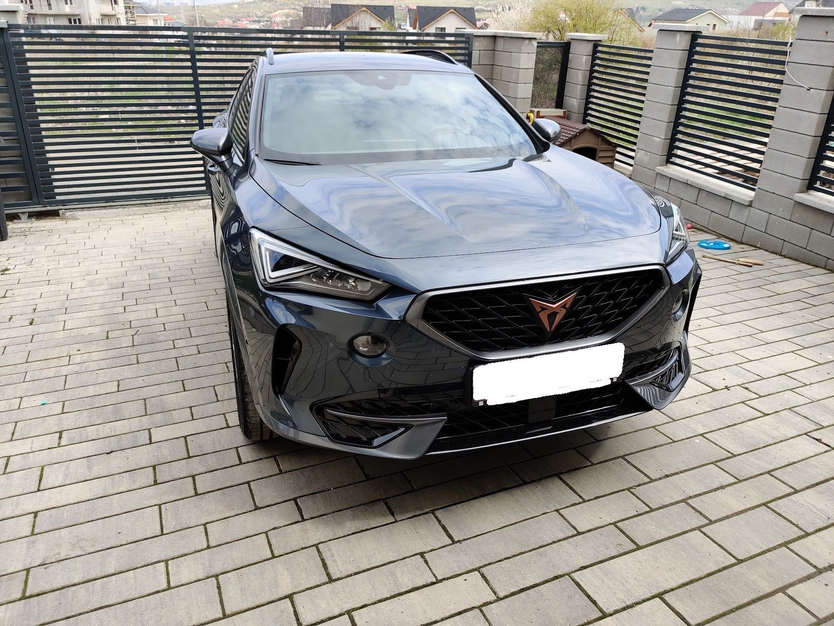

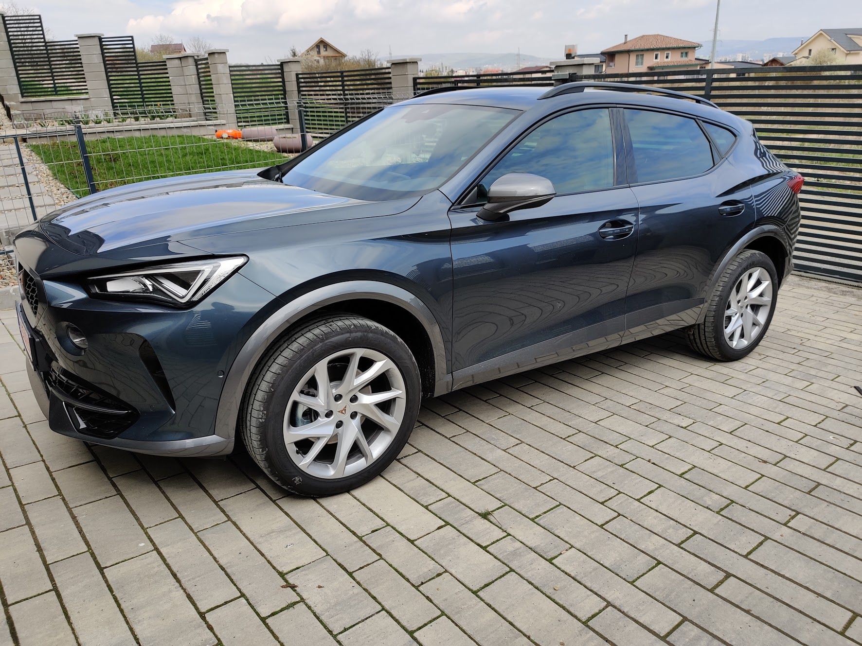

On another note, I said I'd come back with a couple of pics so here they are.
No flashy stuff as you can see. Specs differ a bit from country to country but I added some "basic" optional to the base trim: heated seats/wheel, rear camera, Side, Exit, Travel, Emergency and park assists
Took it for a spin today with the family and now its wife approved too :D. Only remaining tester is the dog but she'll have to wait for a proper boot liner
With regard to the engine, according to a knowledgeable and helpful mate it's an EA888 gen 4 (evo4) with particle filter. Curious how it will handle the supposed carbon buildup due to lack of the gen 3B multipoint injection

This engine has direct injection I'm 100% sure. On the carbon build up you just need to do the proper maintenance and you're good. Iirc at about 100k kms you should perform a valve cleaning etc. I'm also reasonably sure that this is performed at a set interval per the service schedule of the car.
