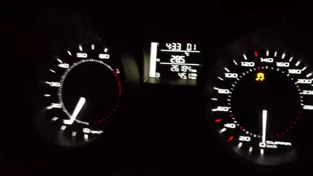

This is my boost gauge, not to brag but tbh I've never seen anyone with higher boost numbers than mine. Spike-hold-redline boost (keep in mind it's filmed in summer, now i do a bit better).
As you can see I got 1.65 bar peak, 1.5 hold and 1.25 redline. And these are at 28+ degrees Celcius ambient and after 5 consecutive pulls.
