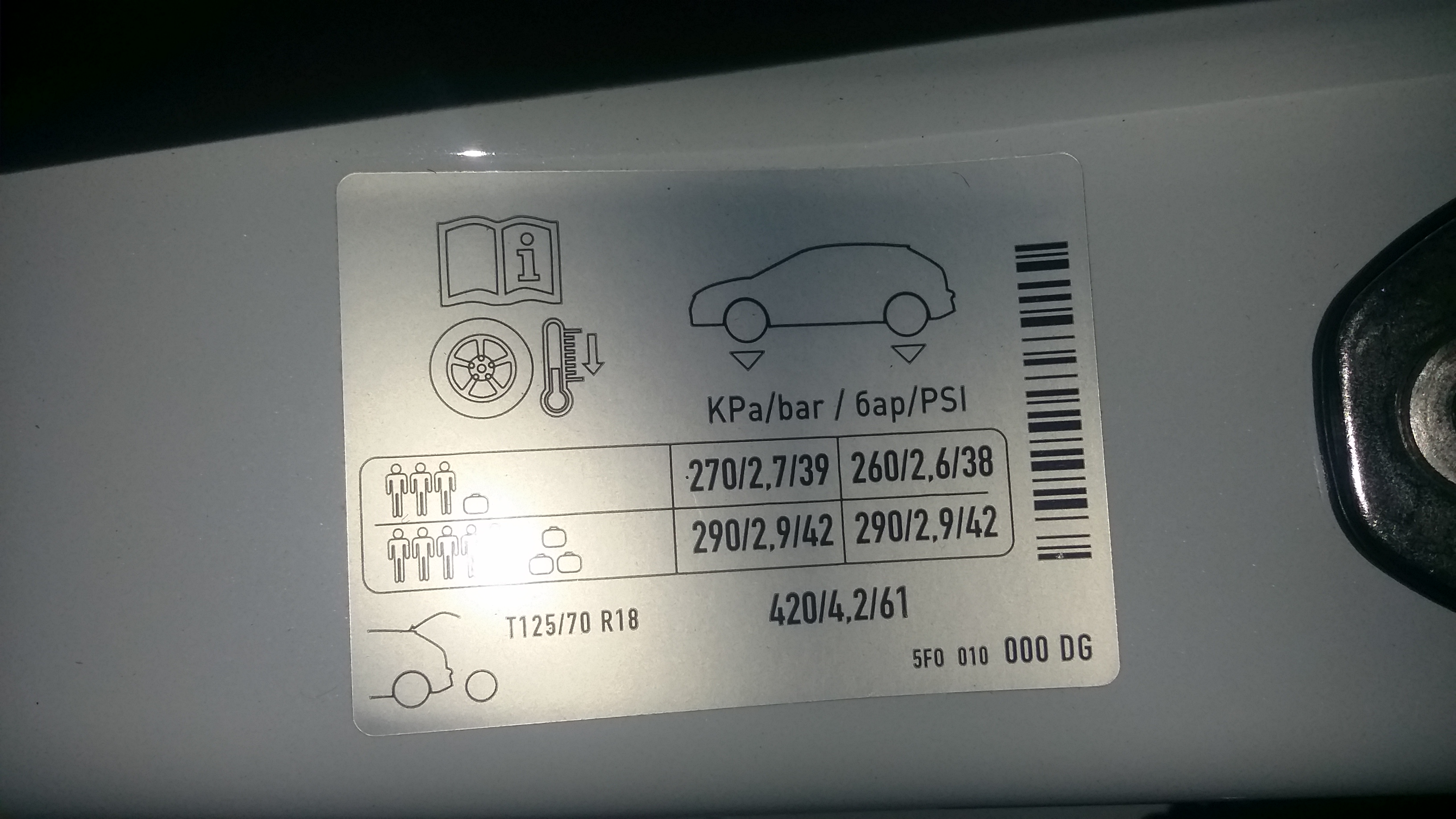

Ronnie. Mine (ST R too) claims 2.7 (39) at the front and 2.6 (38) at the back for 235/35/19. I inflate to 2.7 (39) at four corners. I can take a photo of my spec sticker if you'd like.

If you have had it from new I would suggest a visit to dealer to get the correct label, if someone on this forum has same car there is a part number on the label.
