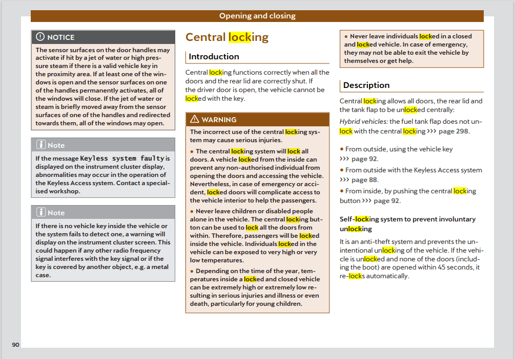

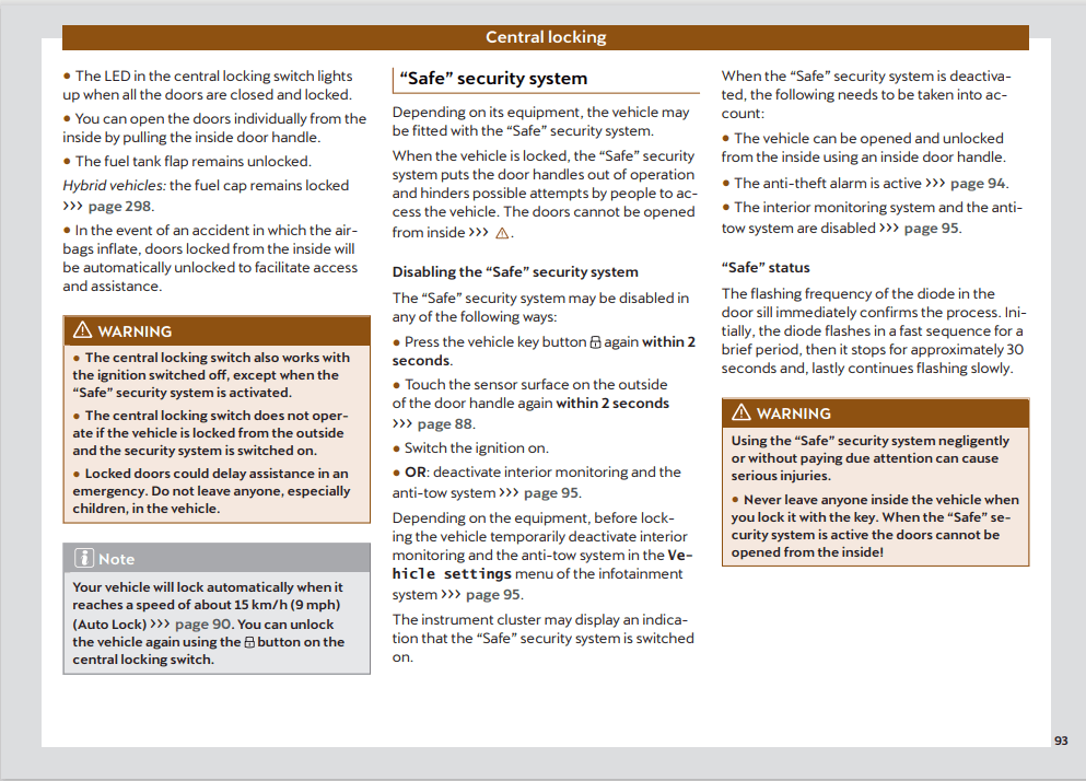

@NickD - if on the rare occasion you do need to lock passengers in the car (can’t think why you’d want to, but there may be legitimate reasons for doing so), then as @Richiepoos has explained, a double press on the lock button on the key fob should lock the car without deadlocking it. If those passengers then need to get out of the car in an emergency situation, they should be able to open the doors from the inside. There should be a section in the Owner’s Manual covering the safe lock system (I think Cupra may call it Safe security system).

Thank you for educating me.
I can see this makes some sense now.
Unlike someone else who replied, I don't want to lock anyone in the car, it was just a case of me locking the car before my wife had opened the passenger door and she couldn't get out.
I did try the double lock option on the key and it does work, so thanks for that.
I hope you can see my side of things: -
I get out of the car first. I usually drive solo.
I lock the car as I usually do, as soon as I get out.
My wife is still in the car and hasn't yet opened the door.
She is unable to get out of the car.
If someone breaks into the car and can't unlock the doors from the inside, they have already gained entry (albeit by climbing in).
I'm a bit on the fence with this one, but at least now I know it's not a fault, I just need to ensure I don't lock the car until it's void of passengers!
