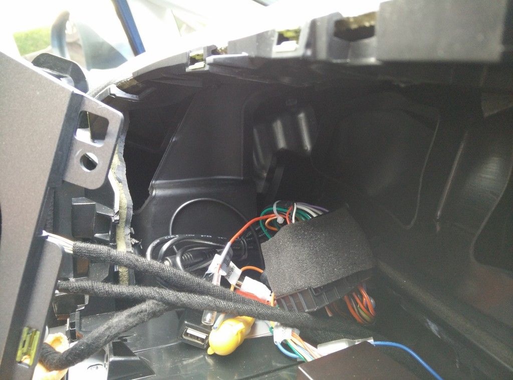

Just need to tidy the cables up abit now.
You can see the section in the dash that the cables need to be fed through. It's the triangle shaped hole closest to the front of the dash... Just push through there and feed through the light hole.
