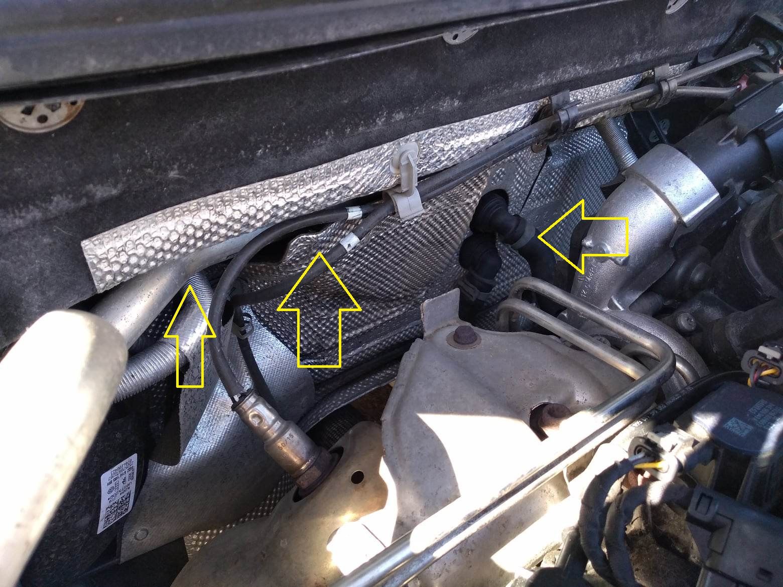

That's interesting, could you send me a photo of the piping you movement. I guess you just moved them a few millimeters?
Sure. It's right behind the engine. I think it's two alloy pipes going into the bulkhead. I couldn't even tell you what exactly I moved. I was just pulling and pushing things around trying to find the noise when it disappeared. I think it was the metal flanges next to the pipes but I'm not 100%. I'll get pictures later.

Where the alloy pipes go into the firewall, possibly the plastic ones too? I can't remember but it was in that area, I just moved something slightly and the noise stopped.

How did you move them, you just pushed them randomly?
Yes, pretty much. My wife was in the car listening to the noise, you couldn't hear it from under the bonnet. I was just holding things, shoving things around. I think it was something behind that silver foil heat-shield?
There are lots of little bits and bobs connected to the bulkhead and even a slight vibration can be amplified. You need to try and be logical and think about what sort of sound it is, where it might be coming from etc. What does the pattern match up with. I'm sure that most of these lightweight noises are nothing to worry about but you want to know don't you?
