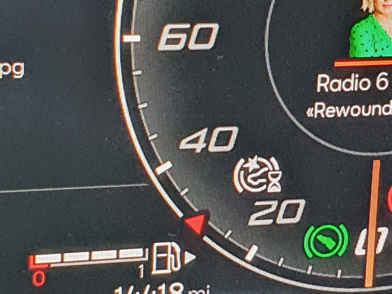

The symbol with the timer and the star? I see it on startup often . I have had a look in the manual but can't see what it means. Can anyone shed some light on this please?

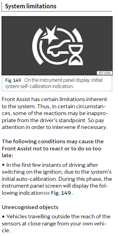

It means the crash alert (or whatever it's called) hasn't quite fired up yet. It's part of the electronic warning system and should clear within 30-60 seconds. But I am no expert...

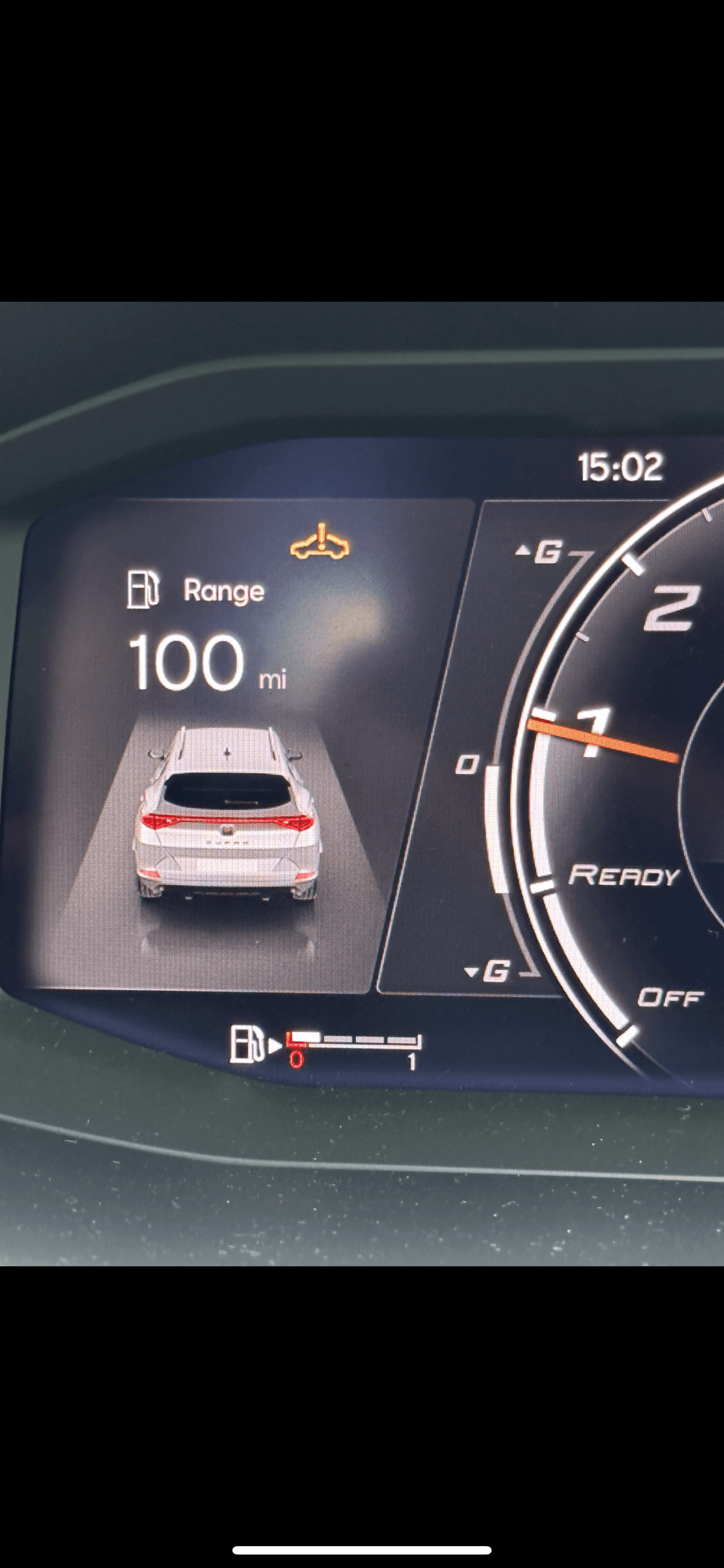

So I’ve looked to see if this new ping fault is listed and I can’t see it
Any ideas?
Switched engine off / on and it’s gone.
Doesn’t fill you with confidence
Any ideas?
Any ideas?
Hope this helps! Taken from the manual.
Drive: Fault! The electric drive is not
working properly. Visit a workshop
The warning lamp lights up yellow.
There is a fault in the vehicle’s drive system.
Drive slowly to a specialised workshop to havethe fault repaired.
Drive: Warning! Power is limited. Check
the manual
Performance limited. The high-voltage battery
may not be sufficiently charged or may have
reached its operating temperature limit, for example in very cold outside temperatures.
