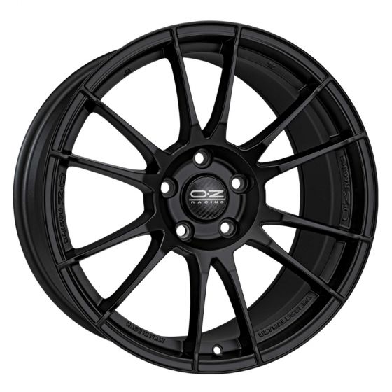

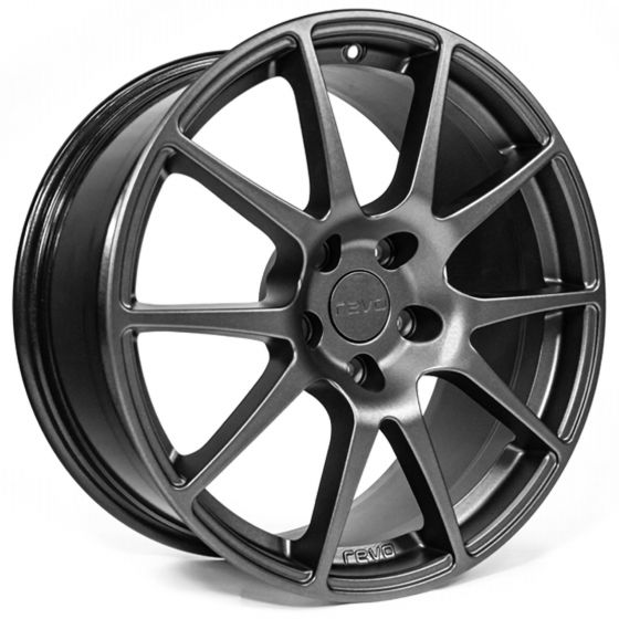

I like multi spoke black rims - so something like the following:
Sparco Assetto Gara (matt black) (£768)
OZ Racing Ultraleggera (matt black) (£1300)
Revo RV018 (anthracite - gloss black is yuck) (£1200)
Probably based on price and the fact that Sparco alloys are made by OZ, i'll probably go Sparco.

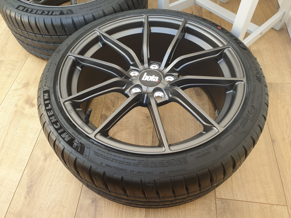

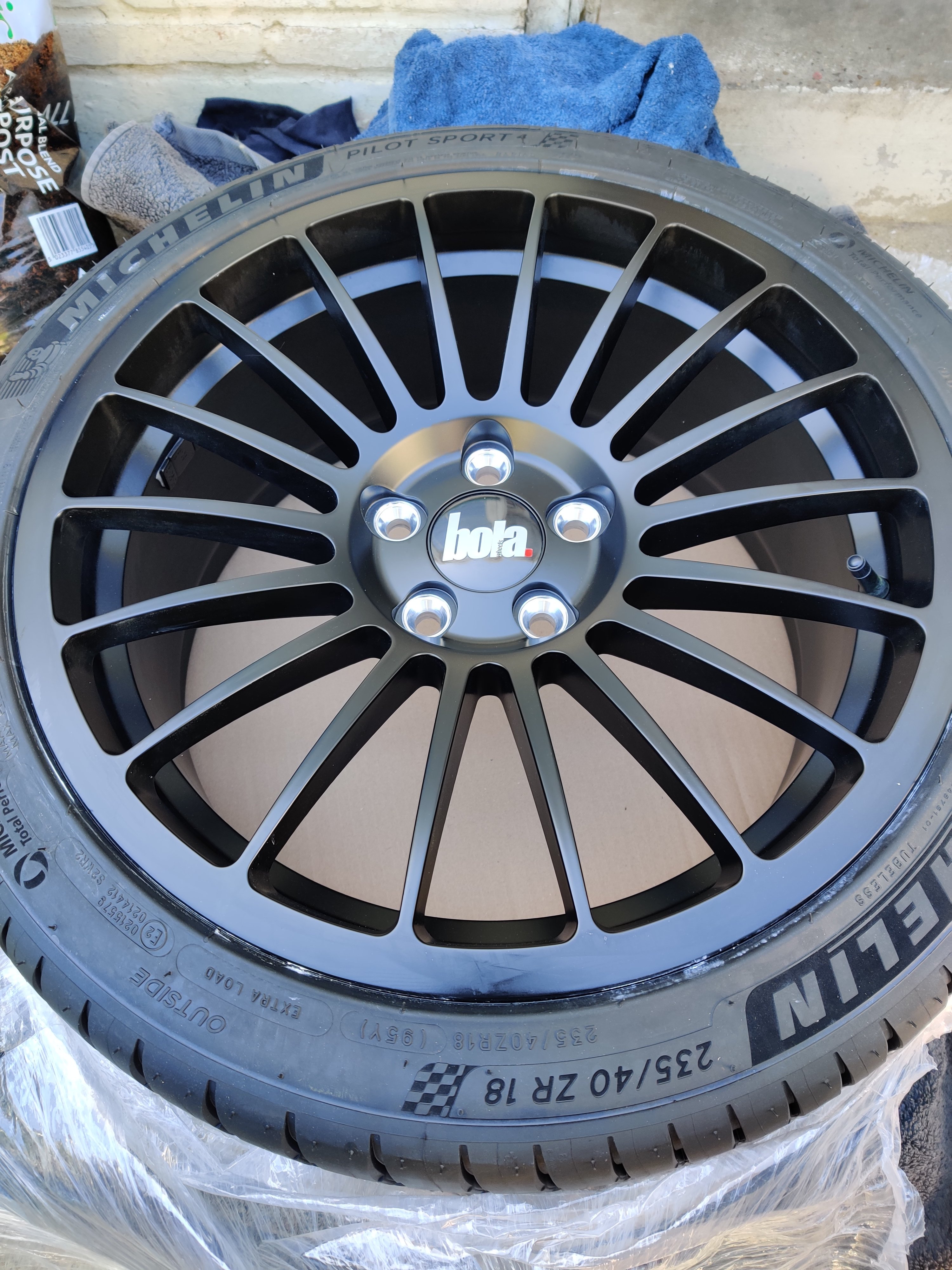

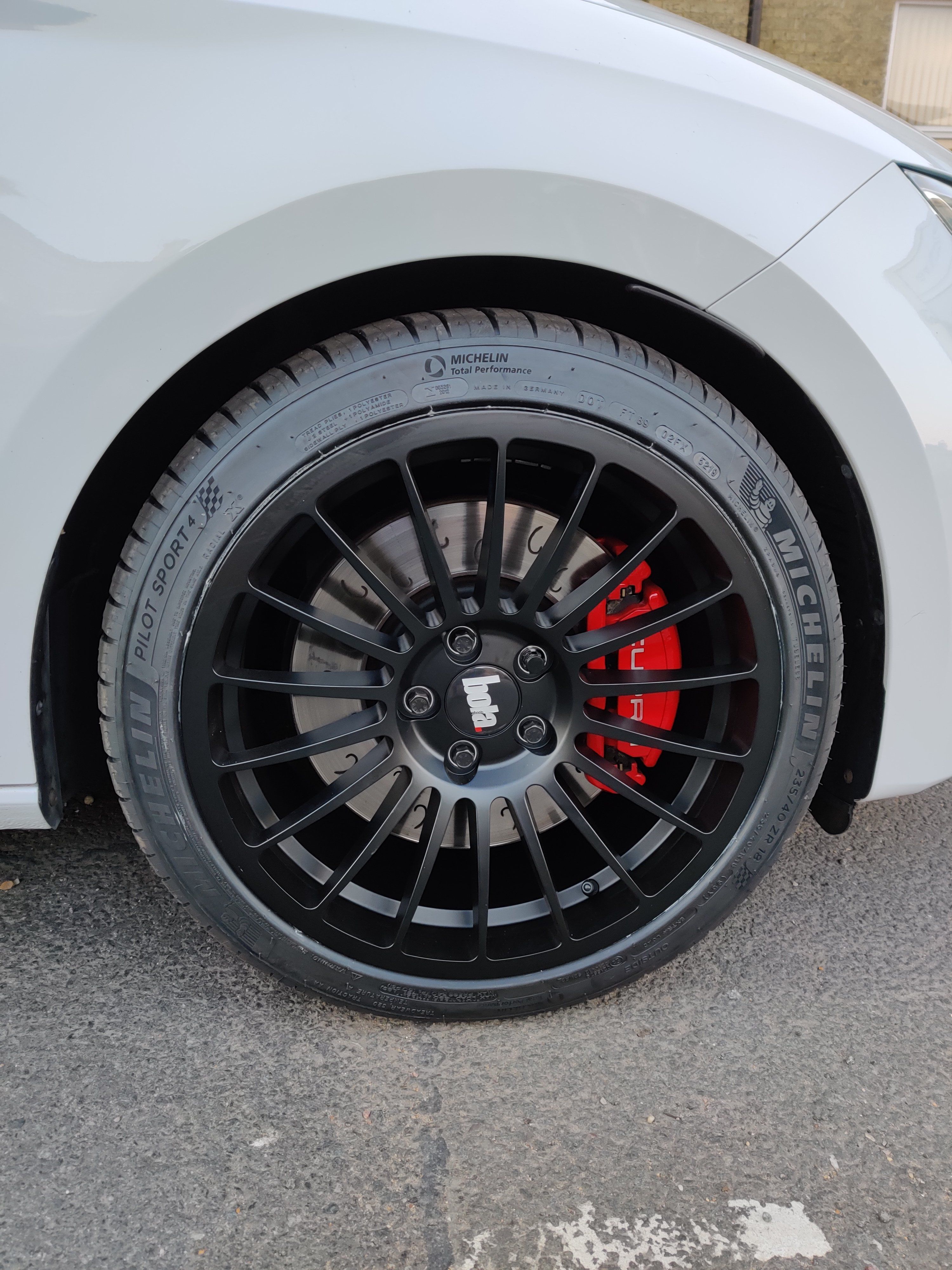

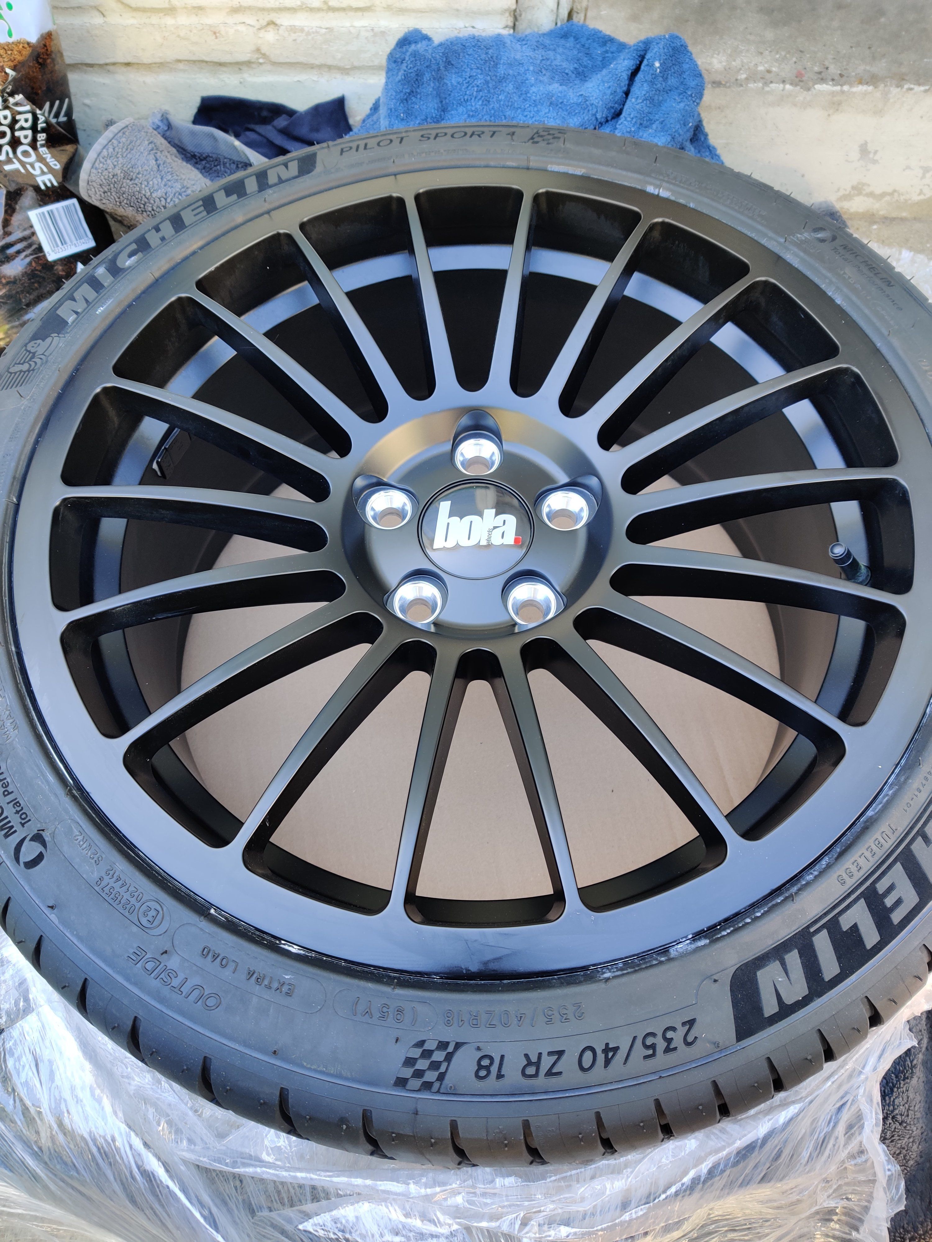

I looked at a few wheels (pretty much those suggested above and Team Dynamics Pro Race 1.3's) and ended up with Bola FLC's in matt gunmetal, 18in x 8.5 ET45 (£755).
As mentioned above, I was looking for lightweight - these were advertised at 8.2kg and I have weighed them myself at 8.1kg. This is really impressive for the size.
I then got them fitted them with Michelin Pilot Sport 4 S tyres (my scales claim 10kg for these, 18.1kg total) in 235/35/18.
I am really happy with them so far, they look great. Not gone on the car yet but will be soon :).

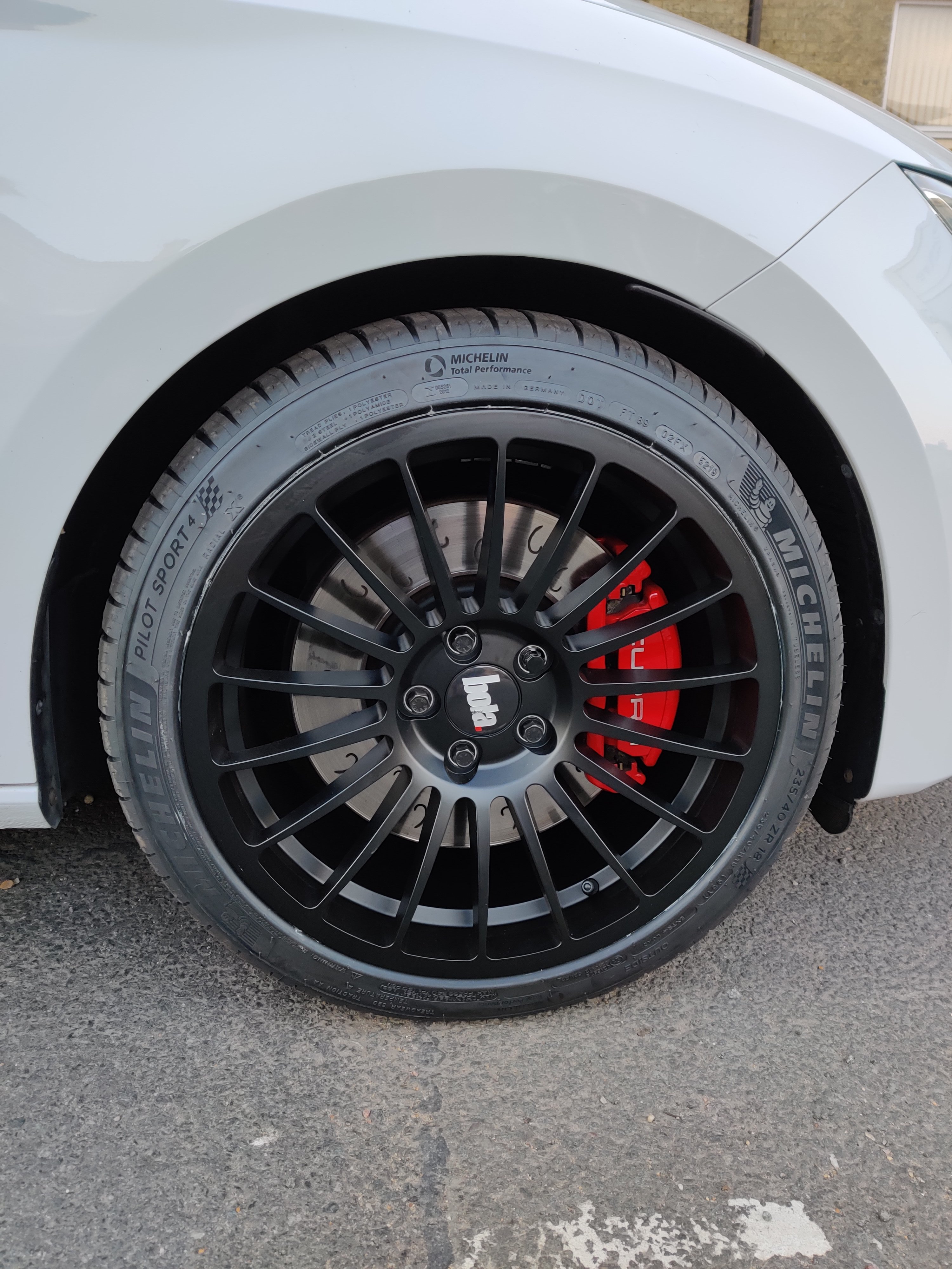

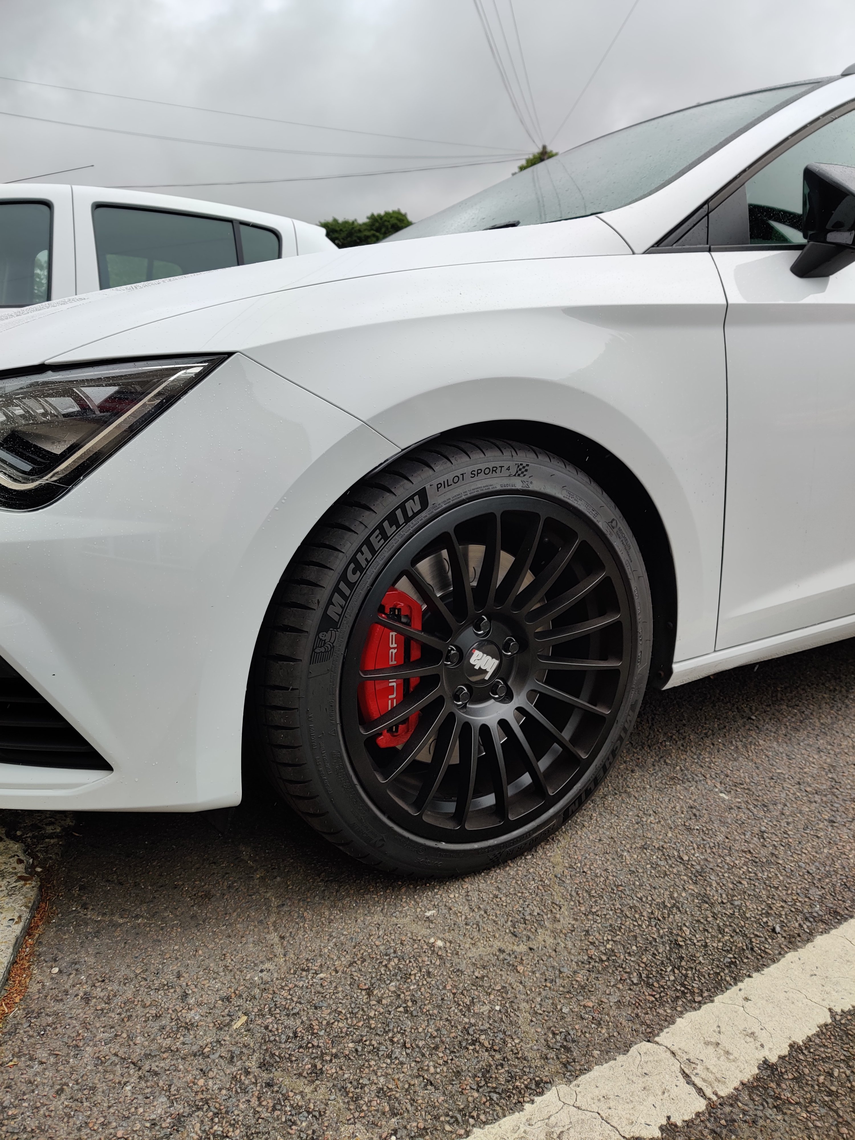

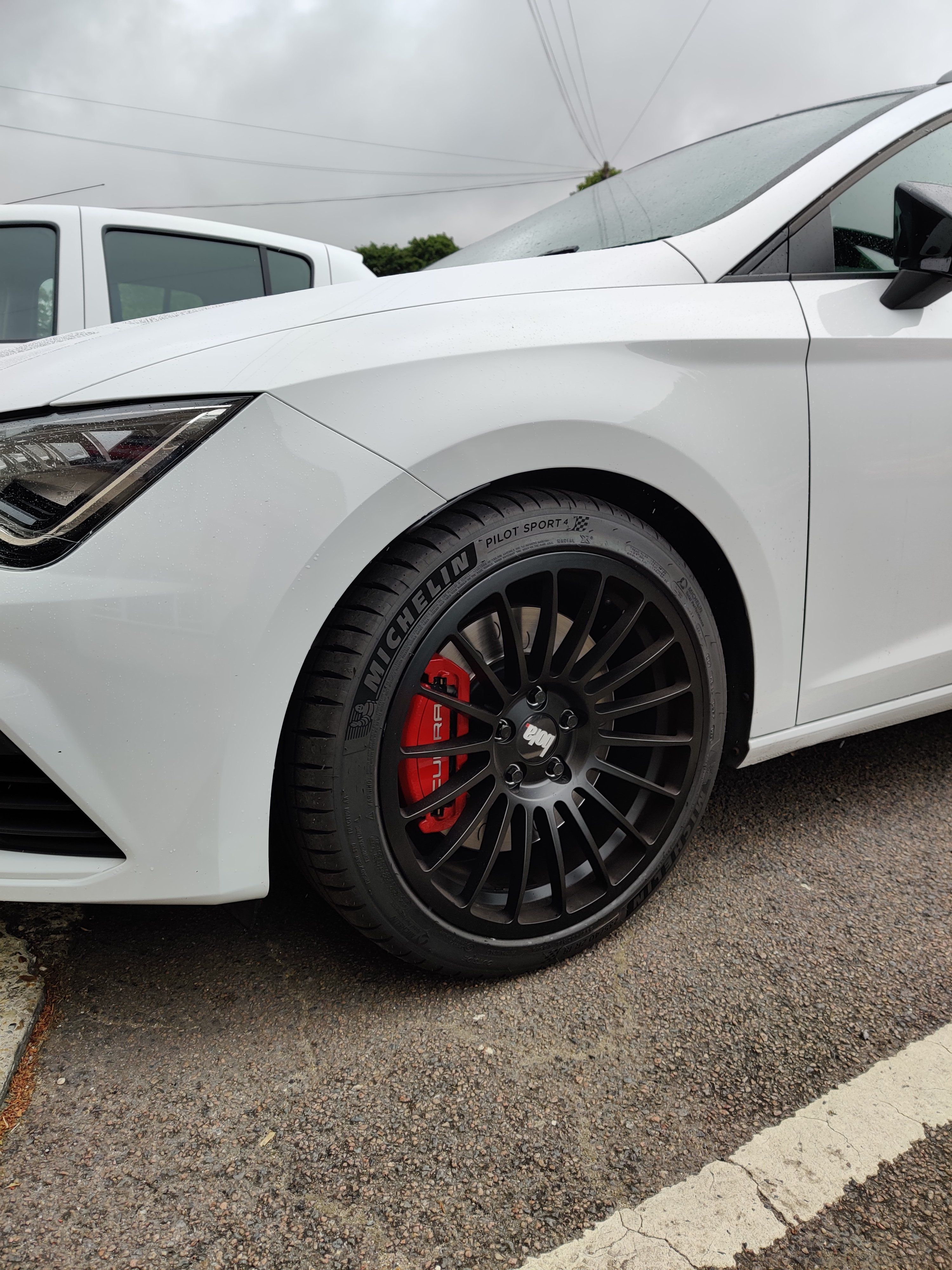

So i did it.
Bola B14 18in Alloys wrapped with PS4
I think they look great and have made a vast difference in comfort over bumps, cracks and small pot holes.
Got some all black metal bola centre caps coming too to make it more stealth....
