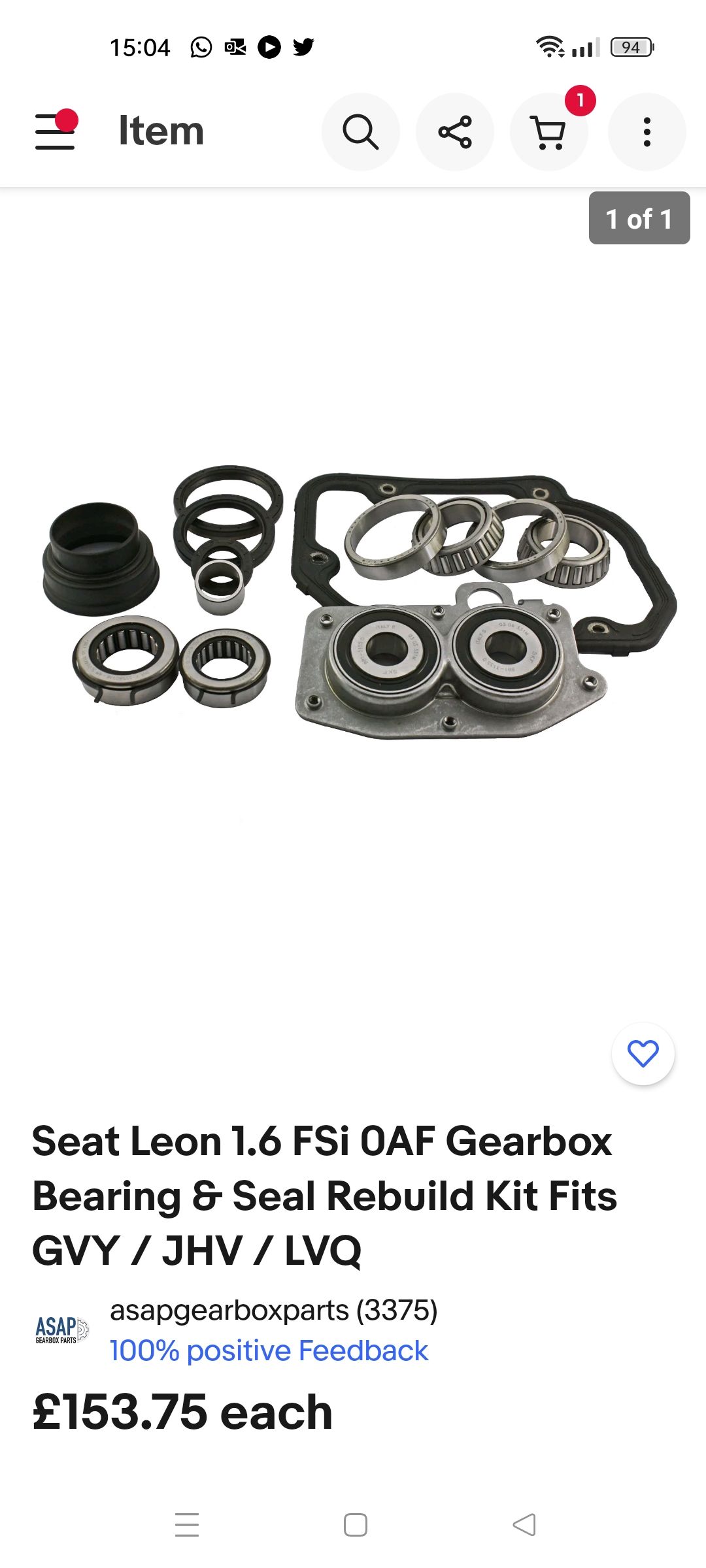

Is buying a rebuild kit a land getting it fitted a cheaper/viable option?
Down where i live we have a local guy who everyone uses to rebuild gearboxes, in southwales his name is john the box.
You are best searching google for a local gearbox rebuilder close to you. Possibly cost a few hundered quid to rebuild i would have thought. Jist a matter of getting the box off a dropping it to a place.
If your only keeping the car a year and it changes gear fine, i would be inclined to leave it and sell it on to a garage at a later date.
Your other option is to buy a used gearbox from ebay loads of 0s2 gearboxes on there from 350 to 500

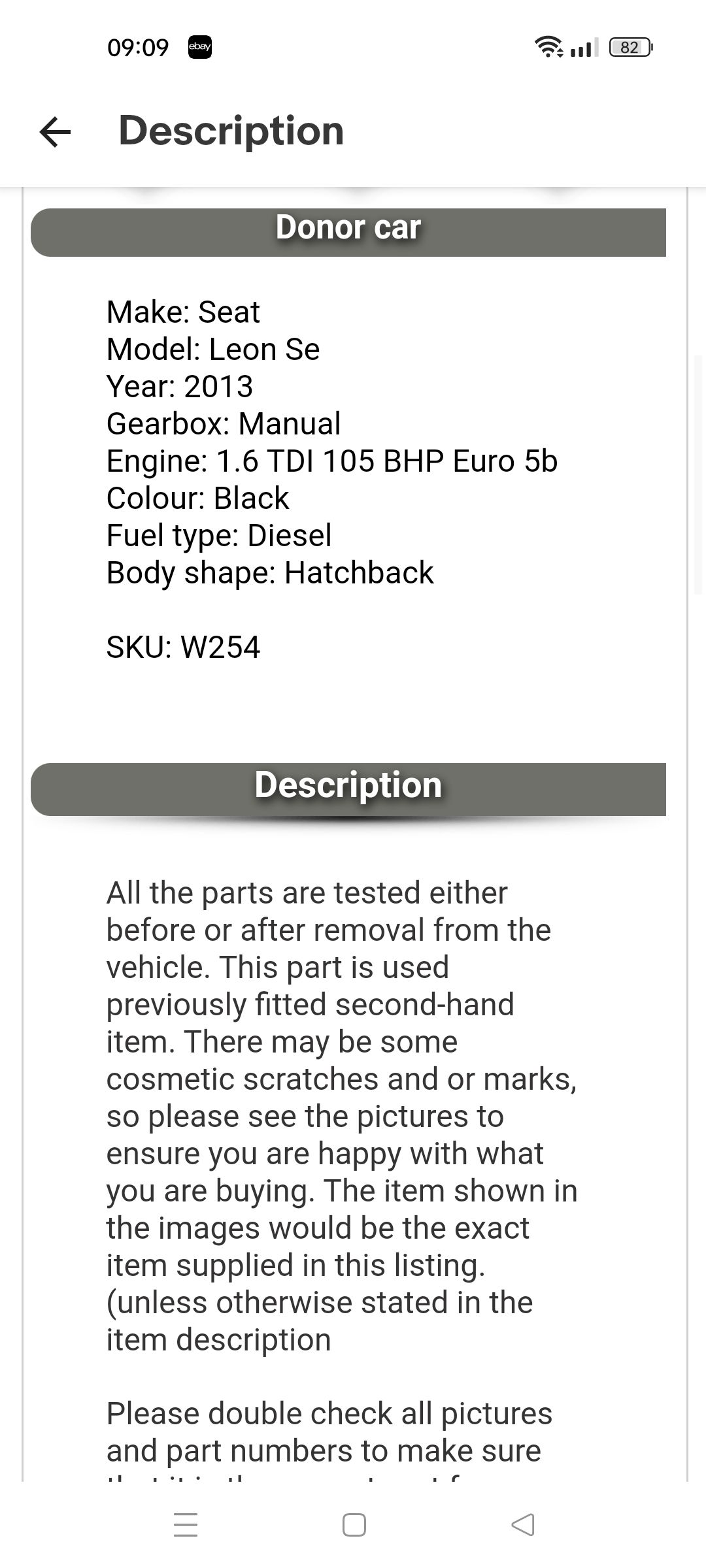

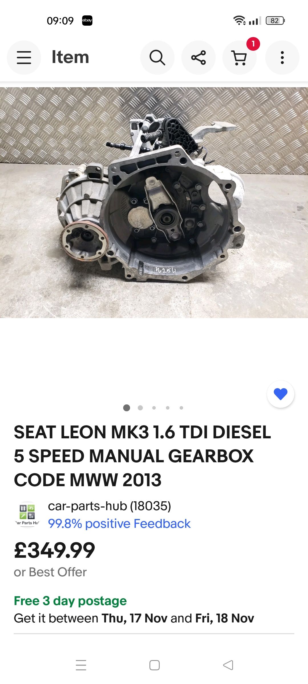

I've took your advice and had a look at a few on eBay. This one in the pictures below is £315 on offer from a car with 94k miles. It matches my car specs and BHP. Enquiring with a mechanic a rough estimate of how much/how long he thinks it would take to swap them out.

I've bought a gearbox from a big/well reviewed breakers on eBay for £350. It matches the car exactly, as well as the engine code. It's from a car that had 54k miles, so hopefully have a lot of life left in it. They don't test the gearboxes, so just got to hope that it works and there's no issues. Have a mechanic that can for it for £500 cash. Thank you for all your messages, much appreciated 👍
