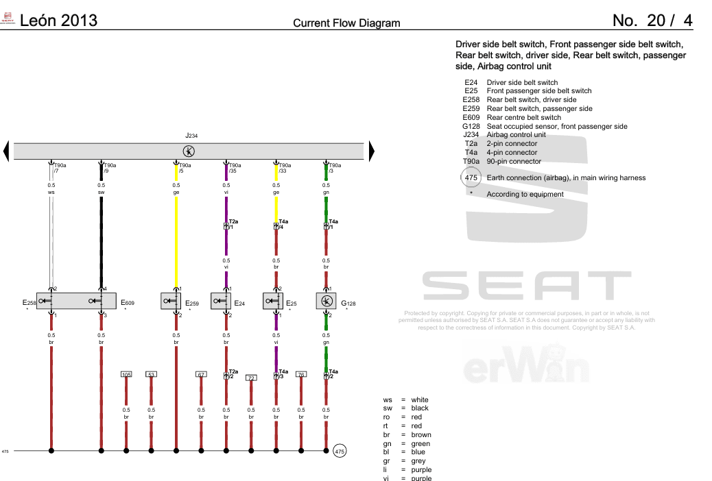

Does anybody had the wiring diagram for the passenger seat sensor (front seats).
Looked through my workshop stuff and could not see anything.
I have a spare sensor but want to connect it up to the car and I have seen some reports its needs a small control unit (but not seen that before).

The links below may prove helpful to you.
First one is a thread I had started, and the second one is one of my posts in OBD11 modifications thread which leads to a happy end where I had succeeded to install & activate the passenger occupancy sensor in my previous car, an '18 Leon FR. But be warned that it was one of the harder-to-manage retrofits.
If you need to ask anything further, I'll be around to offer my opinions & ideas.
