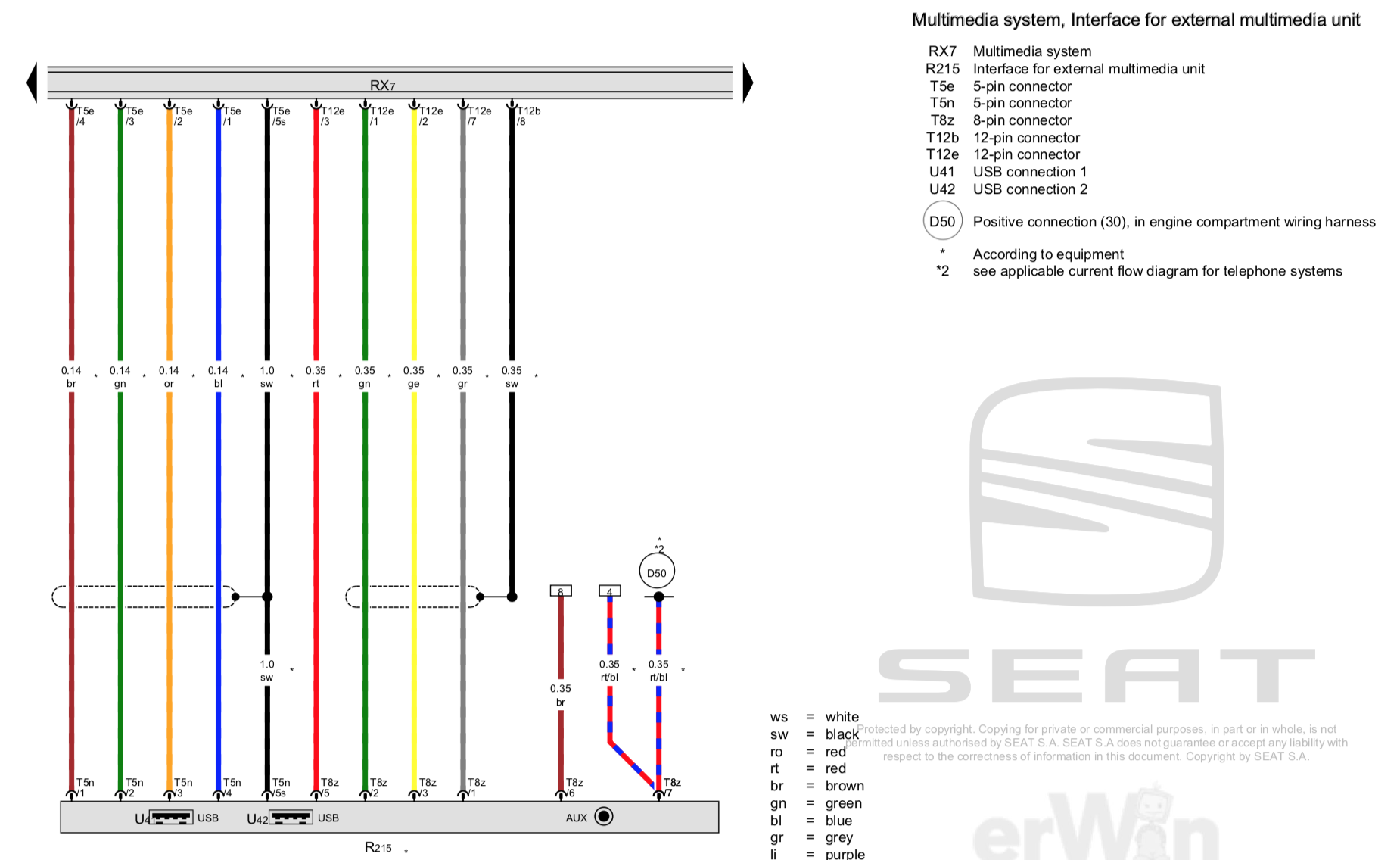

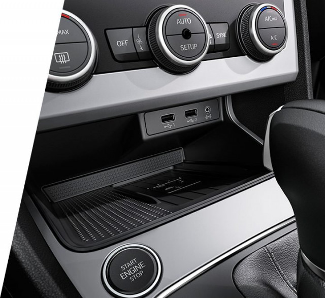

does anyone has the wiring diagram for the double USB connector in the center console, which comes in new Seat Leon? I would appreciate if someone could post it here. THanks!

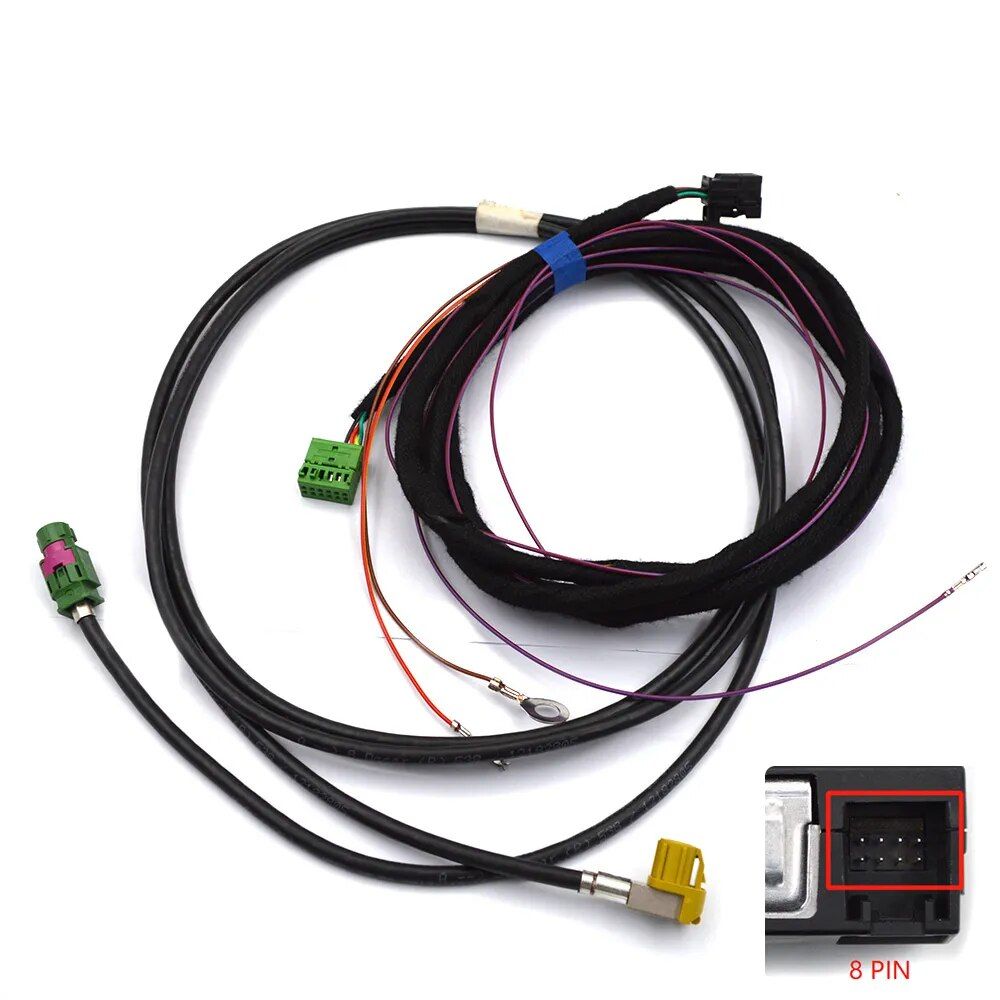

I found the following cable on aliexpress that seems to be perfect for this USB...
But I don't understand where the two loose cables go... I think it needs 12v but I don't know where to put it. Thank you

Hello, do you know which is the P/N of the cable from this twin USB unit pt# 575035736, to the MIB2 unit?
I have an Ibiza, but i guess the cable is the same. Thank you
