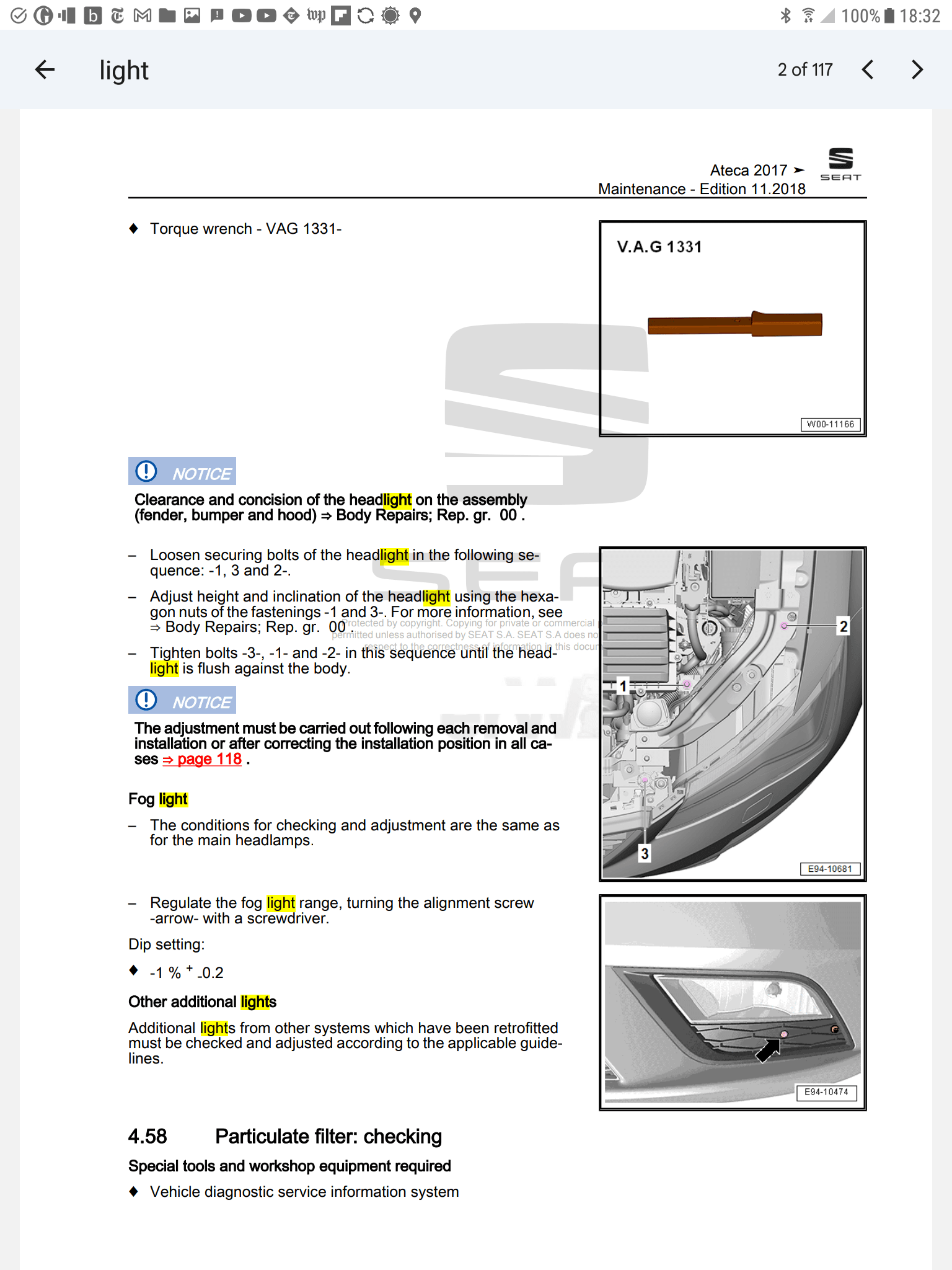

I can't say I've never looked into the process it uses to go from dipped to main beam but certainly does the self levelling when you switch the lights on. That thread says adjust the hex screws to lift up the lights.

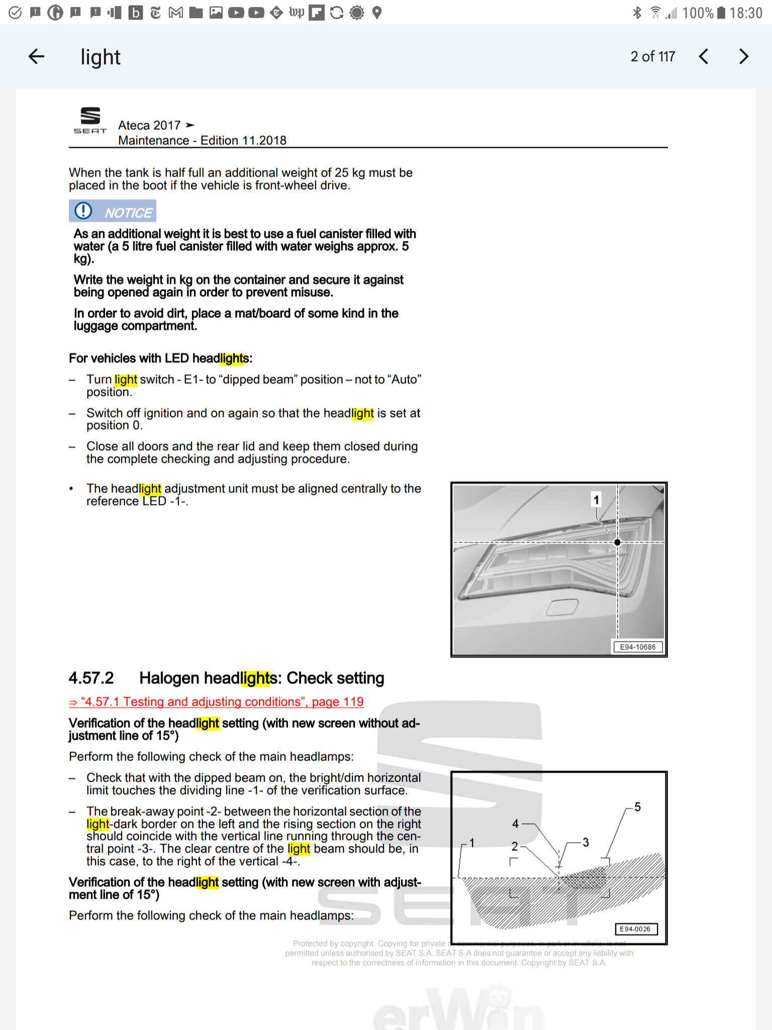

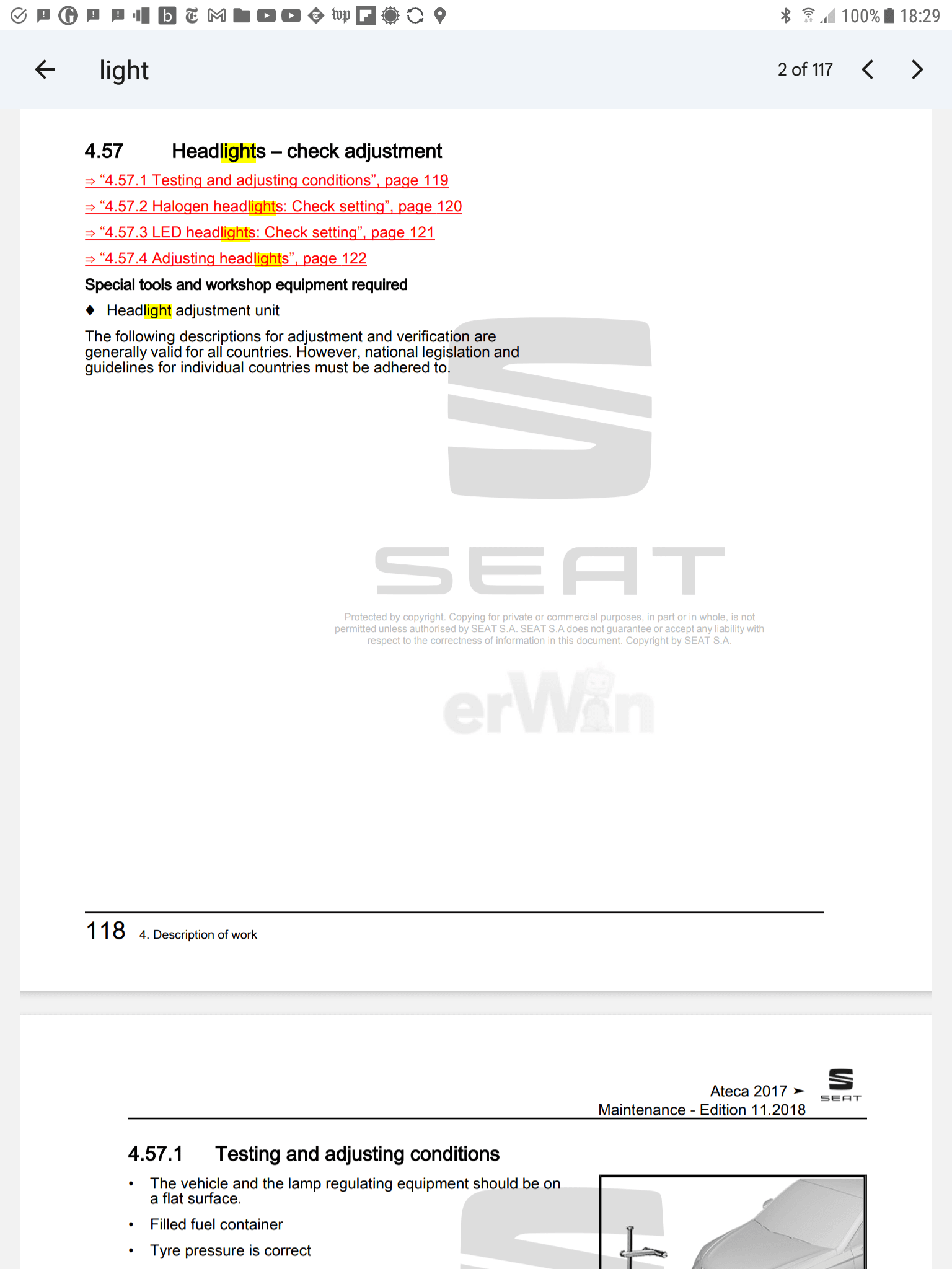

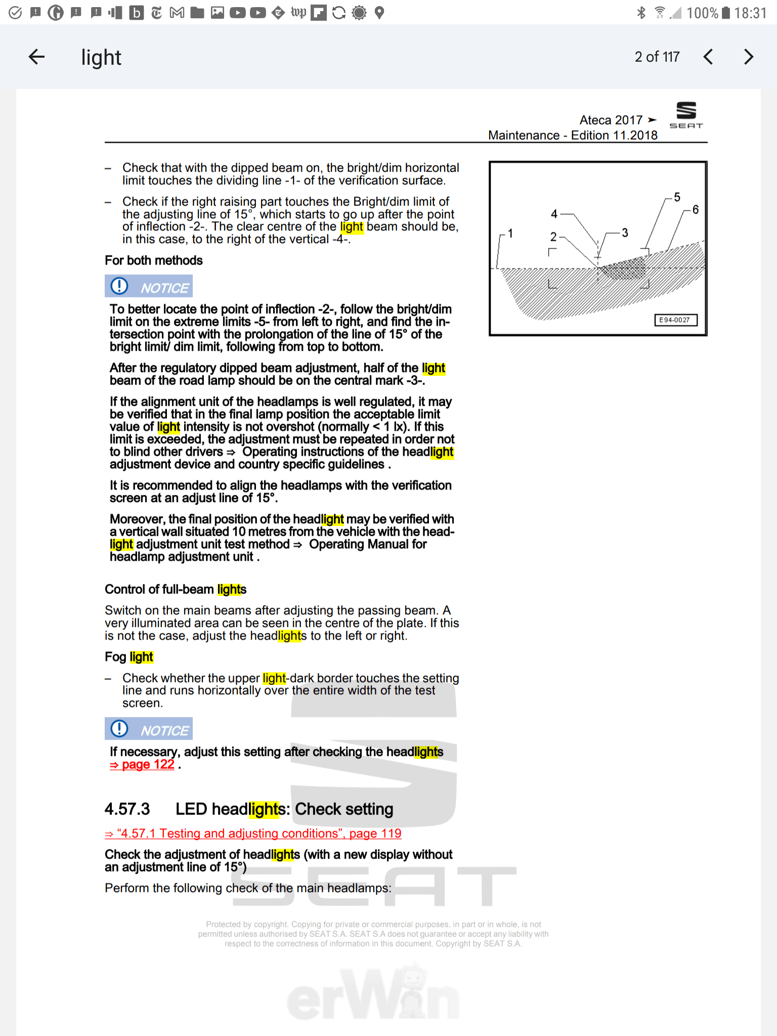

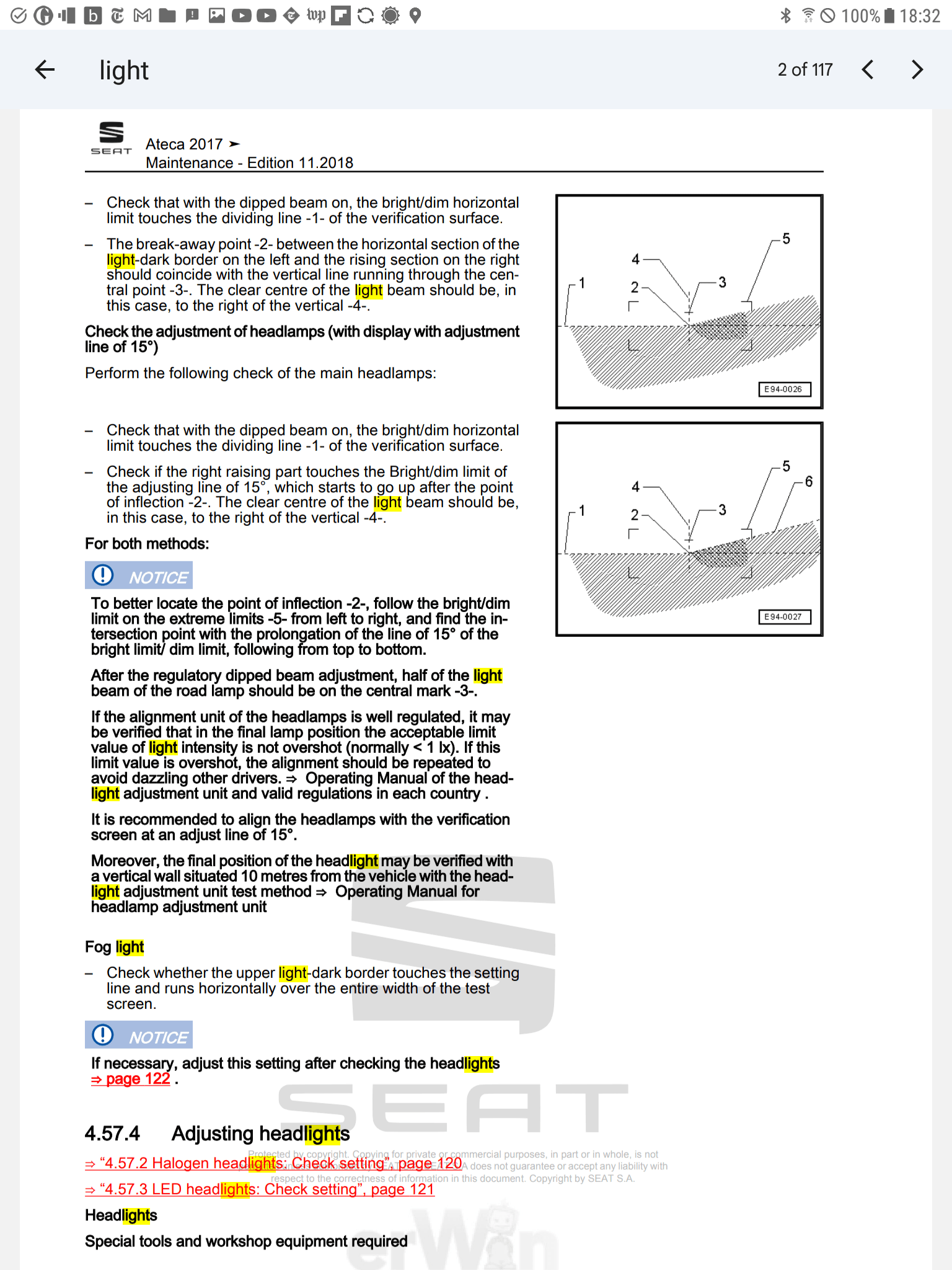

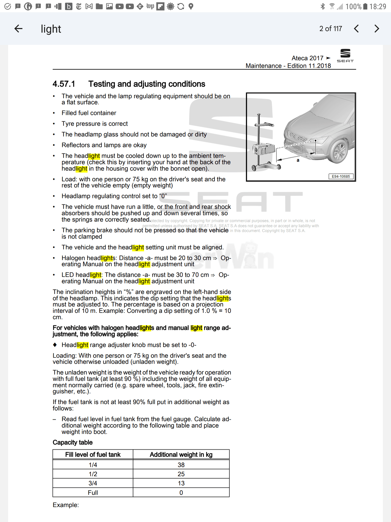

Pages from the Ateca maintenance manual with the celebrated hex mentioned. Erwin material. You are suppose to use the Vag equipment. Probably Heath Robison methods on the board elsewhere. Marked areas on garage walls etc, rings a bell. You would get done at an MOT if it was too high ... Probably. As said mine are fine so suspect yours have been adjusted too low.

The clue to up and down is here
The watch word is what Deano said on the Formentor side, adjust after self levelling. 1/2 turn was mentioned elsewhere and MOT sites are useless if they adjust it....
