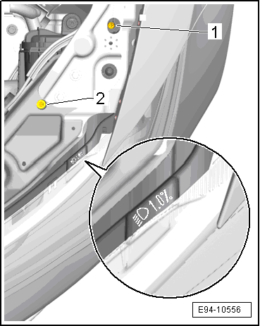

Well there are 2 plastic screws .....one is vertical adjustment and the other one is for horizontal ....which one you tried ?

Maybe this helps
screw 2...anticlockwise raises the beam.

hi, yes thats the one ive tried, im trying to lower them.
Honestly i don't know why it doesn't work ...worked for me thought (but most of us we raised the beam as it was to low rather trying to lower it - maybe its in its lower setting ) as for many other members ...from what i recall ,either from this i don't have any more ideas maybe another member can help out more /have more ideas ...
