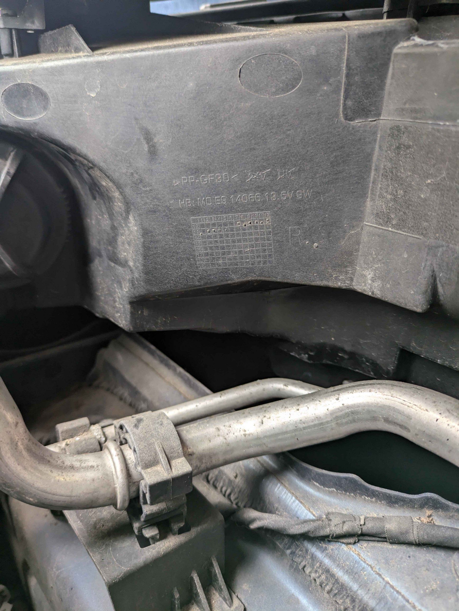

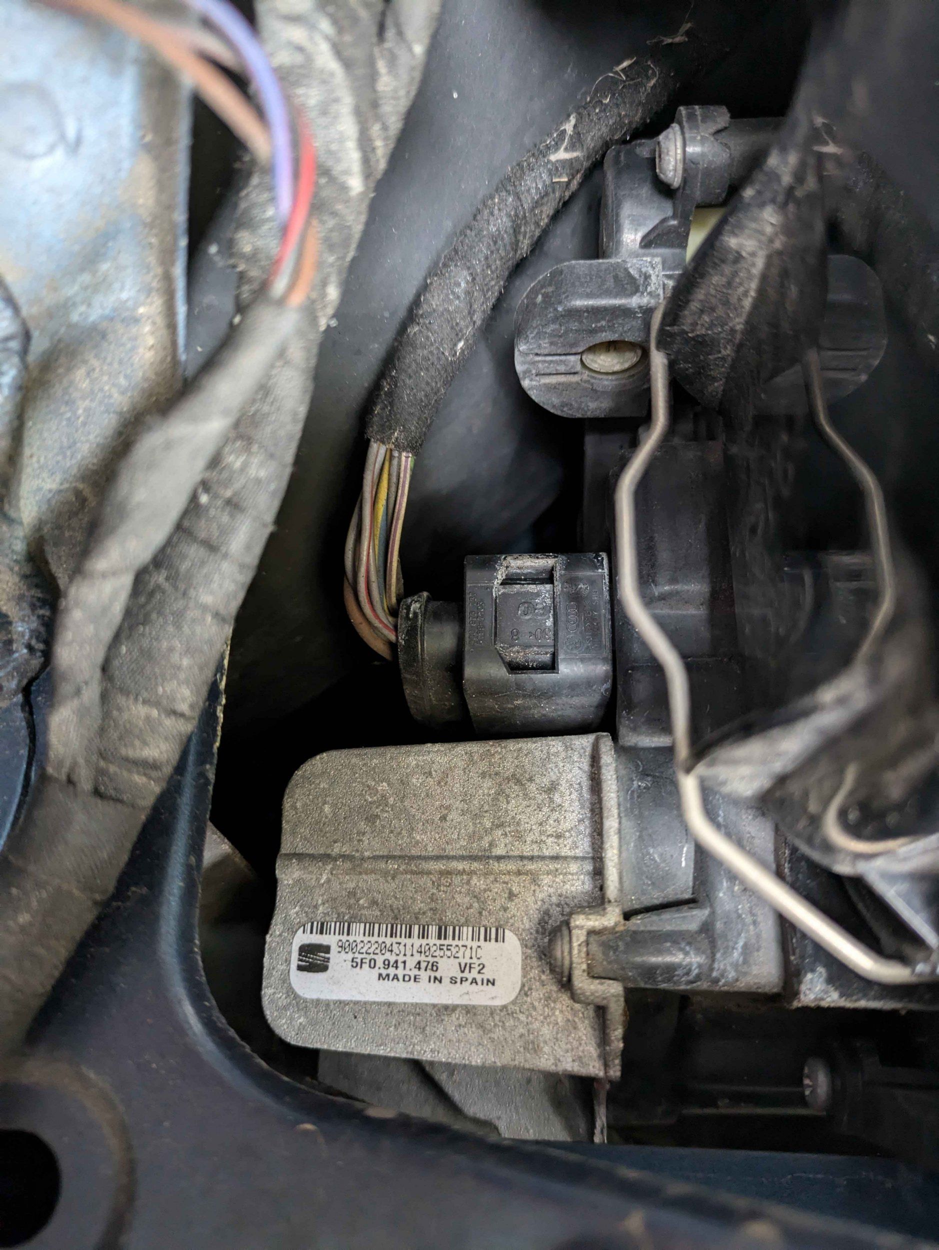

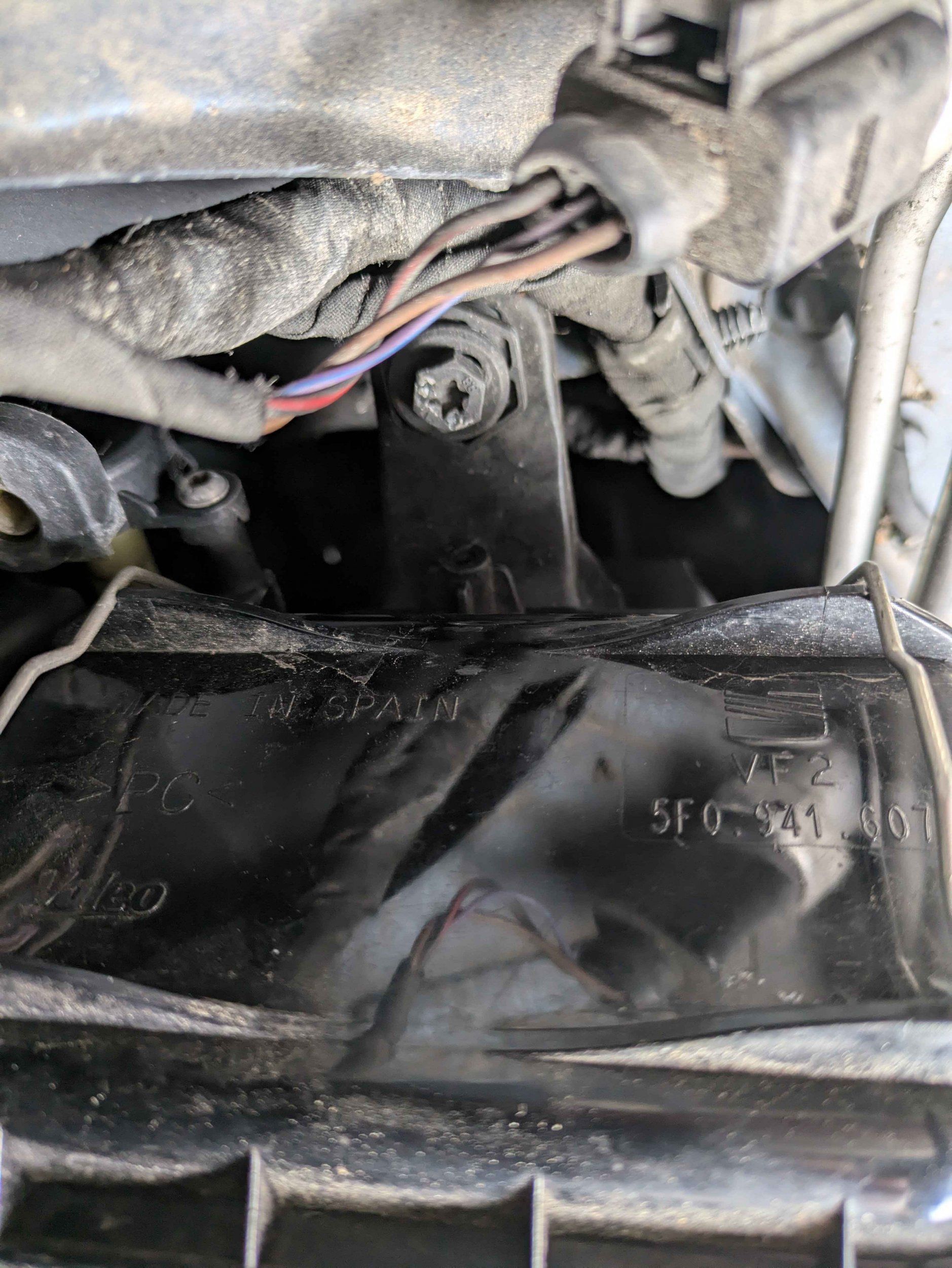

I've attached some photos of the part numbers I could find. I've googled all of them but nothings showing up from my results to tell me if it's for a LHD or RHD car. I would assume the "MD e9 14066" is the headlight part number?

Hi, 5F0.941.601 is your headlamp part number. Quite common thing with them is crack of one of mounting points due to bumper/accident or repleced and not bean installed correctly in this case it may look like headlamp is for wrong traffic on beam tester .MOT tester can tell you if your beam patter is wrong, or as someone suggested ,set them on low/dip beam drive in front of flat wall at night and post picure here . IF only its too high or too low there is chance your level sensor on lower arm is broken . Headlamps in LEON have Symetric pattern beam on earlier models whenever they are LED or not . And in early models driver Couldn't change to travel mode vie IPC or Infortaiment. To lower kick

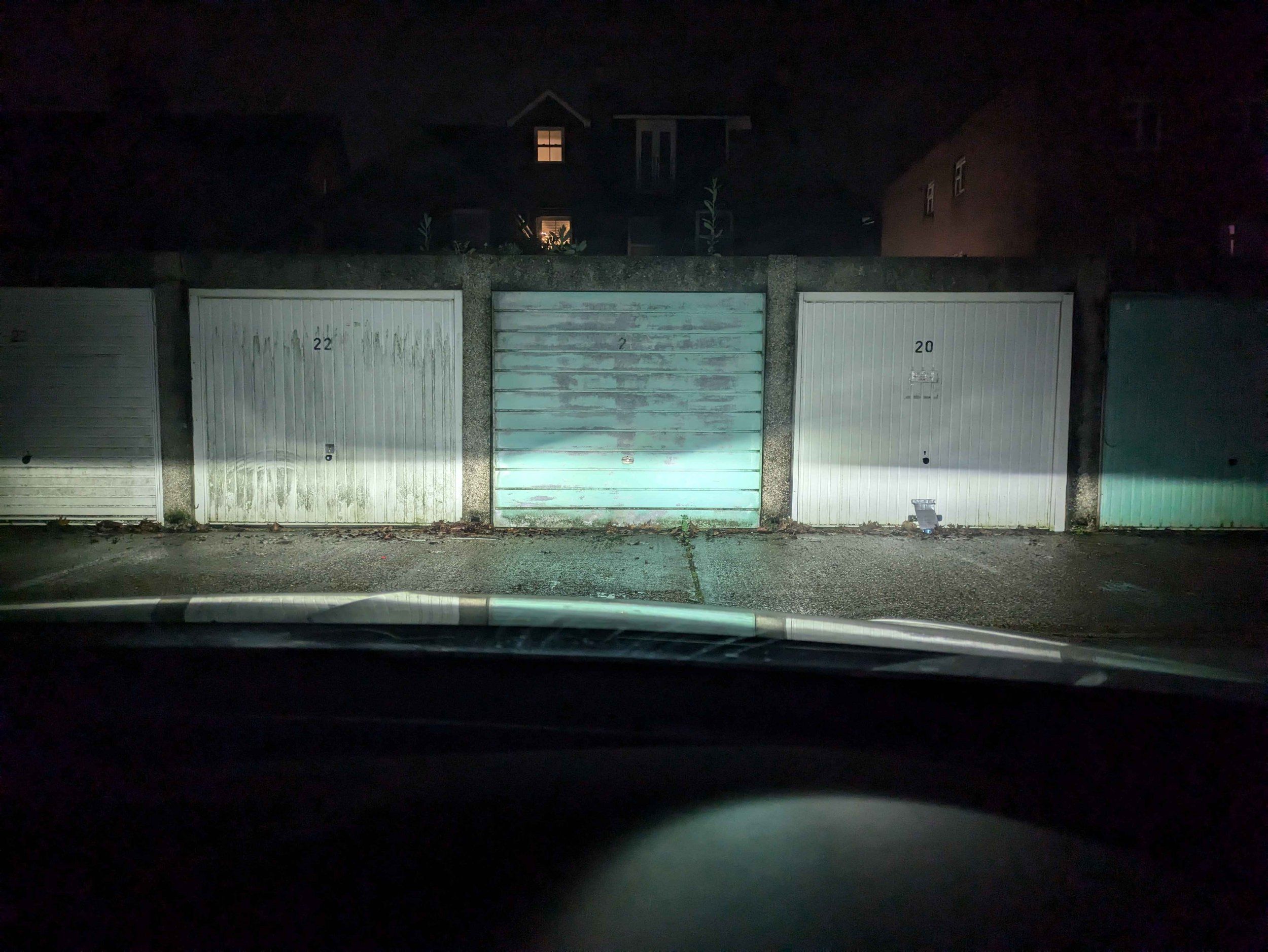

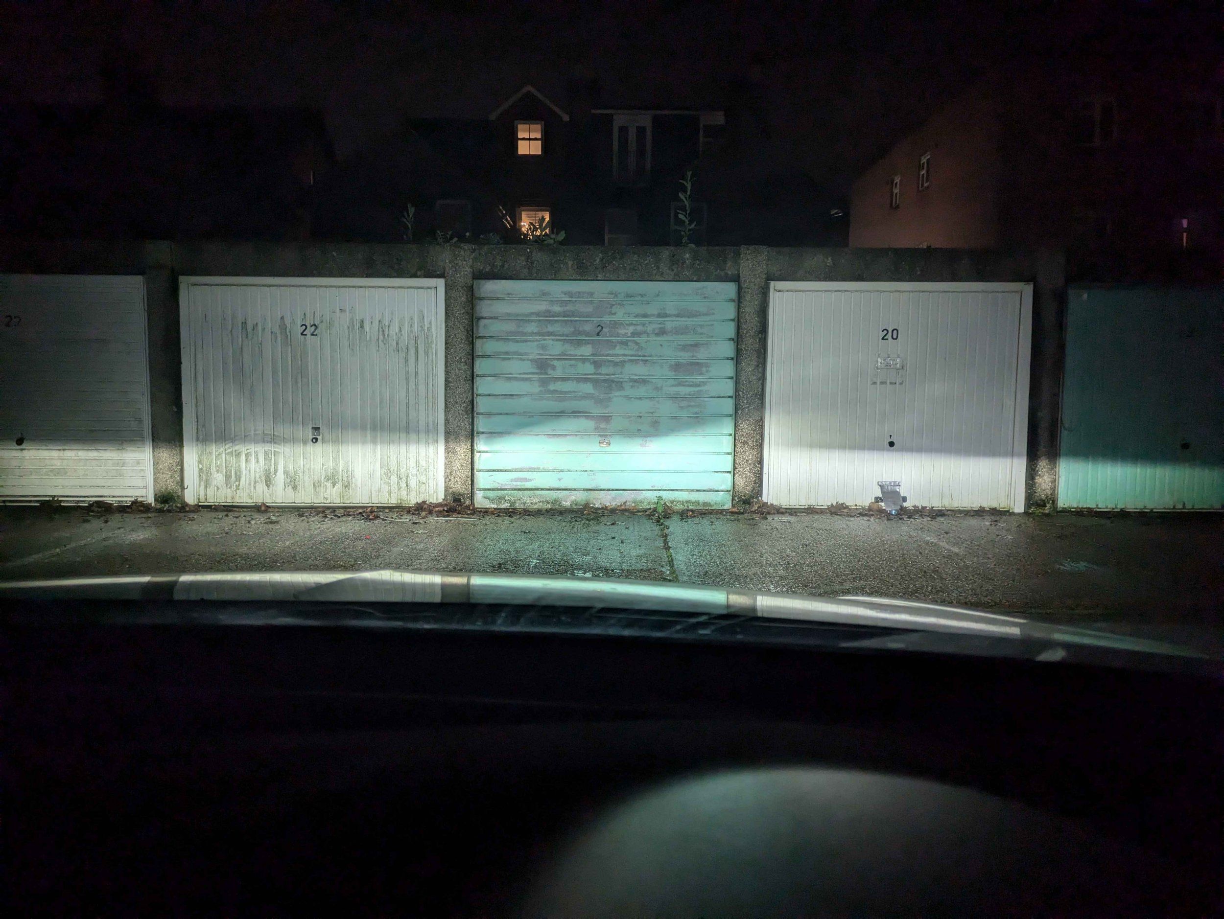

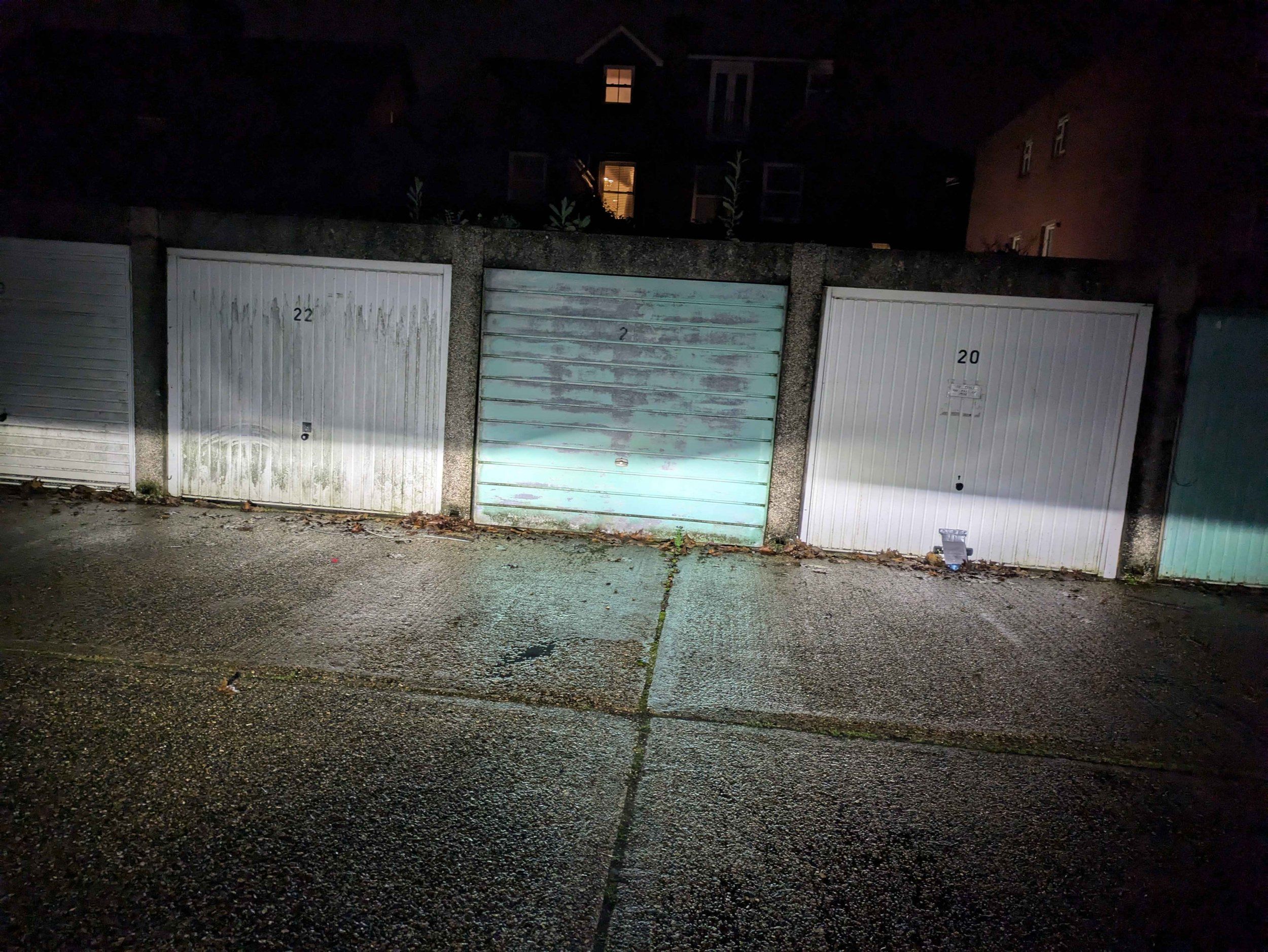

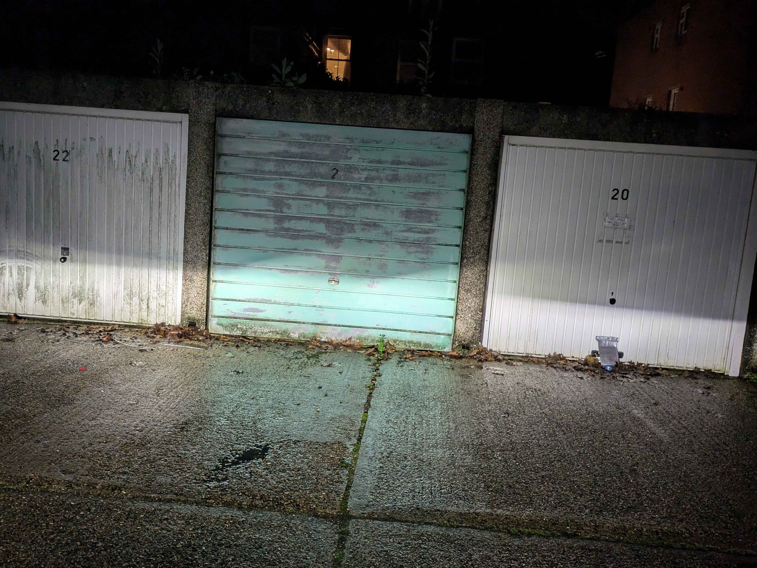

I've just taken some photos, my headlights are definitely not symmetrical when you look at the photos so they seem quite a bit off if they should be.
I took a couple from the drivers seat and then a couple from outside the car.

The part number in the pic is 5F0 941 607 and it's just the cap.
The part number will be on a sticker on the side of the light next to the cap you photgraphed.

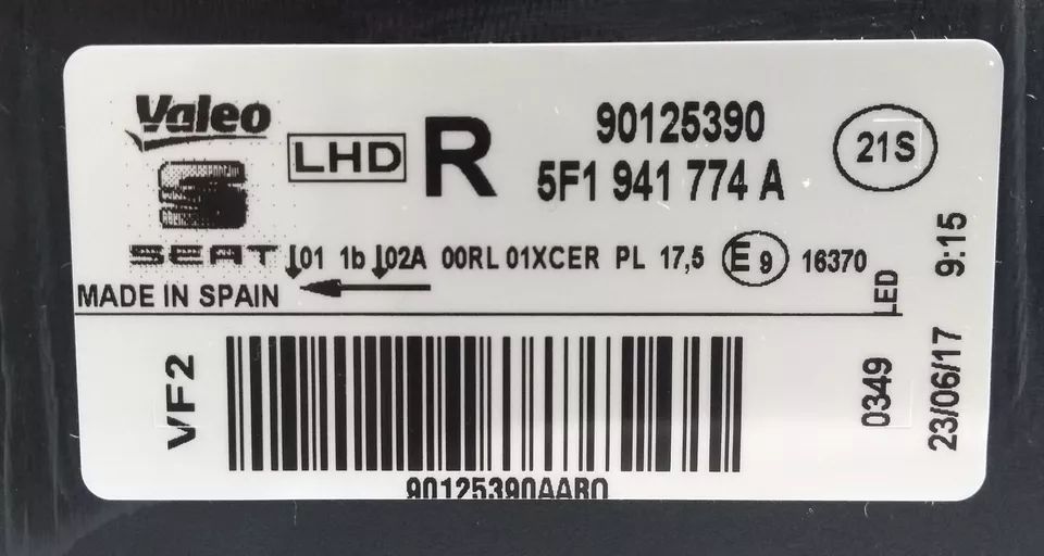

The flick is quite noticeable in the pics, Your headlights "should" be part numbers 5F2 941 007 * for left and 5F2 941 008 * for right. * will be either A, C or D depending on if they have been replaced since the car was made.
It's worth checking you have the correct lights fitted first before trying to diag it beyond incorrect parts fitted.
If yours start with 5F1 then you have LHD lights fitted

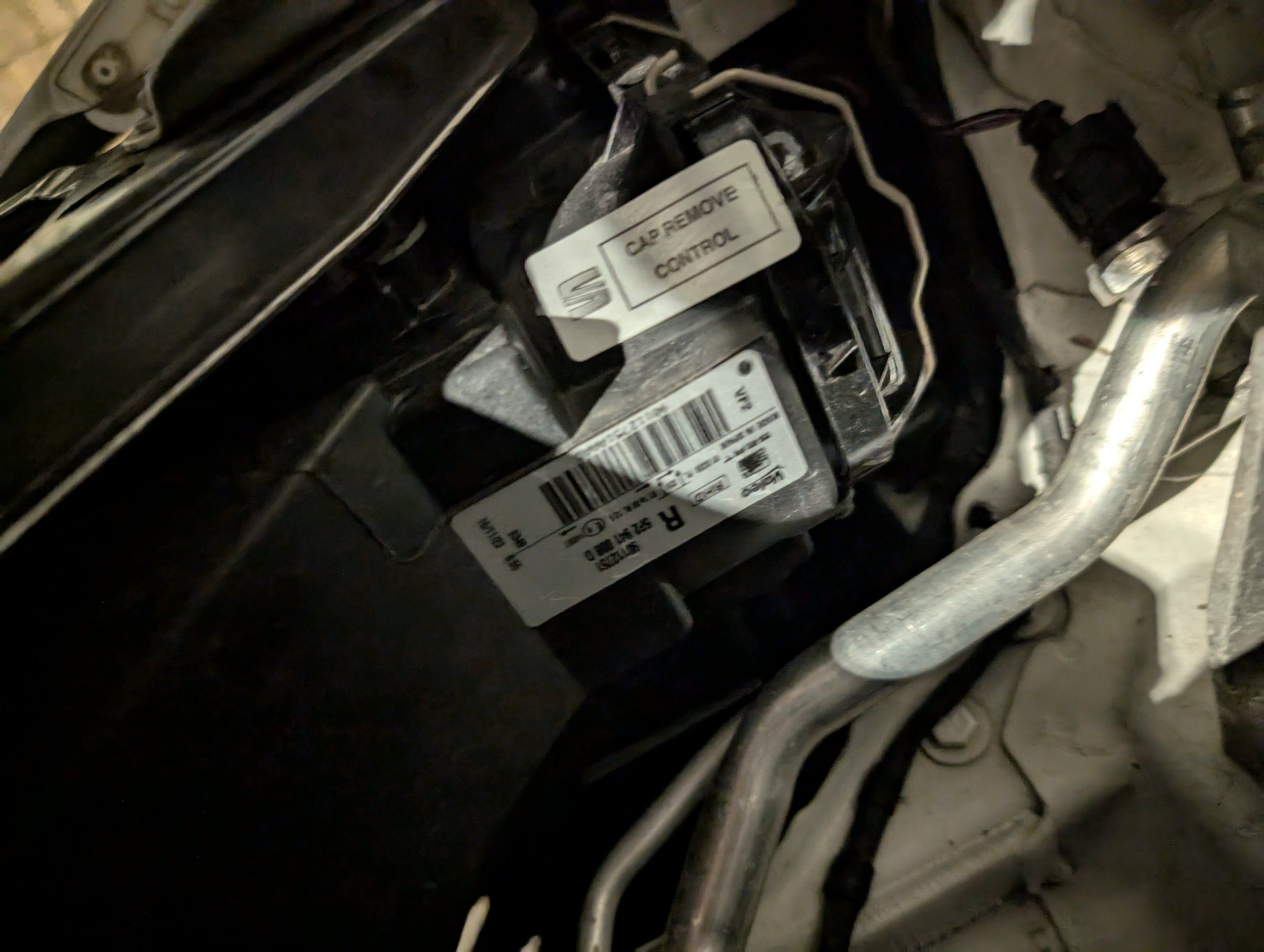

Forgive the bad quality pic but, this is the sticker you're looking for:
You can see my flicks are clearly to the left, which is correct for a UK car

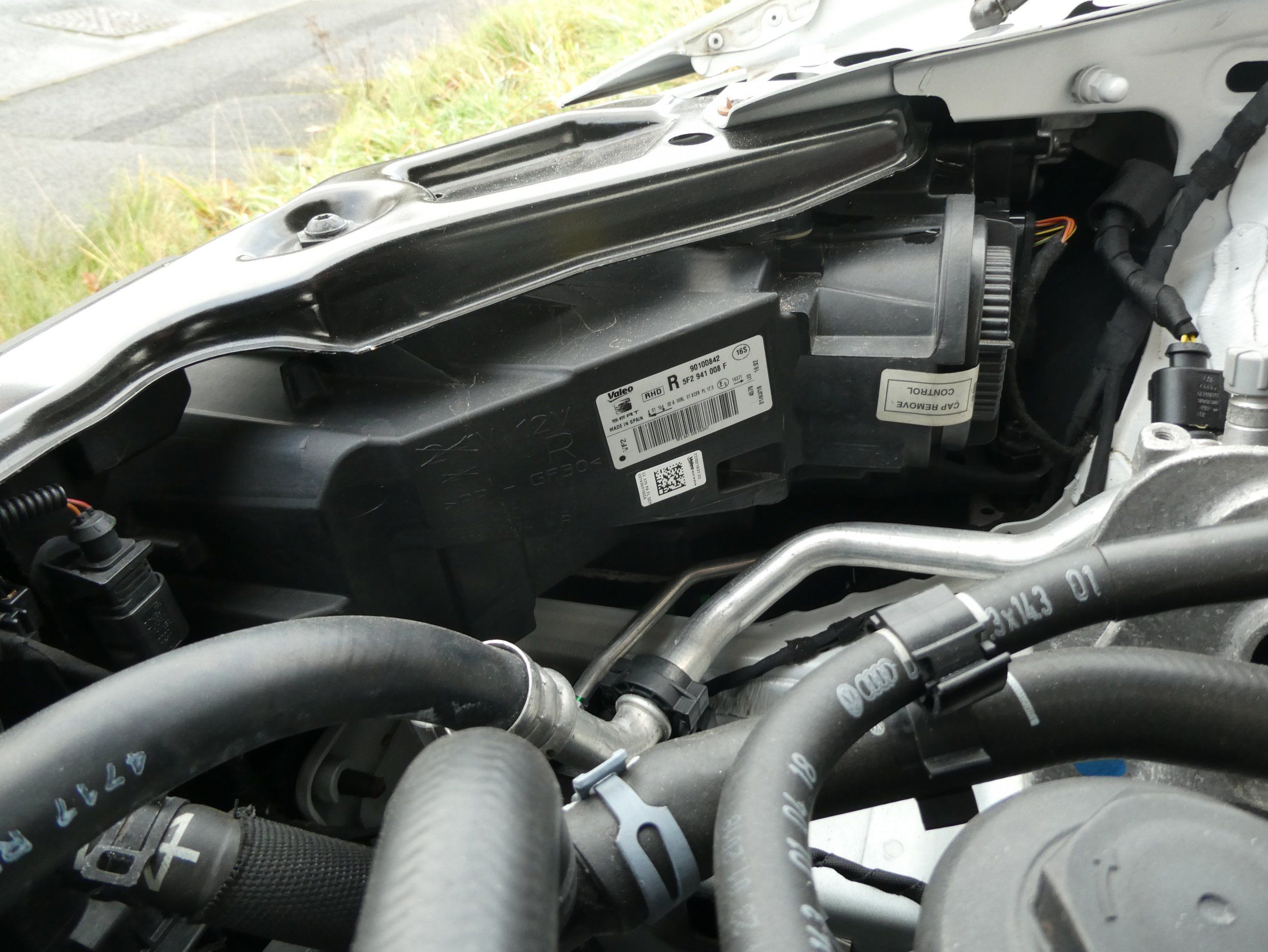

Here is a pic of driver side headlight with bonnet up.
Nothing hidden - sticker very easy to spot
