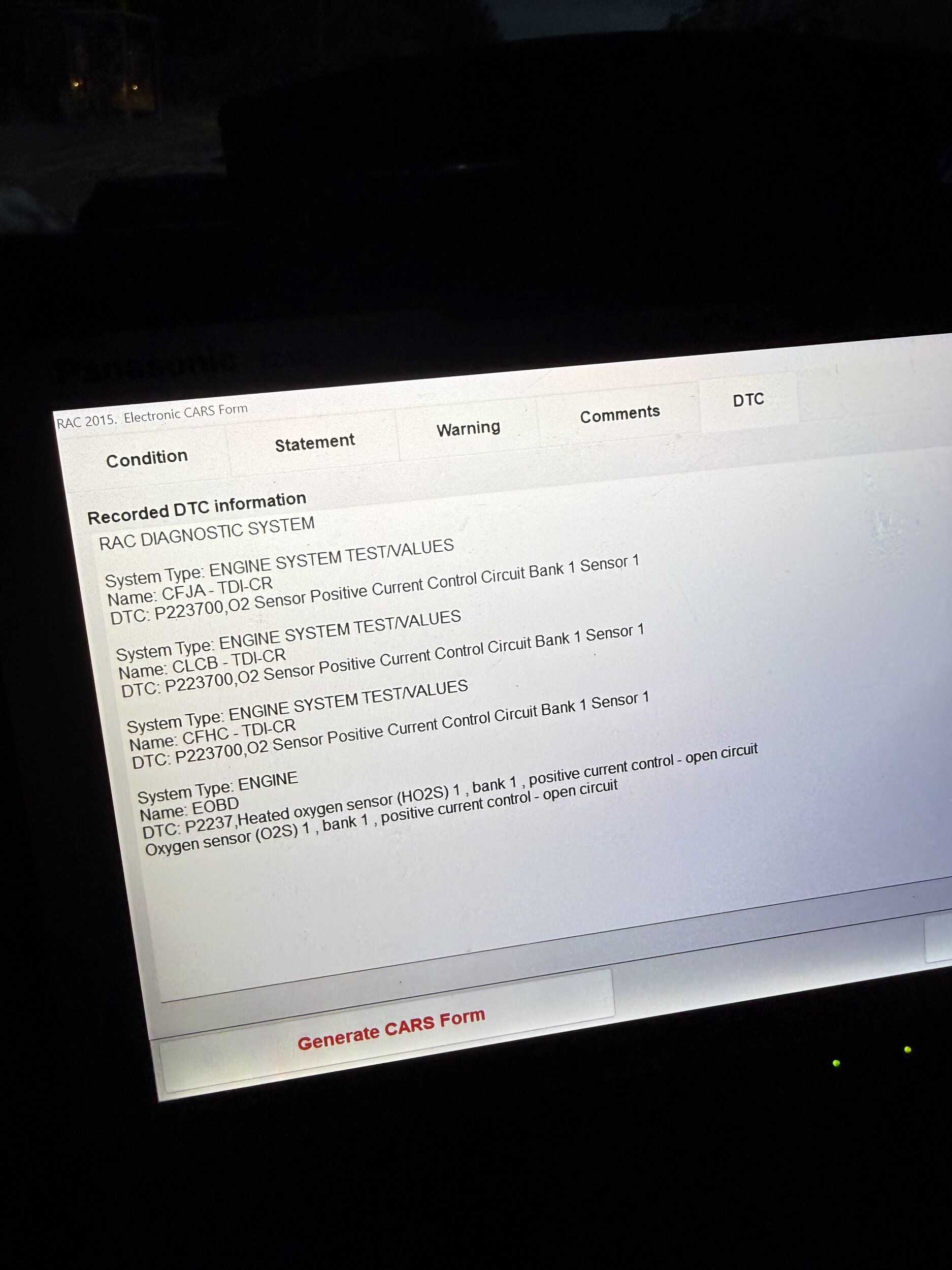

RAC towed it to garage they done a diagnostic test only 02 sensor came back. Been told by the RAC patrol most likely the culprit is TURBO BOOST PIPE.

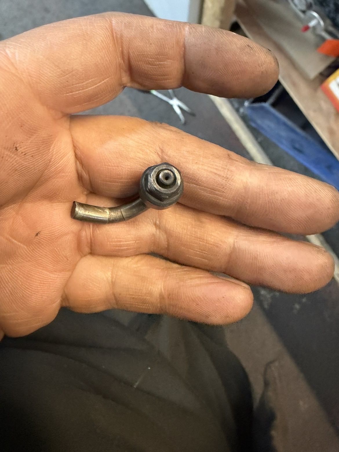

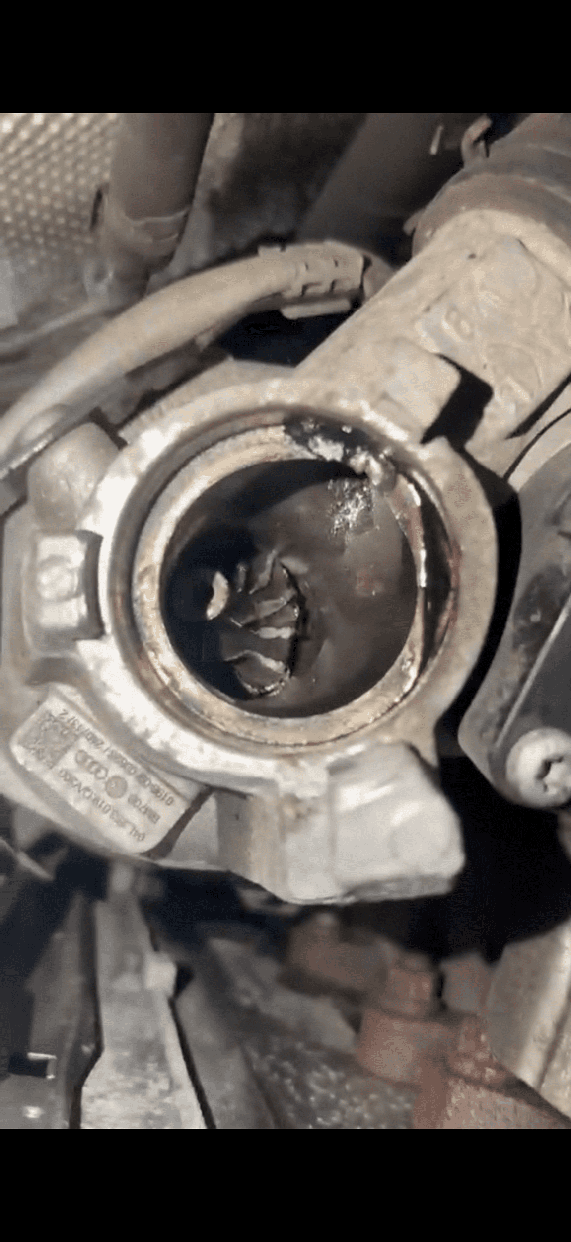

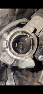

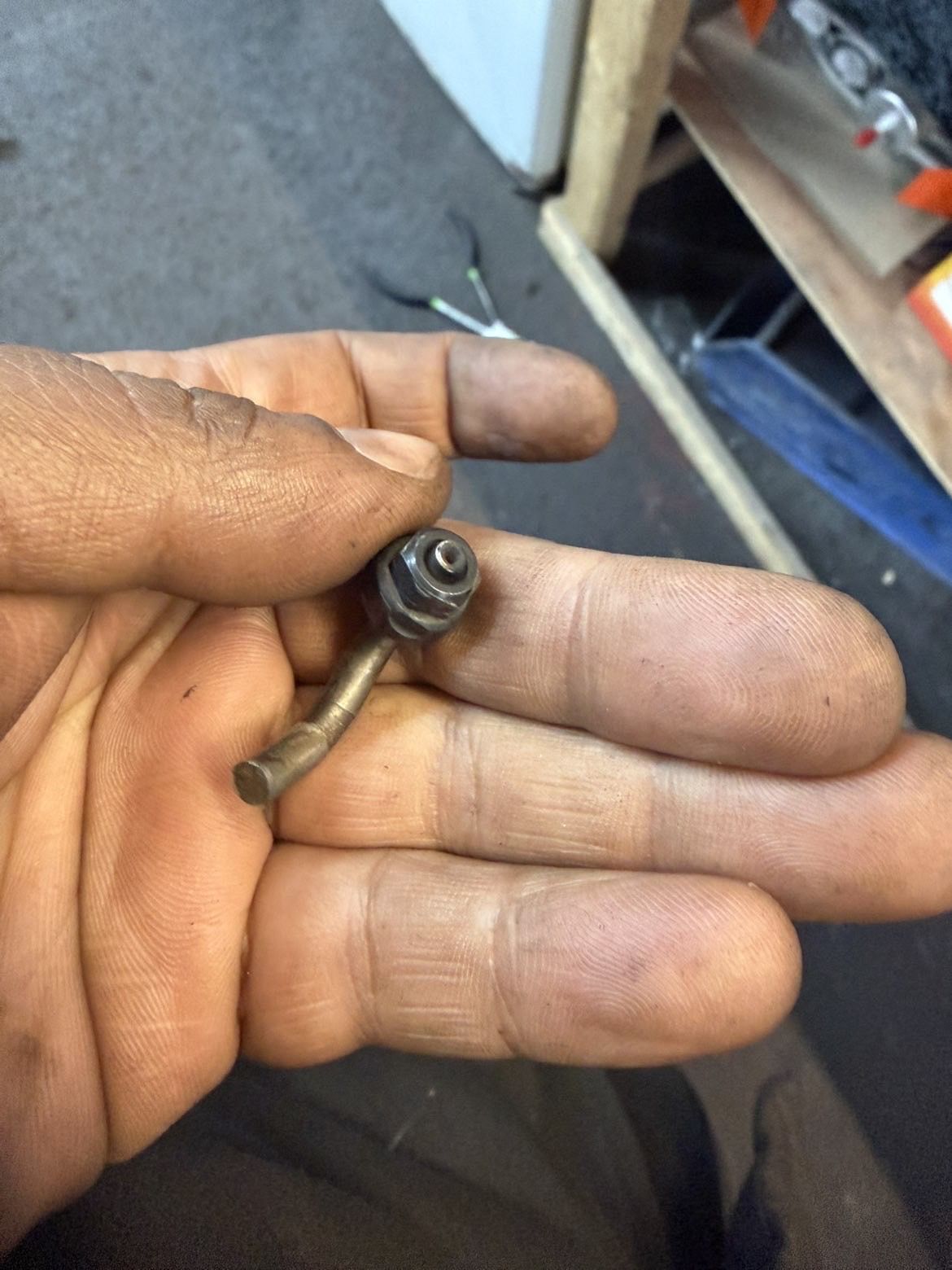

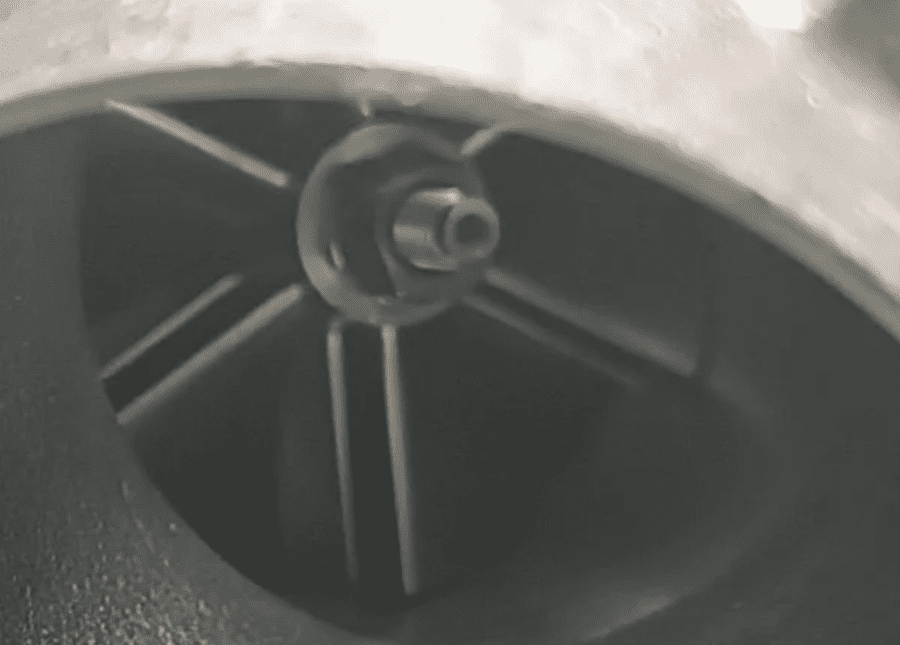

On inspection after removing the air box he noticed something rattling inside airbox to find small metal object. Shown on first image. (LATER IMAGES SENT TO A MOBILE MECHANIC CONFIRMED ITS PART OF THE TURBO) after took off turbo elbow to see the catastrophic damage to the turbocharger. Engine does not turn over. Anyone can help please feel free to message to recommend a turbo specialist garage as everyone in my area who does the jobs are way too busy and won’t take on the job. HOPEFULLY MY ENGINE IS NOT DAMAGED

Looks like the turbo has 'eaten' itself! That metal piece is the nut/shaft that used to hold the compressor wheel in place!

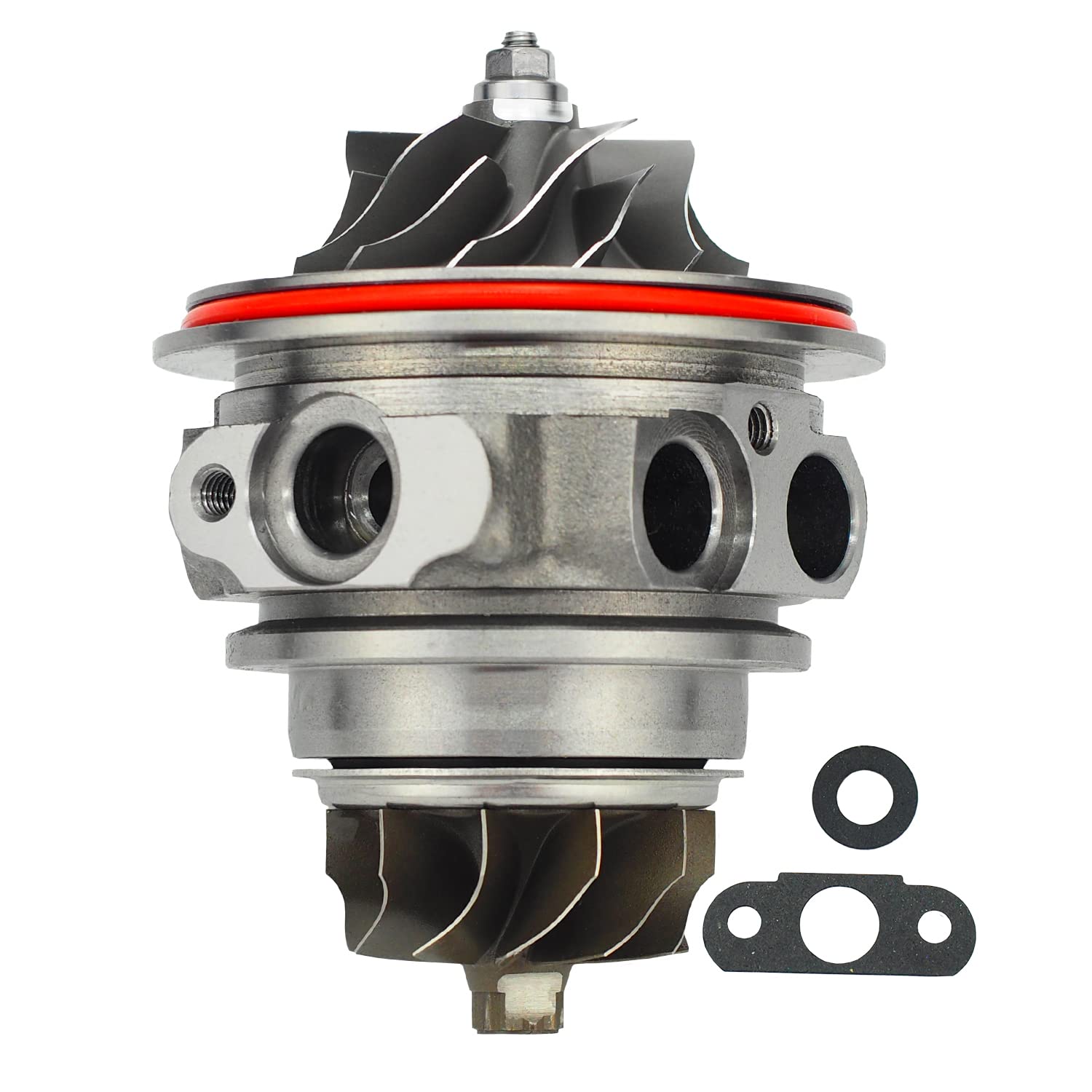

This is a new turbo compressor & nut:

Engine lockup is not a good sign. There might be a chance that a big chunk of the turbo has filled a cilinder(s), which results in the piston not being to able to reach top dead center (?)
One of the pictures only shows the intake side, I'm wondering how the exhaust side looks like. The first 2 pictures show the shaft, that should be straight :unsure:
