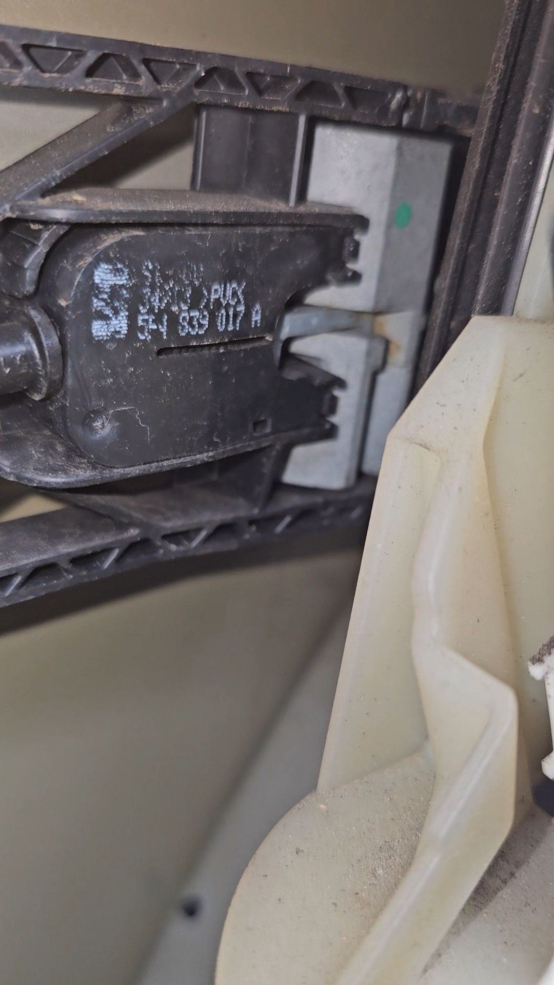

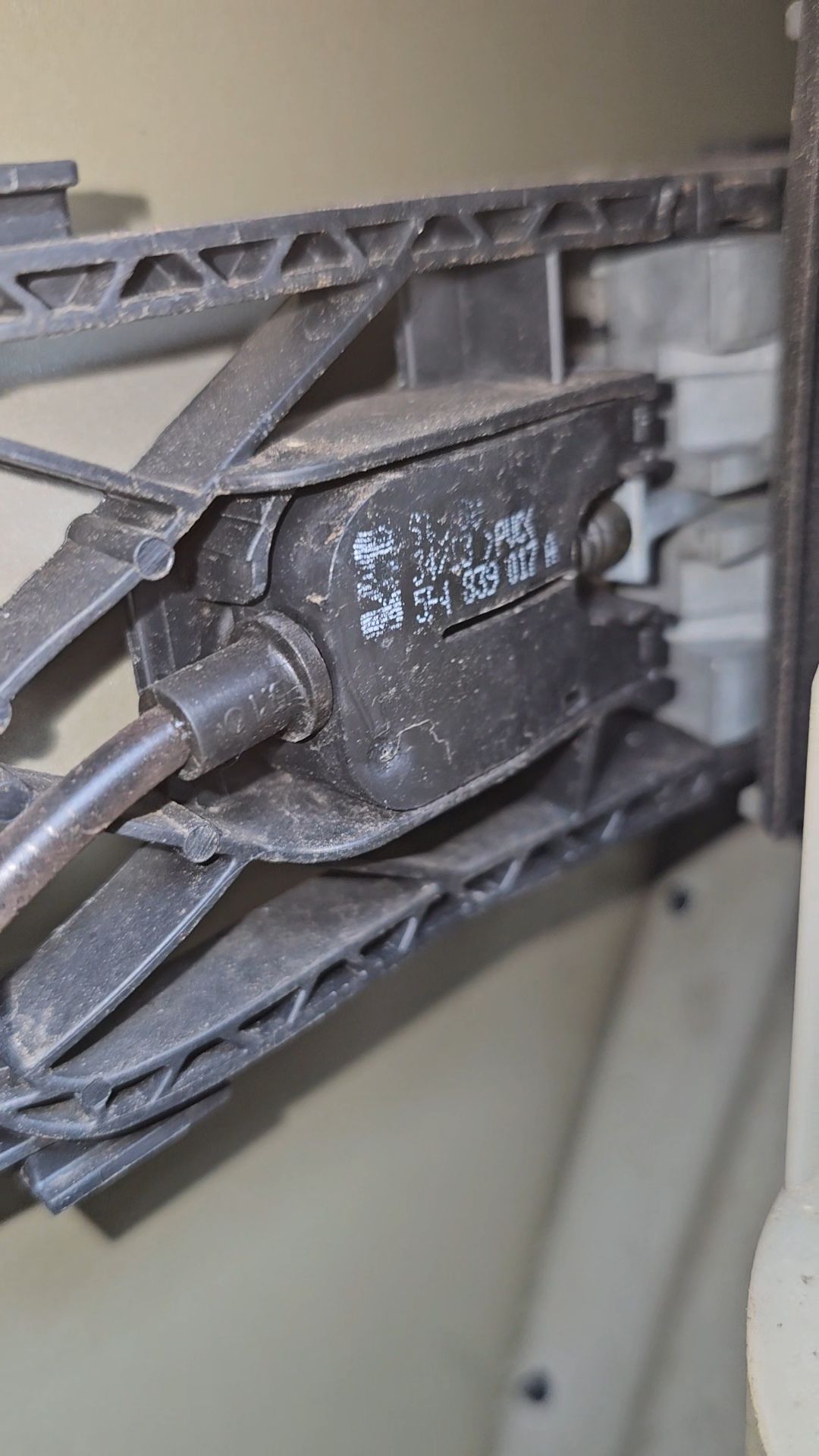

I also have another issue... my rear driver side door doesn't open from the outside but it opens from the inside. I can hear the locking mechanism fine when I lock the car. I took the door panel off to have a look. The handle seems like its pulling fine (see picture, exterior door handle is pulled when this picture was taken) but it just won't open?

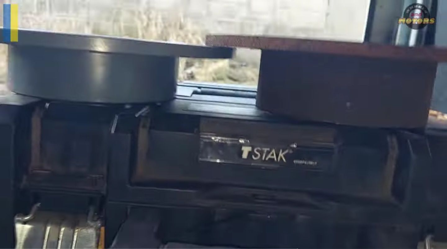

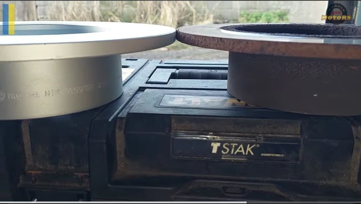

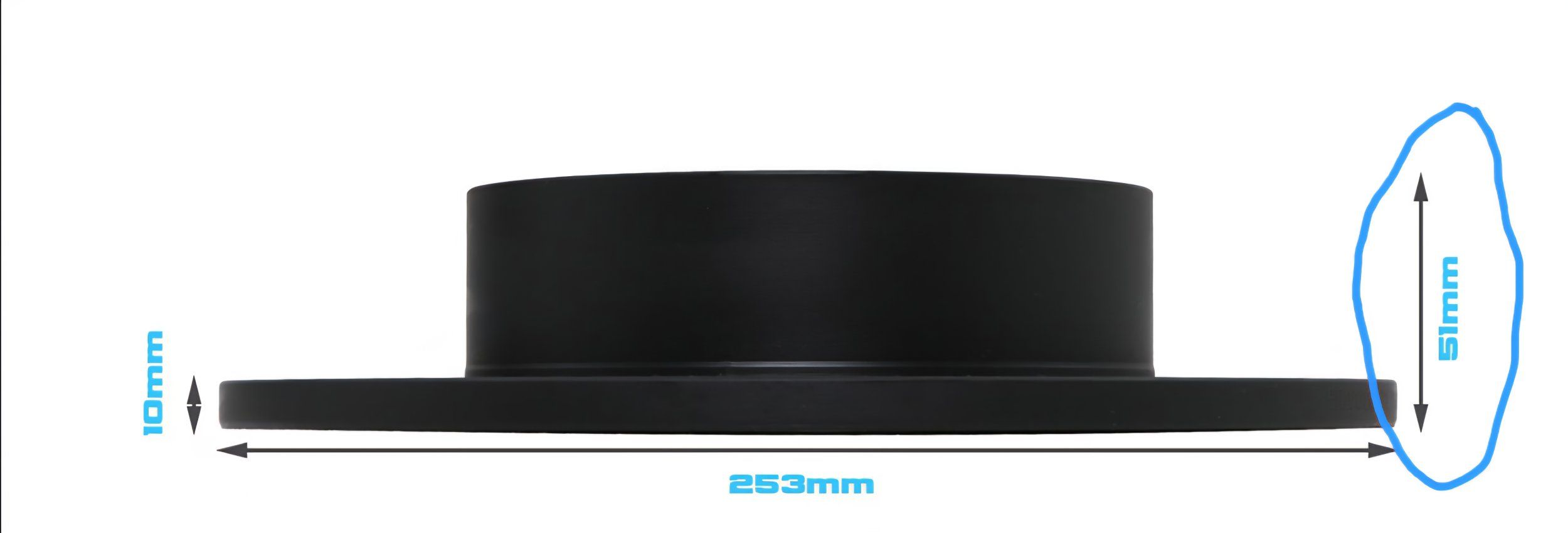

Sorry if I'm being confusing. Hopefully the attached images help. This is what I mean by height/depth.

Not sure what you mean by "height", but there are only two relevant size properties of a disc: diameter and thickness, like 253x22, both in millimeters.
The height - is the total disc height, as published by some aftermarket parts.
The 22 in the 253x22 is the disc thickness.
The 253 and 272 diameter versions do have different heights.
Looking at a 2014 leon i'm sure your rear disc will be:
5Q0615601F = 253X10MM 5/112
As it was only the 180tsi and 184tdi to get the 272 rear disc.

There are different versions (heights) of the 253mm disc depending on VAG model - so make sure your disc matches the OE number I shared.

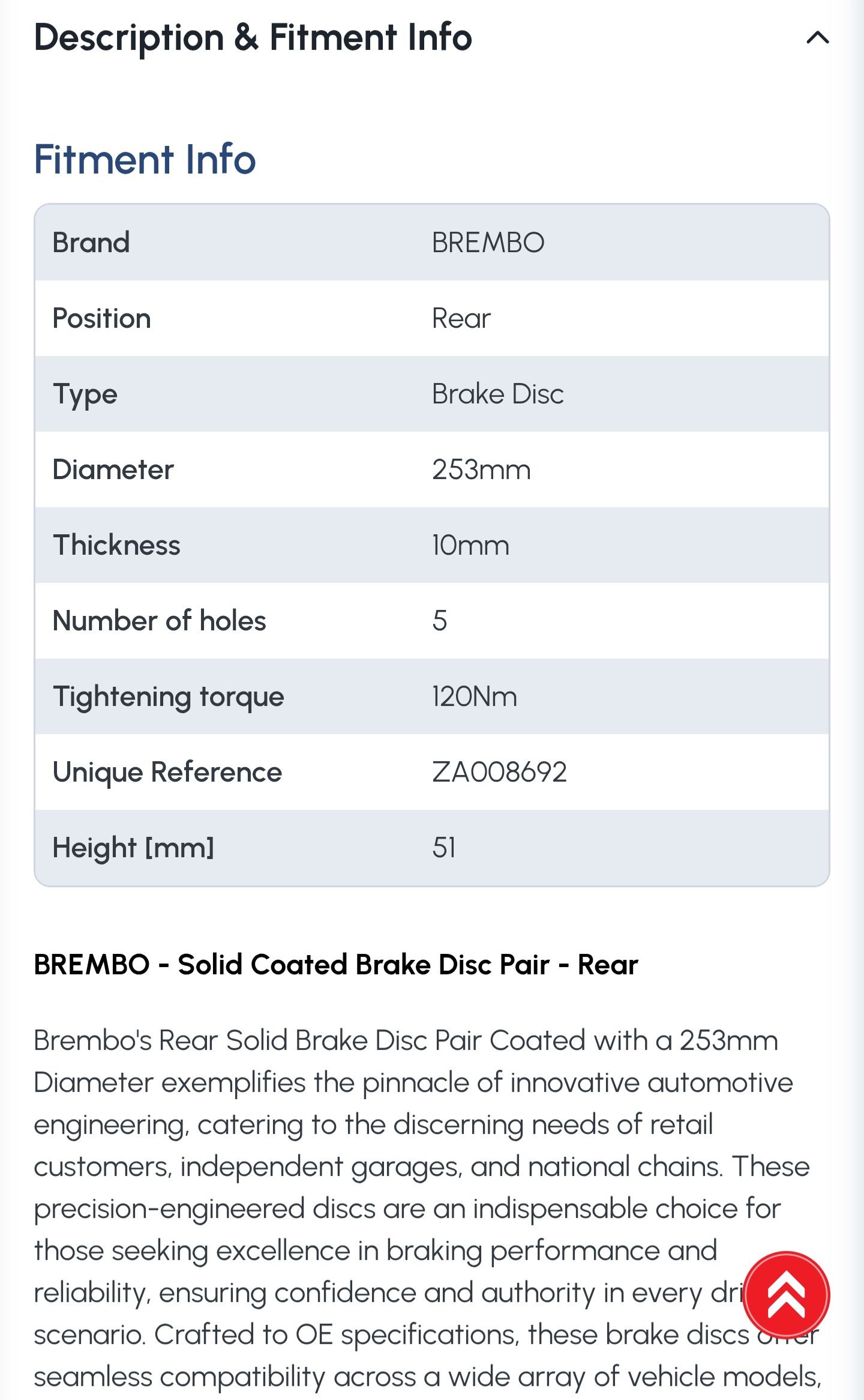

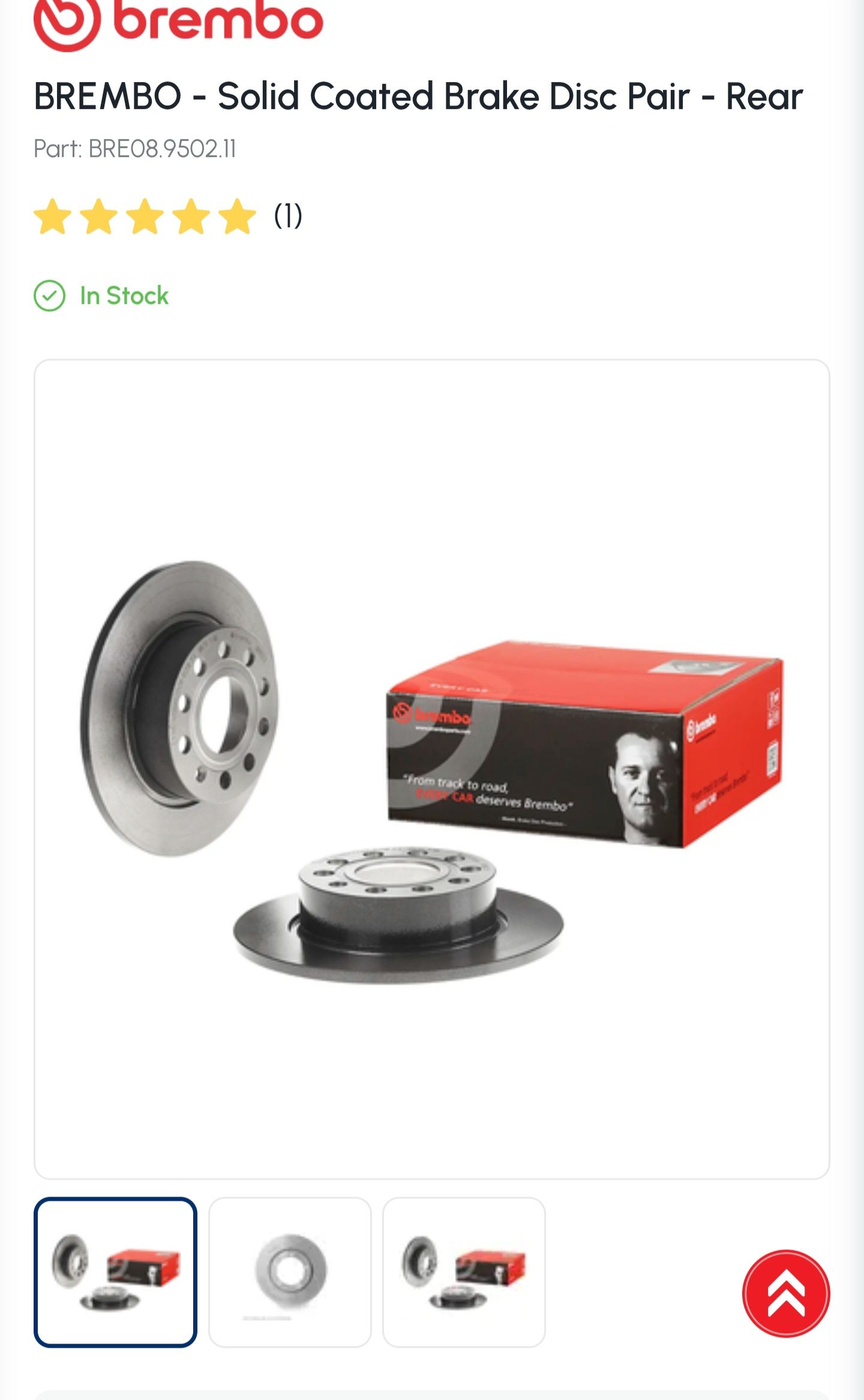

Thank you, lots of helpful information! These are the brakes I have purchased.
Reactions: SuperV8

Official parts catalog doesn't give any info about the height, just because it gives the exact part number and the PR codes, so as long as the part number matches, height info is not needed, I believe. I always love to have extra data but in this case it seems only to add to the confusion.

Yeah sorry to be confusing. Ive attached screenshots of the discs ive ordered. Looks to be the right ones hopefully (used the numberplate search on GSF, the website also says it IS compatible with my car)
@SuperV8 already gave the information but I checked anyway using your VIN and as he said it is 253x10 and part number is 5Q0615601F.
Your rear brake system PR code is 1KD, in case that info is included on the aftermarket parts sites you're looking at.
Disks are packaged as single units so you'll need two.
You had also asked about the pads; the part number is 5Q0698451M, it comes as a set of two, so you'll need to order just one.

Perfect! Problem solved :) all matches up.
1KD = 253X10 and 51mm height. Thank you!
Already have both discs and pads (discs came as a pair).
Thank you very much to the both of you 😊
